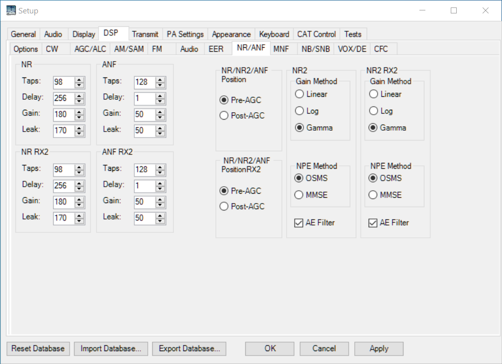

Posts: 721
Re: Noise Burst on initial transmit
I get virtually the same results when using NR2, here's my settings:
DSP NR-ANF.PNG (165.78 KiB) Viewed 19835 times

Posts: 202
Location: Apeldoorn, NLD
Post by PD3LK »
Hi, fwiw the only way i can reproduce that sound is to uncheck AE Filter.
rbduck
Posts: 350
Post by rbduck »
w-u-2-o wrote:You don't need the noise blanker turned on based on what your panadapter looks like.
However, regardless of that, I'm unable to duplicate that very weird audio sound even with settings identical to yours.
I'm assuming you have the default settings in place for NR2?
Please post your RX EQ so I can duplicate that as well.
PD3LK wrote:Hi, fwiw the only way i can reproduce that sound is to uncheck AE Filter.
PD3LK nailed it. When I checked the AE filter that weird ethereal noise disappeared. I don't remember unchecking that at all . As far as I know
everything on that page was set to default values. Nonetheless, I may have unchecked it by accident. (The cat did it). It must have been long ago because NR2 has sounded like that as long as I can remember. What is the AE filter?
Edit: Also ,when it's quiet, I don't run the receive equalizer. Voices sound more natural that way. When it's noisy I run it to get understandability above the noise. That probably has to do with the minor hearing loss I have.
I don't run any noise reduction if the band is relatively quiet. It was very quiet yesterday. Thanks again.

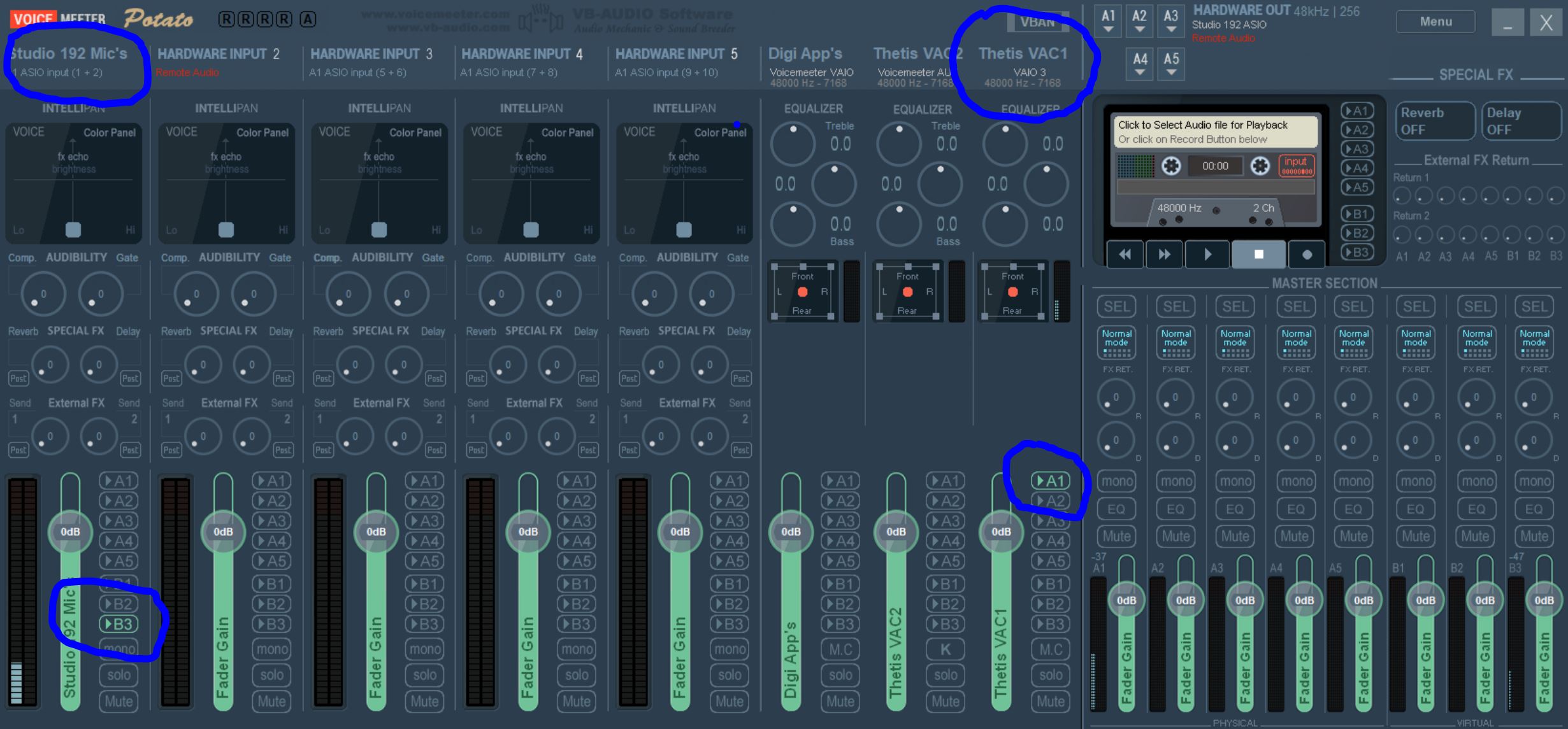

I am not sure this is the proper place for this but here is the problem that I have.
The radio is a 7000 with protocall 1 and running Thetis. When selecting transmit or tune there is a strong burst of noise like band noise for about a half a second on the transmit signal. I first discovered it running WSJTX. I turned of WSJTX and it was still there. I can get it to go away by turning of VAC but then no audio.
I get the noise when MOX is selected as well but no carrier as there is in tune. Disconnecting the mike makes no difference. I am using the mike input on the front of the radio and the speaker jack on the rear of the radio.
If I check "allow mox to override/bypass vac for phone" that eliminates the noise burst when keying the radio by MOX or tune. This is with the radio in SSB mode. However when going to USBDIG mode the noise is back. Seems anytime you are in the digi mode with audio coming from WSJT the noise burst is there. Actually the noise is still there even if I shut down WSJT.
I have voicemeter virtual audio connections. By the way voicemeter Banana or voicemeter potato will not load. Banana did work at one time until I installed potato, then neither will load. Did the de-install and reinstall and no help.
The virtual audio cables still do work though.
Any ideas?
Gary K4FMX

k4fmx
Posts: 10
Joined: Sun Feb 28, 2021 3:23 am
Post by k4fmx »
Hi guys, thanks for the info.
I still have the problem.
I uninstalled voicemeter and reinstalled yet again. It now loads ok and I can select different options. But I can not get any audio into WSJT thru voicemeter. As soon as I shut down voicemeter the audio goes to WSJT and it works.
WSJT also works on TX but I still get the inital noise burst when it keys up. The noise is the band noise with WSJT receive signals that lasts about a half second.
It is not being picked up by the mike as I can unplug the mike and no difference in the noise.
I can also shut down WSJT and I still get the noise burst (just band noise no signals) on keyup via MOX, This is of course with the boxes unchecked that mute the audio in SSB mode. Radio in usbdig mode.
It seems the noise is coming from the voicemeter virtual cable program as that is the only thing feeding vac at the time. That or it is in the vac chain?
Thanks for the help

I found the noise burst problem.
I had thetis and wsjt connected to the same vaio input. I now have the vaio in and out connected to thetis and wsjt connected to voicemeter aux in and out as follows:
Thetis setup:
Driver- MME
Input- voicemeter output
Output- voicemeter input
Wsjt setup:
Input- voicemeter AUX output
Output- voicemeter AUX input
If a mike is used on the PC it gets connected to the first hardware input and B1 button is selected to send it to thetis.
Buttons selected on virtual section: Vaio-(B1)
A1, B1, B2
Virtual Aux (b2) buttons
B1
When using wsjt there is feedback from the mike circuit that caused the noise burst. So if the B1 button is disabled on first virtual channel (B1), that will kill the noise on wsjt keyup. B1 button here is bringing mike audio into thetis.
The noise burst is from a buffer emptying out and not just audio picked up from the mike.
The noise burst can be seen when selecting MOX on the radio, same as when it goes into TX from wsjt.
You must reselect the B1 button when going back to SSB for mike audio from the PC.
You are right Scott, the designations in voicemter are terrible!

k4fmx wrote:I found the noise burst problem.
Good to read. I had suspected it was a Voicemeeter configuration problem.
That B1 send is not the send you need to get mic audio into Thetis. You need to enable the B1 send on hardware input #1, and you already said you did that. If you are looking to get audio from a mic that is plugged into the ANAN, you'll need to use one of the "override" options in the Thetis VAC setup.

"That B1 send is not the send you need to get mic audio into Thetis. You need to enable the B1 send on hardware input #1, and you already said you did that. If you are looking to get audio from a mic that is plugged into the ANAN, you'll need to use one of the "override" options in the Thetis VAC setup."
Yes i do have the B! send button selected on the first hardware 1 input to get PC mike audio to thetis. i also have to select B1 send button on the virtual channel to get the mike audio into thetis. But when it is selected here it causes the noise on wsjt. Disabling B1 send button on vertial channel 1 kills the noise.
I understand about the override option when plugging a mike directly into the Anan.
Gary K4FMX
Posts: 6024
k4fmx wrote:i also have to select B1 send button on the virtual channel to get the mike audio into thetis. But when it is selected here it causes the noise on wsjt. Disabling B1 send button on vertial channel 1 kills the noise.
You do not, repeat NOT, need the B1 send button activated on the Thetis virtual channel assigned to Thetis to get microphone audio in.
If you cannot get microphone audio into Thetis without the B1 send on the Thetis virtual channel activated then you are doing something wrong.
I took my (rather complex) Voicemeeter setup and stripped it down to to its barest essentials to prove it works. I can make a video if you like to further prove it.
Assuming your microphone is on hardware input 1, and your speakers are on hardware output A1, for phone:
1. On hardware input 1 channel you need ONLY the SINGLE Bx send activated, where "x" is 1, 2 or 3, depending on which virtual channel Thetis VAC1 is assigned to.
2. On the virtual channel assigned to Thetis you need ONLY the A1 send activated to send audio to the A1 hardware output.
That's it.
You should never, EVER activate a send that is the same as the channel it is on UNLESS you are using the Patch Inserts/Voicemeeter Insert Virtual ASIO to loop audio out to and back from a DAW or other VST host.
This works perfectly for phone. It is all you need for phone. If this is not working for you then you have done something else wrong. Please excuse the fact that I have Thetis on B3 instead of B1, but I really didn't want to change my channel assignments as well for this example.
k4fmx
Posts: 10
Post by k4fmx »
Hi Scott, thanks for your help. I think that I have it figured out now. The problem was that I had 2 mikes, one on the computer and another plugged Into the radio directly. Switching back and forth caused confusion on my part. The radio mike would not work unless the B1 on the first virtual channel (thetis) was active. This also coupled the noise burst on key-up.
I discovered in the thetis manual that you have to turn off VAC1 when using the mike on the radio. Also the B1 should not be active (ever) on the first virtual channel as you have said.
I now have B1 active on the first hardware channel for the computer mike when used and VAC1 on.
I have thetis on the first virtual channel with A1 active to send receive audio to the A1 hardware output for the speakers.
and B2 active on that channel to send receive audio to WSJT input.
WSJT is on the second virtual channel with B1 active there to send audio out to thetis from WSJT.
Every thing seems to work fine and there is no longer any noise burst when using WSJT on keyup.
I do need to disable the computer mike when using WSJT.
Gary K4FMX
Posts: 6024
k4fmx wrote:I discovered in the thetis manual that you have to turn off VAC1 when using the mike on the radio.
The manual is not 100% correct. That is what the "override/bypass" controls are for. You can leave VAC enabled, using the computer mic, and if you want to use the mic attached to the ANAN simply make sure that the override option of choice is checked and use that specific PTT method to activate it.
Using that approach, or just turning off VAC, the B1 send on the first virtual channel is NEVER required.
Of course you do. Glad to see you are getting the hang of it. If you buy a fancy PC audio interface like a Behringer UMC202 (or Steinberg, or Focusrite, or M-Audio, or Presonus) you can plug a full-on professional mic right into it and just switch over to that in Voicemeeter.
