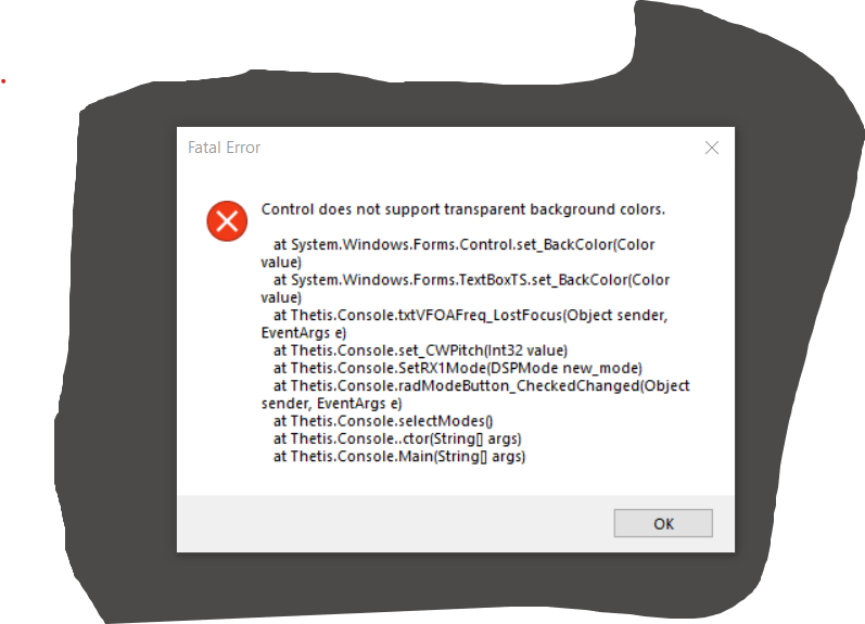

Hello All,
I think I erred by downloading and installing the latest Thetis Beta release. I am referring to version 2.6.9.0. Whatever I did during the installation has backfired. I am locked out of the program (i.e., can't open Thetis) with the error message attached below. Any help getting in and functioning again would be greatly appreciated. I am not a very knowledgeable computer ham. I don't know if others feel as dumb as I do with a post like this. I confess I have so many things I want to learn and that I study. Being a computer specialist wasn't on the list. So it is always a process to post a self-induced problem. I am not sure if others have mentioned how hard it can be to ask for help and be so helpless. The Group has been gracious in the past but still. . . Anyway, the "fatal error" message is attached. I don't know what casting is in this context?
I don't seem to be able to find a prior version of Thetis to load. My original DLE 7000 MKII came fully loaded so I haven't had to use bootlegger or put in Thetis from scratch. I have installed prior upgrades without a hitch.
Thank for your help and suggestions.
phil, NE0S

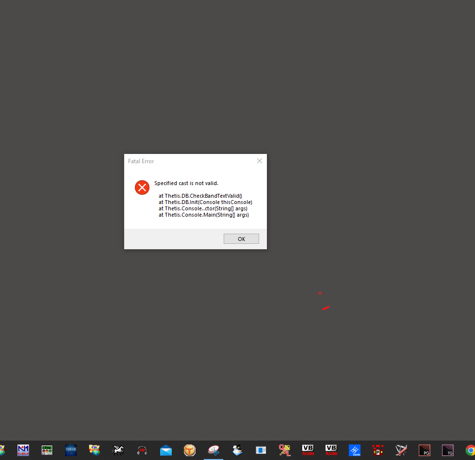

phil, NE0S
- Thetis fatal error message.png (57.78 KiB) Viewed 14173 times
- cast not valid snipt 2022-07-22 005635.png (18.79 KiB) Viewed 14173 times

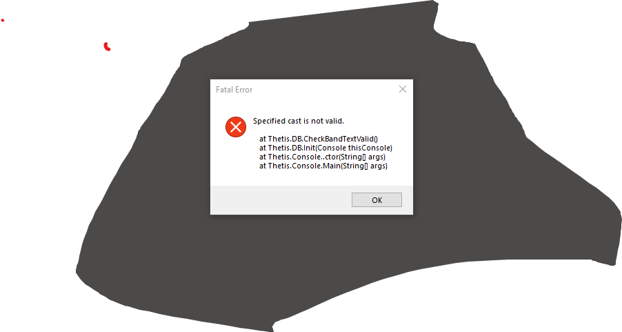

Sorry for the delay in the response. I wanted to have time to follow your suggestions.Thank you for your reply. Since you are the only person that gave me a path I am doubly grateful.
I followed your directions and did the re-install. The attached file is the current error message. I saw a message like this a year and a half ago after making changes to the appearance of the program. I did a re-install then and it seemed to be a nonissue. Is it possible that there is a command string from that time that is causing this problem? I hope that you have another possible fix for me. This is getting frustrating. I really want to get back on the air. I am sorry to take more of your time.
phil,NE0S
phil,NE0S
- Screenshot 2022-07-27 191930.png (107.29 KiB) Viewed 13949 times

Re: Fatal error message, bricked.
the error message has nothing to do with firmware version. There is something wrong in windows.
Setting transparent background is done for tons of controls during Thetis startup.
Either a missing update or some weird windows stuff is going on. I guess Richie could point in the right direction.
https://www.oe3ide.com
It looks like your installed version of DirectX, and/or your installed video driver, is incompatible with the DirectX code in Thetis 2.9.0.6.
How old is your PC? What video interface does it use? What version of DirectX are you running (use this link to find out).
You can try to update those things, or you can downgrade to an older version of Thetis.
Older versions are available here: https://github.com/TAPR/OpenHPSDR-Thetis

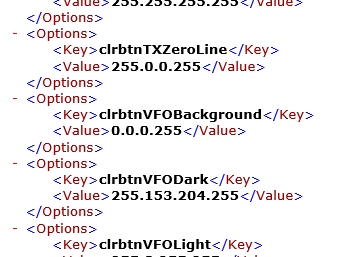

check in database.xml that the following is set, and that there is only one entry for clrbtnVFOBackground
<Options>
<Key>clrbtnVFOBackground</Key>
<Value>0.0.0.255</Value>
</Options>
<Options>
</Options>

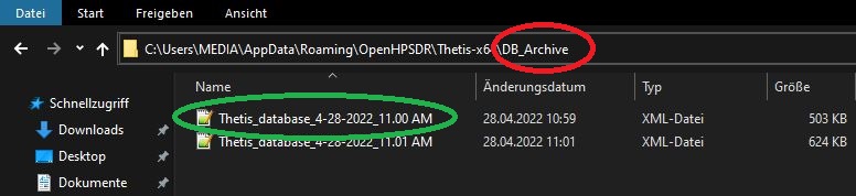

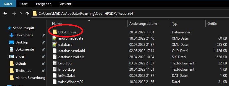

Hi Phil,
too bad you don't trust yourself with this simple operation.
It really isn't rocket science.
Since you were already able to locate the Database.xml, it is easy to check in the same directory whether a subdirectory called DB_Archive exists.
If there is a DB_Archive directory and you can find it, then half the battle is already paid.
Should look like this. Individual directory names can be different.
Rename your old non working database.xml to something else. (database.xml.old in my case)
Change to DB_Archive and copy a older Thetis_database_xxxx file to your overlying Thetis directory. (this is where database.xml sits)
Rename your just copied Thetis_database_xxxx file to database.xml
Now you are done, and your Thetis should be fine. Hopefully
