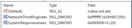

After updating two PCs to the latest Windows 11 ver. 22H2 my Network Throttling hacks were reverted back to its defaults on both machines.
So please, after updating your computers to W11 22H2, check the registry and confirm your settings.

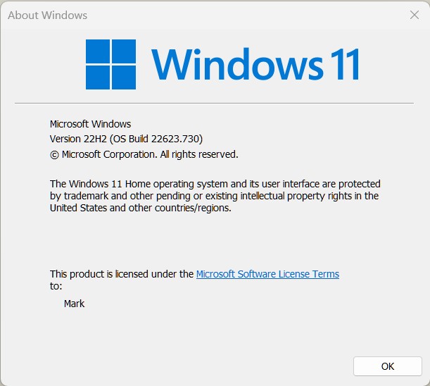

I'm on W11 22H2 Insider Preview Build 22623.730 and my setting hasn't changed:

Jordi--does the built in settings feature for this in Thetis no longer work for you?

w-u-2-o wrote:Jordi--does the built in settings feature for this in Thetis no longer work for you?
I don't know, I don't run Thetis in administrative mode.
I always check the hack after every "big" Windows update.

Windows update reset the throttling index here as well, the builtin setting feature took care off it.
