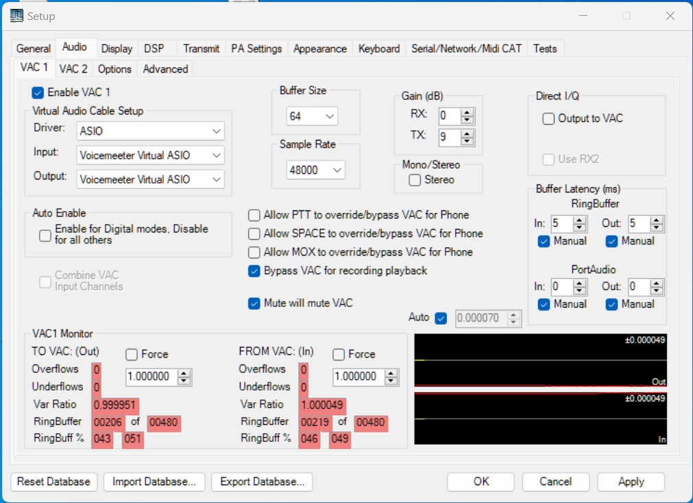

Here are my Thetis settings. This instance has been running for an hour or so and has settlled down nicely after the first five minute of thrashing.

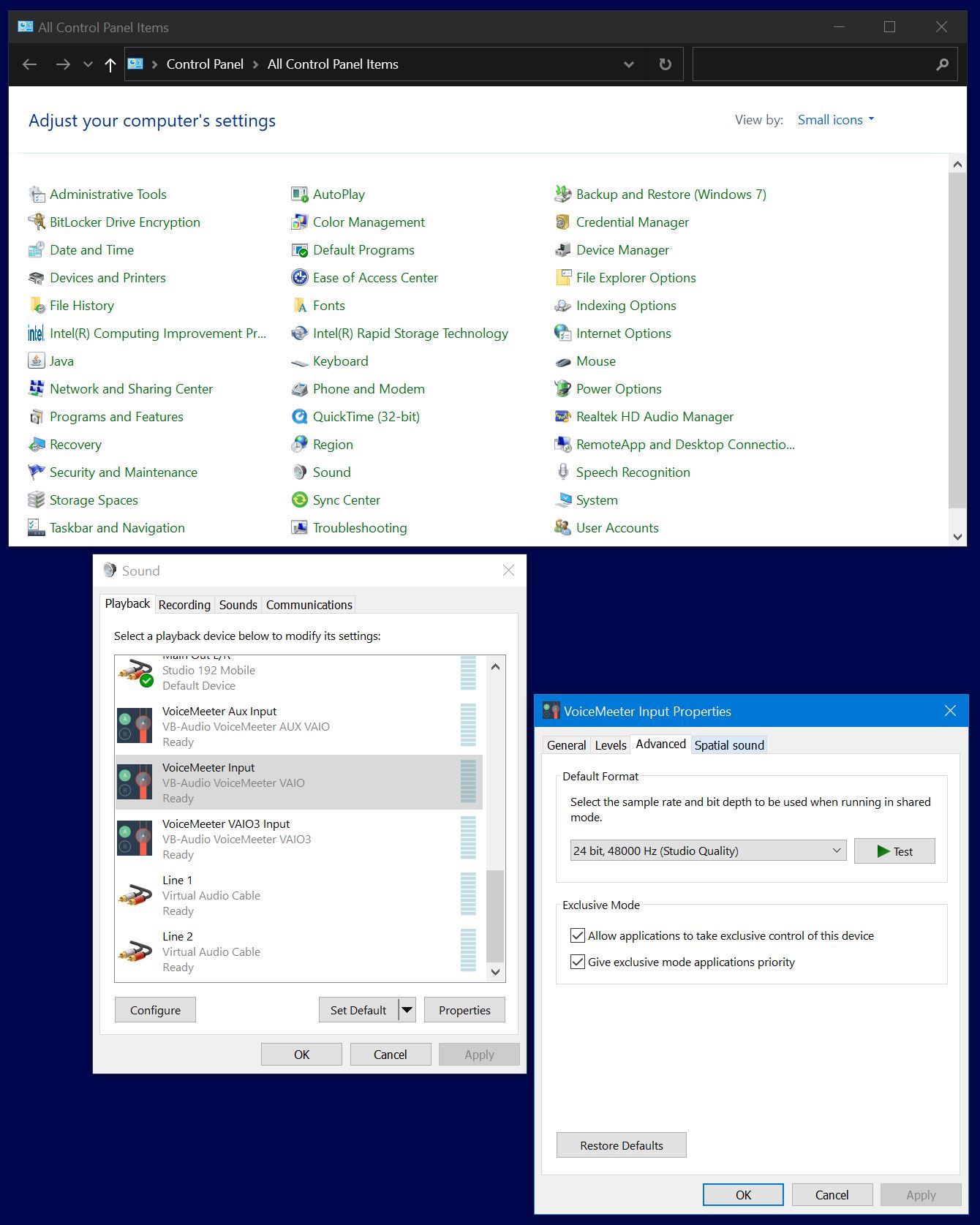

Scott - regarding your question, "Why are you not routing the Thetis virtual channel to both the WSJT-X and Map65 channels?" Map65 gets its I/Q feed from a UADC4 via Linrad and the network.

KC2RGW... could you elaborate a bit on "Also double check Control Panel and set all the busses to 48k 24 bit if you haven’t." I'm not especially fluent with Voicemeeter.
Michael
Michael
Re: VAC & ASIO Under/Overflows
I don't see any problem with your buffer or rate settings in VAC or Voicemeeter. I'd turn on stereo in VAC, but that's just a minor issue, not related to your problem. As soon as I get my data collected in the morning I will post my VAC Advanced settings which are somewhat different than yours. And you are also not using Force like I am.
As for the "Control Panel" reference I believe he is referring to the legacy Windows Sound Control Panel, and he is correct, you do need to go there, find every single Voicemeeter related device both for playback and recording, and ensure that they are set to 48KHz, stereo if possible. 16 or 24 bit doesn't matter so much, but I also use 24 bit.
Here's an example:
Here's an example:
Scott - Thanks for explaining. I wasn't sure which control panel was intended. I had set everything to 16-bit/48000 long ago as per your tutorial.

In the Thetis audio tab, you have your buffers on manual and 0. I just let mine do the automatic thing, my system would never work at 0ms forced.
I'll screen shot mine when I get to my desk again.

I'm not forcing the buffers into manual and the Advanced tab in Thetis is set to defaults. This has been very stable for me with Voicemeeter for a good run now.

As promised, here is an example of the performance I am getting. The key differences between my setup are:
1. I am using the forced checkbox. This should make any changes on the advanced tab immaterial, but I have included my advanced settings that I developed during experimentation, as documented in that other long topic about these settings, just for completeness.
2. I am using a direct connection, PC to ANAN, on a dedicated NIC, no switches. This should improve UDP packet loss rates.
3. Over many days of testing I have found that I need a slight increase in the input Ringbuffer over 0 to be stable.
Things to consider:
a) Try the force checkbox option. This should work if everything is locked to a GPSDO.
b) Try increasing Ringbuffer sizes (PortAudio can remain at zero since you are using ASIO).
c) Do the experiments I previously recommended to measure UDP packet loss rates (move the PC next to the Angelia, or do an iPerf test).
