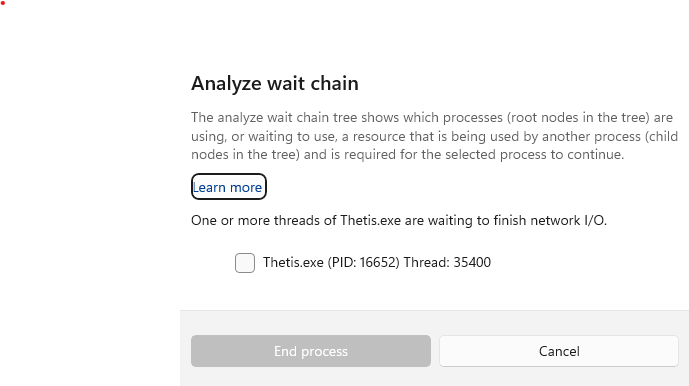

In the task manager... click details on left (vs Processes) then look for thetis.exe and right click and pick the "Analyze Wait Chain" option. See what is still pending after you shut it down. Just a pointer and not a solution here... :-) Good luck Oliver.

Interestingly enough. I now see this problem on my end too... wondering if this happens on subsequent shutdowns or if it is timing related... I did the procedure above and see this, but not sure there is a smoking gun here...
https://learn.microsoft.com/en-us/windo ... -traversal

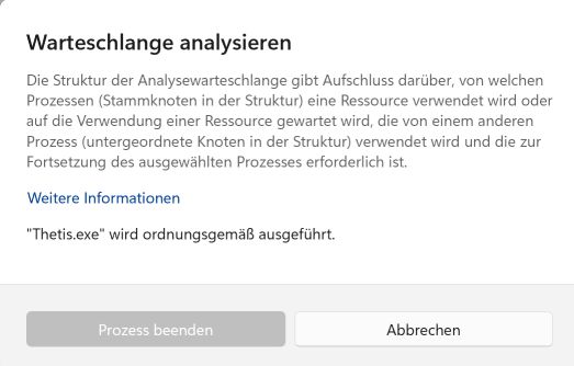

Look at my funny screenshot. App is closed on Desktop but NOT in Task Manager.:
In English: "Thetis.exe is running correctly" :lol:

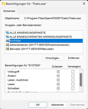

Actually, one idea: what happens if you run Thetis as administrator? Change the properties of the Thetis .exe, or change the properties of the shortcut you use to launch Thetis.
My standard user has admin rights, THETIS.EXE and the file/directory also got full read/write right's.
Maybe I'm completely wrong, but rights work, or they don't. It works sporadically. Sometimes after 5, after 10 attempts. Sometimes it doesn't work for a whole week.
