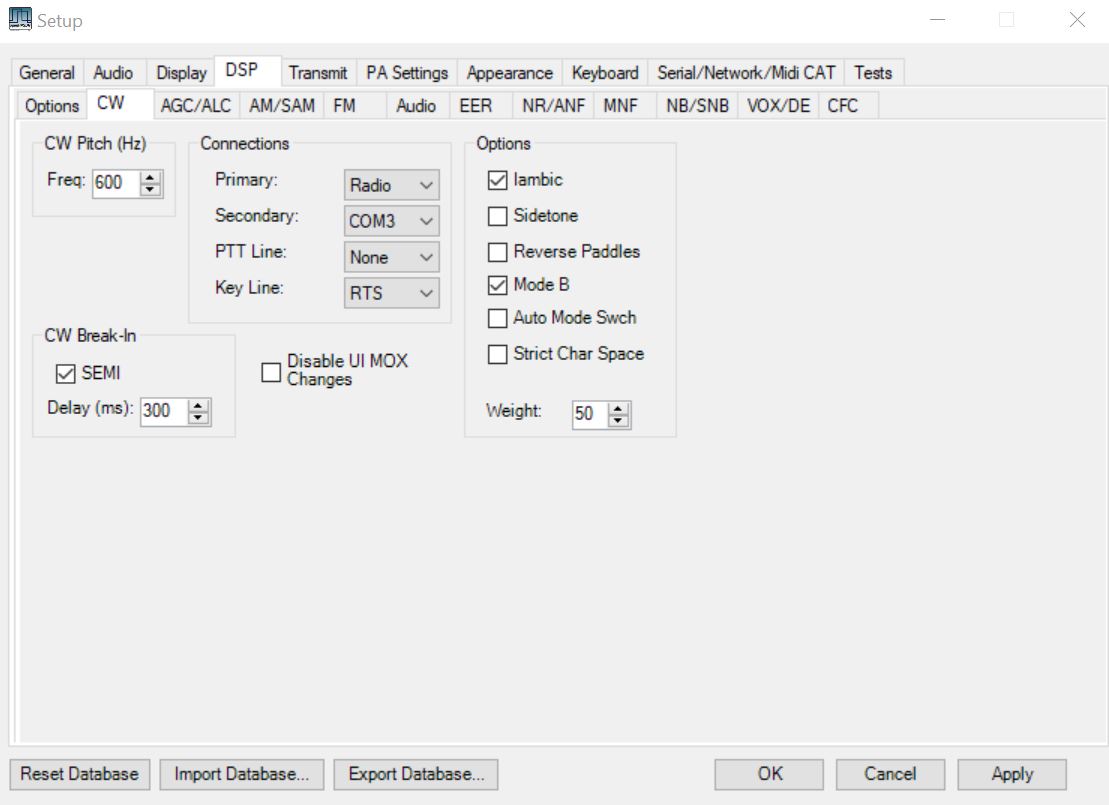

Within the realm of openHPSDR, Thetis comprises the bulk of the radio. What comes out of the hardware is a 1st (and only) IF.
HL2 is a great value, and together with Thetis provides impressive performance. Consider that if you are happy and impressed with HL2, which only has a 12-bit ADC, imagine how much more impressed you'd be with a 14 or 16-bit ADC on the receiver, which you can get with even the oldest Apache hardware.
That keyer should work well. Provision a serial port (use a USB adapter if necessary) on your PC. Set it up as pictured below. Simply have the keyer short the COM port DE9 pins 7 and 8 when asserting key down.
