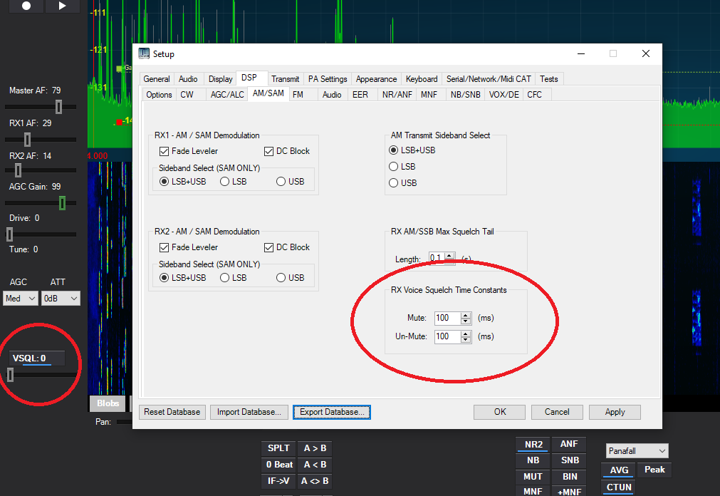

va7qi wrote: The Mode dependent display is just a black frame. As well, there is no way to set up voice squelch that I can see.
I wrote something about that here. https://github.com/ramdor/Thetis/issues/145
You can cycle the squelch type by left clicking on the squelch button and set it up by right clicking the squelch button.
va7qi
Posts: 144
Location: Quadra Island, BC
Re: Thetis 2.10.0 Released (G2 users take note!)
Post by va7qi »
Thanks, but my point is: there is no squelch button in Andromeda. ,,,,Erik.
DH1KLM
Posts: 222
Location: Germany
Post by DH1KLM »
Erik,
You are right. I never thought about this.
