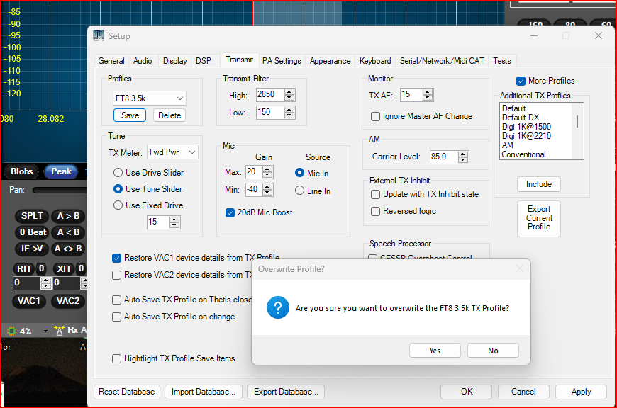

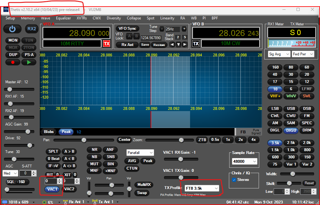

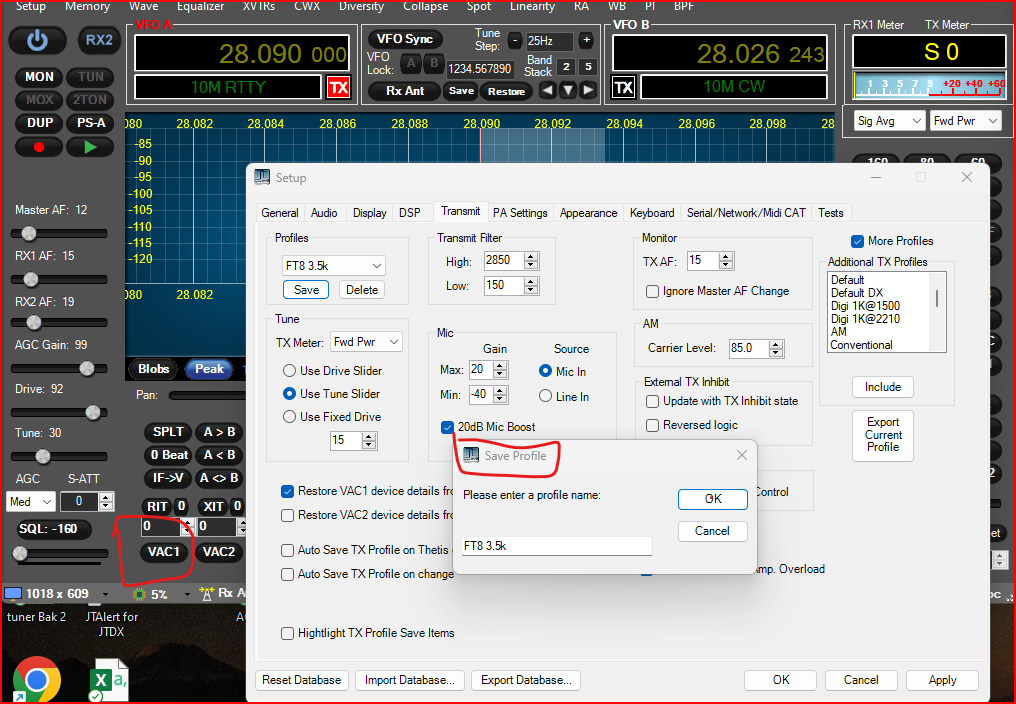

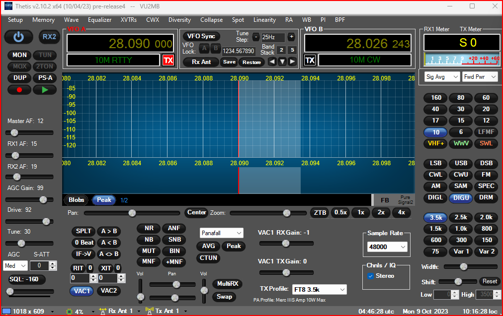

Here situation remains the same and my PC still do not register the changes
despite asking to save and overwrite the TX profile.
and new changes are not stored.
I know it should not happen as others have reported that their issue is now resolved.
if you need I can post a video. Pictures are attached below for the process I have adopted.
Last picture is after restarting the Thetis.
Thank you
Bhanu

Posts: 1587
Re: Thetis v2.10.2 pre-release
vu2mb wrote:if you need I can post a video
yes please, and send me a copy of your database.xml and ErrorLog.txt from inside C:\Users\<user>\AppData\Roaming\OpenHPSDR\Thetis-x64
Do not use DB export button, just shut Thetis down, and send me the files from the location above. Email over on qrz.

Posts: 1587
Resolved via email, but after some head scratching, the VAC was turning back on, even though the profile was stored with it off, because of the 'Auto Enable' setting 'Enabled for digital modes, disable for all others'. As a side note, this setting is actually stored against the profile as well. Confusing all around :)
