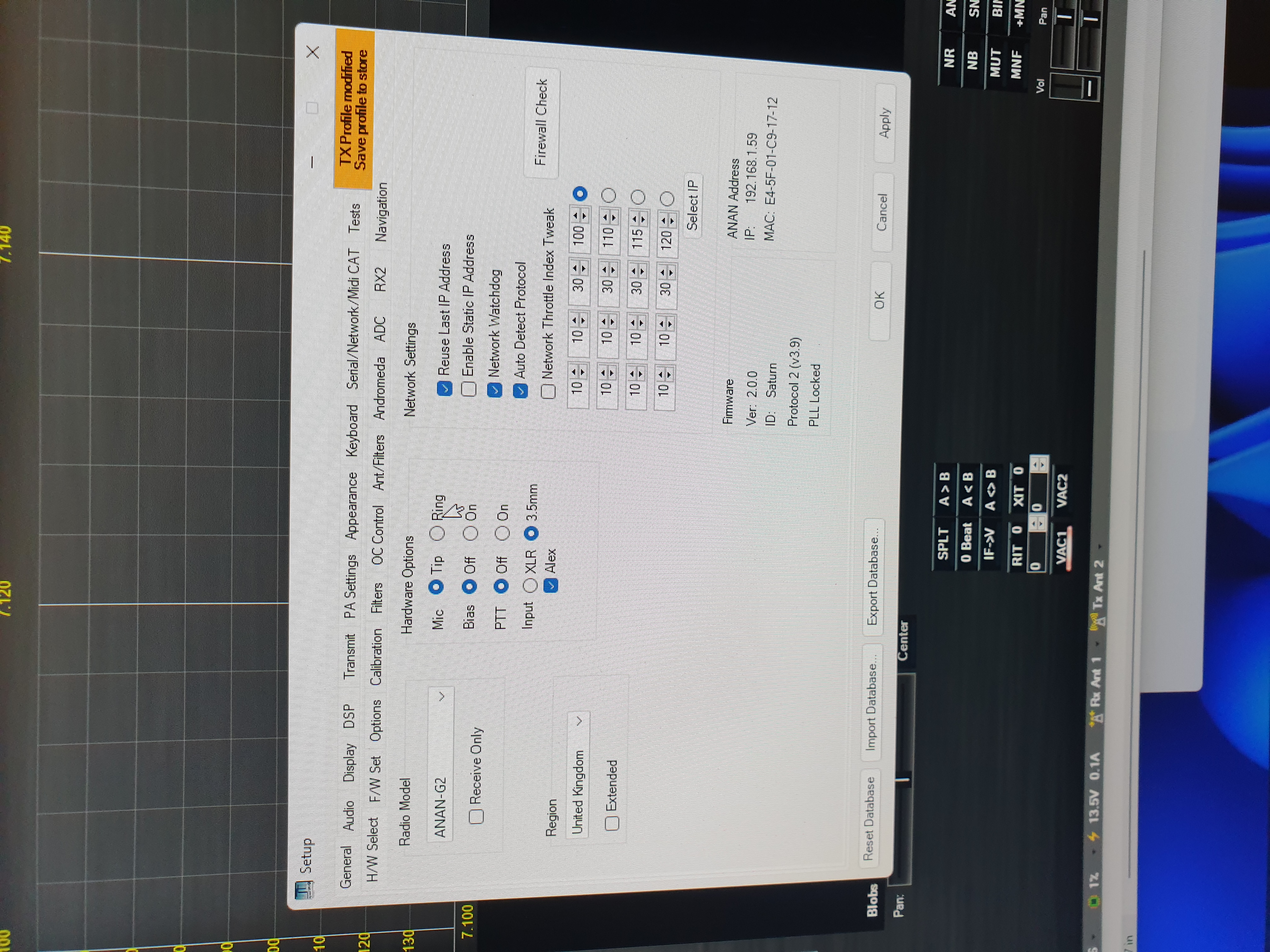

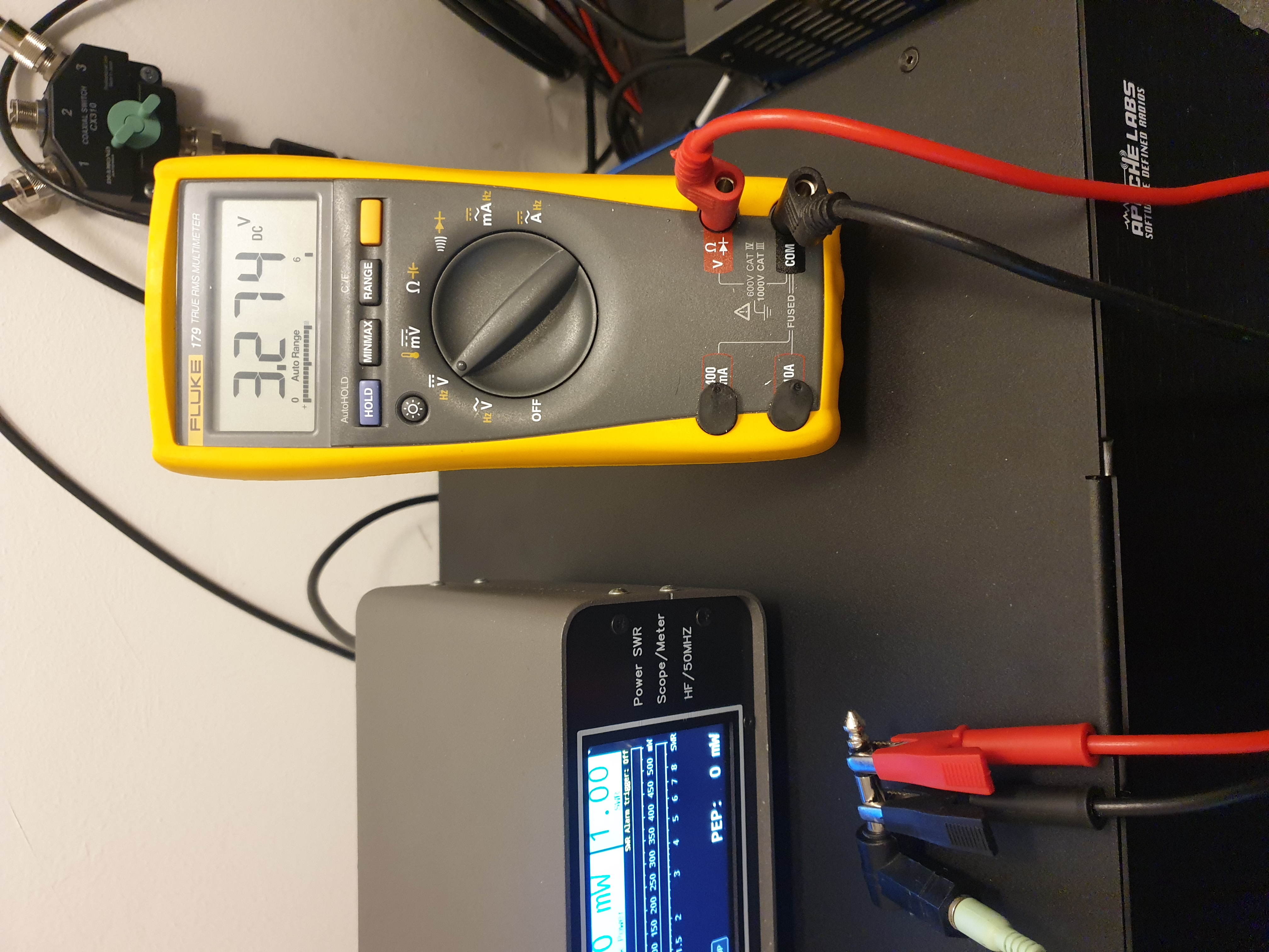

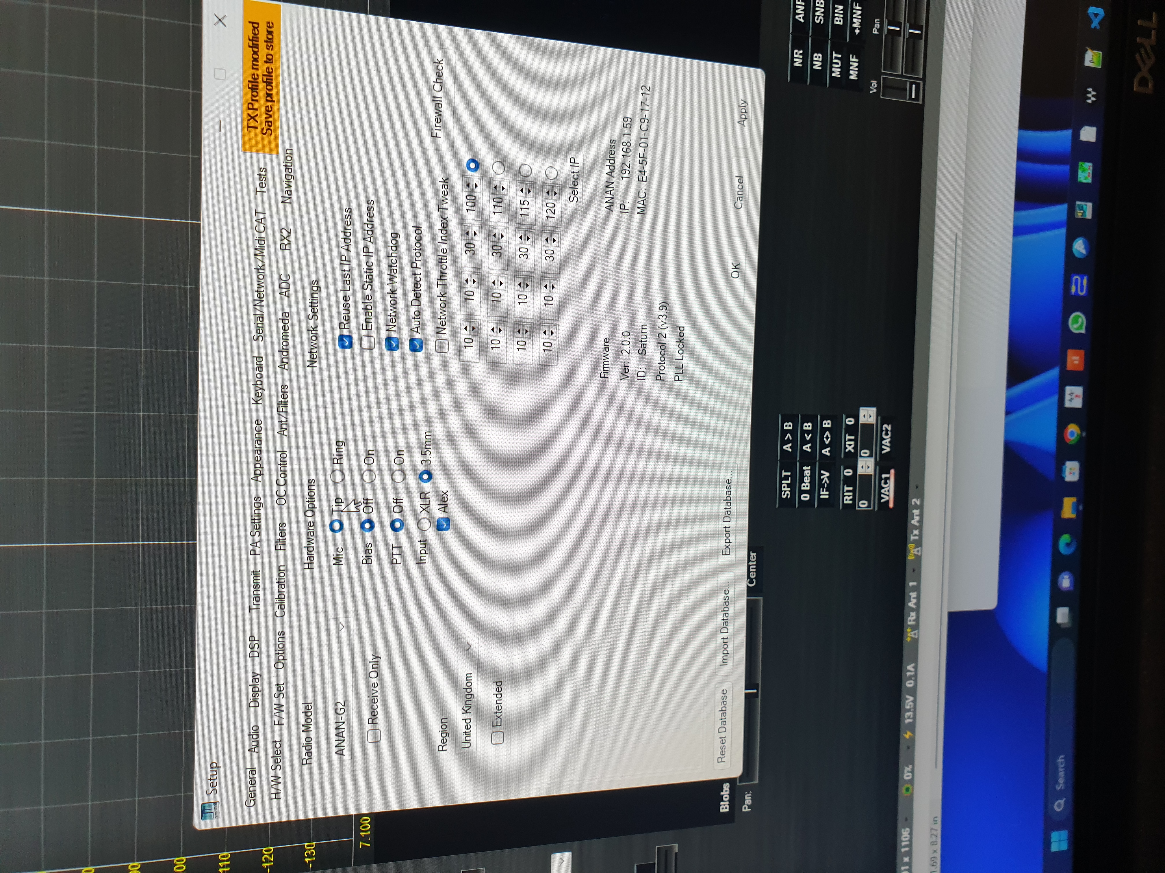

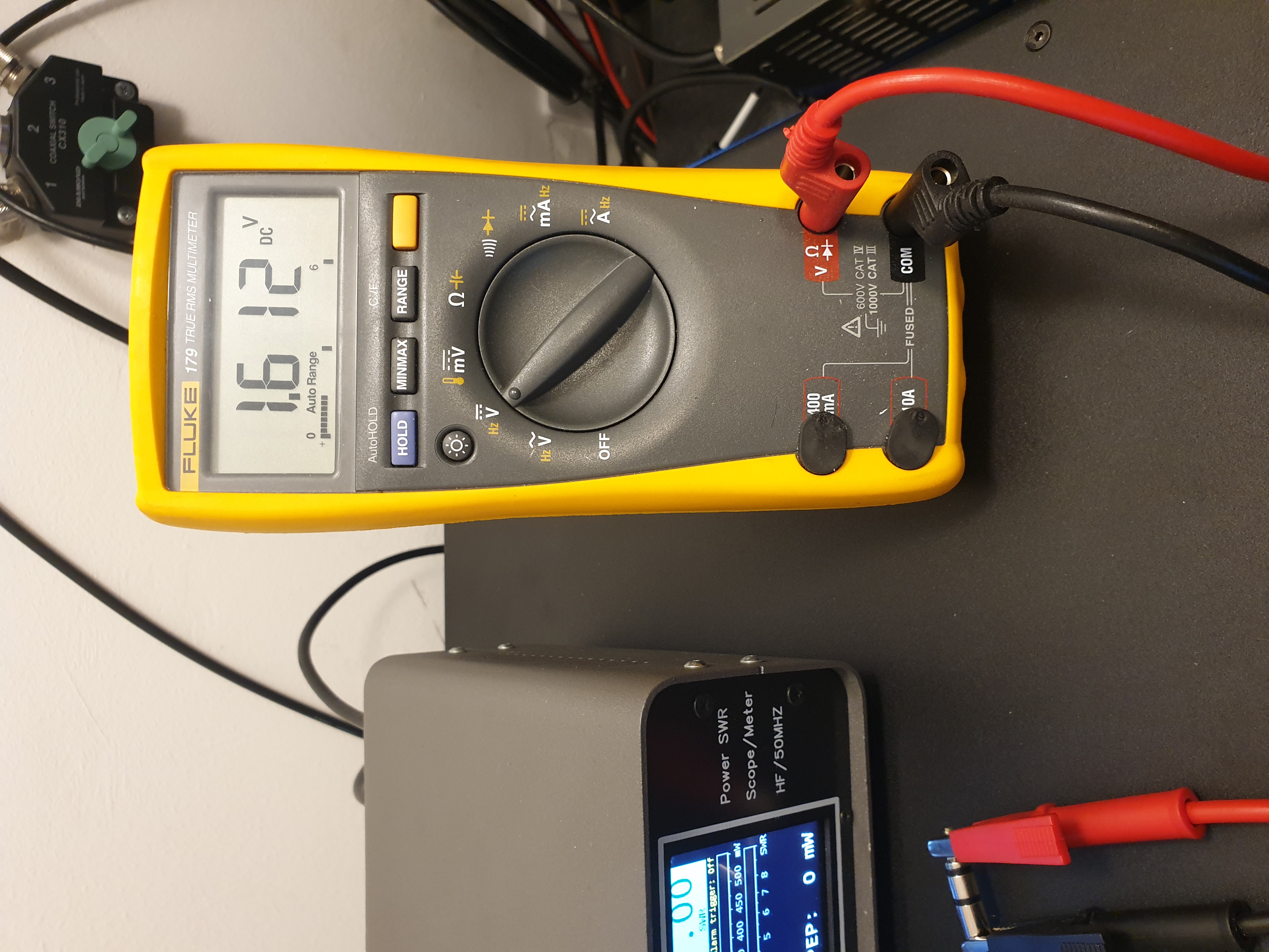

I took a few pictures to explain better. With bias disabled on the mic inputs I see a voltage on the mic tip and mic ring terminals which seems kind of weird.
Depending on Hardware Options -> Selecting either Tip or Ring voltage will be either at 3.2v at the tip and 1.6+ at the ring terminal of the standard mic input.
Flipping to Ring radio button -> Voltage of 3.2 will be on the ring termina and 1.6+ will be on the mic Tip.

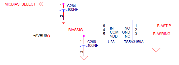

See image from Saturn schematic for mic bias - 5v is supplied to either TIP or RING and not split. The issue is on the board and not external to the G2.

Front panel mic bias voltage comes from U2. It is 3/4 of AVDD. U28 is merely a switch.See image from Saturn schematic for mic bias - 5v is supplied to either TIP or RING and not split. The issue is on the board and not external to the G2.
