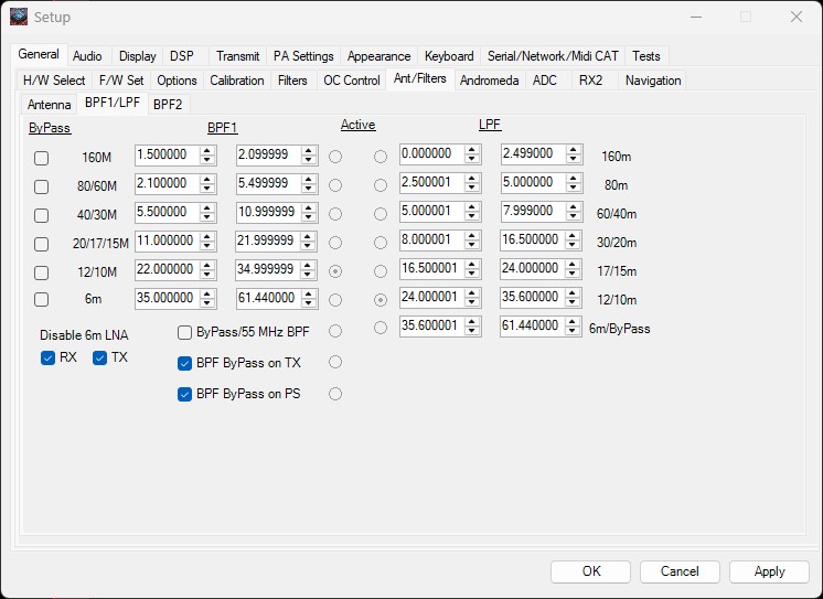

Please check whether the correct LPF is selected. At 12m, the 10m LPF should be active. There were devices where the 15m LPF was active, which led to a defect in the LPF. (When switching from 12m to 10m, no relay in the LPF should switch).
Do not attempt to compensate for any errors by significantly raising the driver line.
Which firmware and software version are you using?

Re: My 7000DLE MKII is low on TX power on 12 meters
LPF is correct, see screenshot below.
Firmware is Protocol 2 (v3.9) Ver 2.2.2. Software is Thetis v2.10.3.12 Release.
