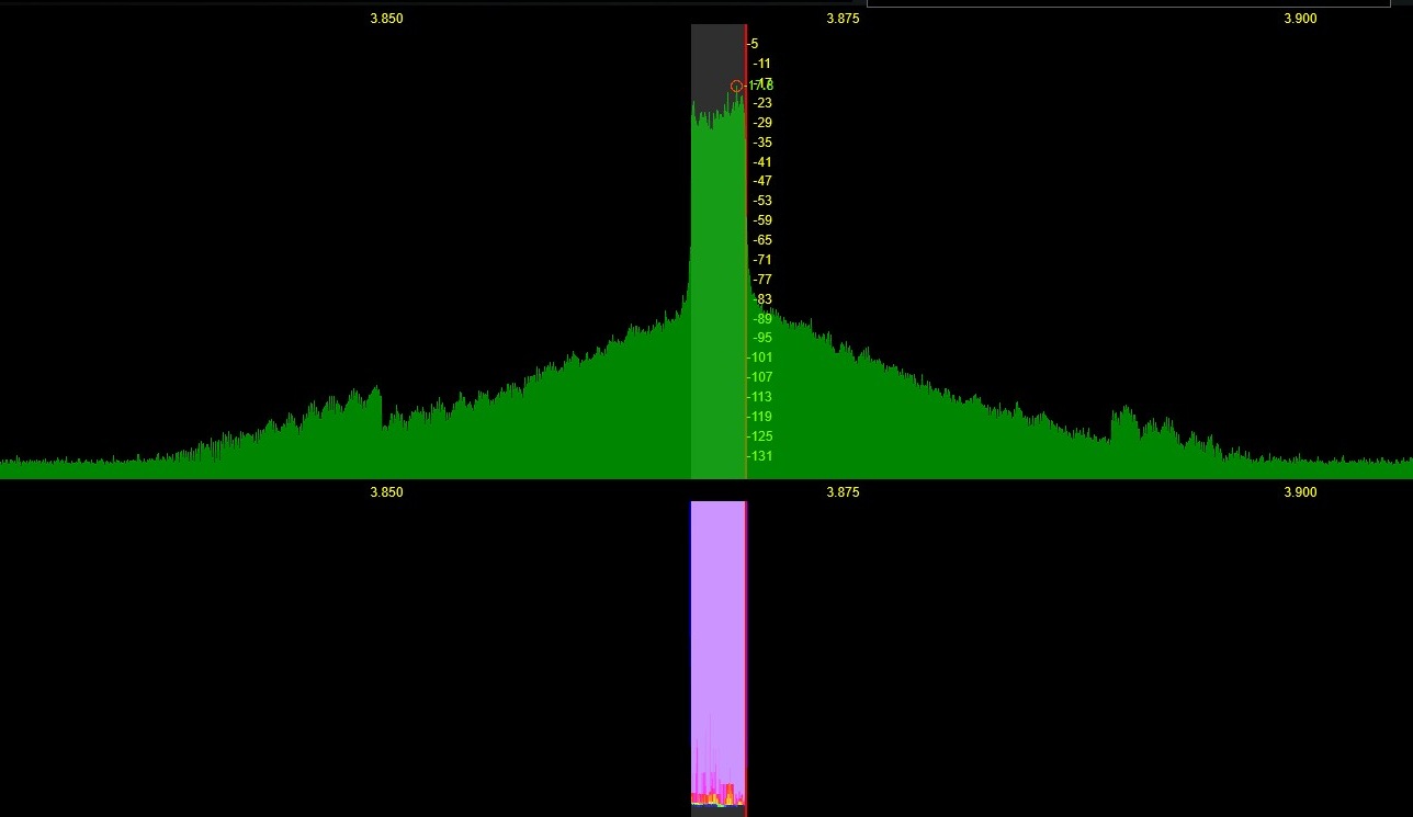

With that said, here's a snapshot of 40 seconds of voice transmission at 100 watts on 75 meters into my cantenna dummy load. I'm awarding PureSignal a solid "60" for its efforts, given that the slope of the IMD skirts intersect the passband at roughly -80 on the scale, and the passband peaks are at roughly -20 (IMO any very slight bulging at the skirt slope intersect points is due to artifacts from the Thetis display Windowing function and not IMD, but I could be wrong).
NOTE: I have my waterfall adjusted to flow very slowly ... my monitor is capable of displaying over 2 minutes of waterfall history so what you're seeing in the screenshot is my full 40 seconds of voice transmission.
[Edit] That transmission was not made using Single Cal, it was made using PureSignal in normal real-time adaptive correction mode.
