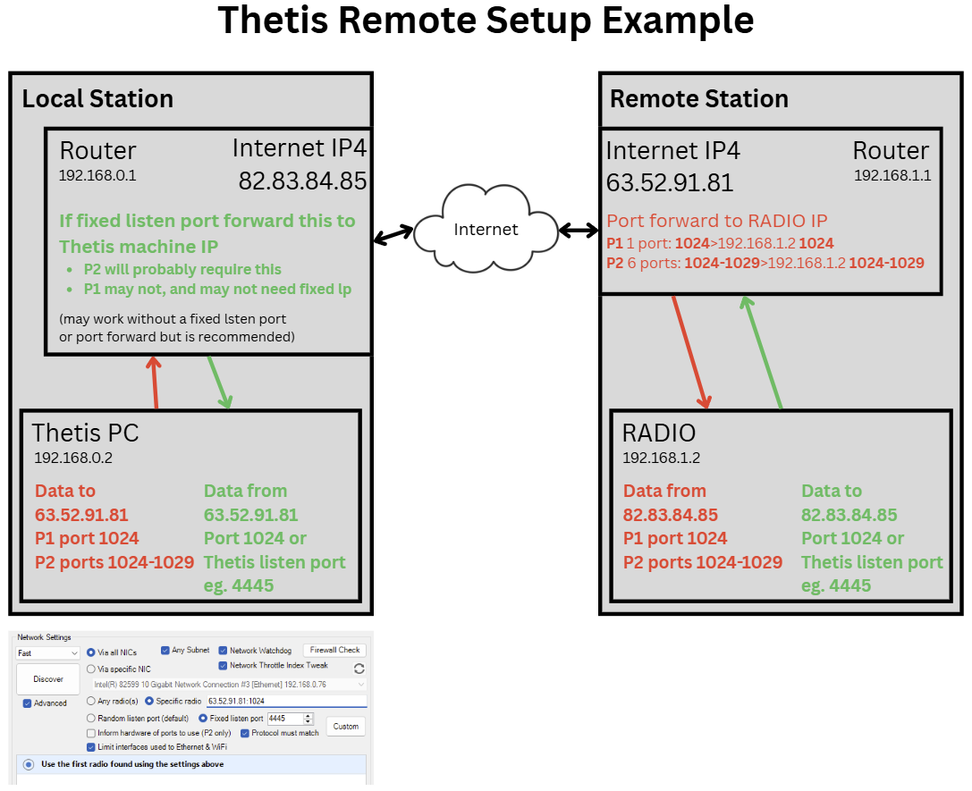

If you’re interested in trying remote operation with your ANAN and Thetis, Richie has provided a few files that outline the correct ports to forward on both ends. You’ll also need to join the Discord channel and access the development section to obtain the latest dev releases (participation and testing feedback are expected).

- Thetis Remote.png (122.1 KiB) Viewed 98 times

That said, the new network options in this dev release made things simple enough that even I could get it running.

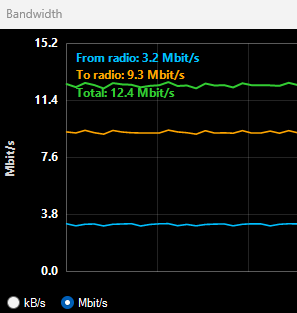

Here are some actual bandwdith readings from within Thetis using protocol 2, description below each image.

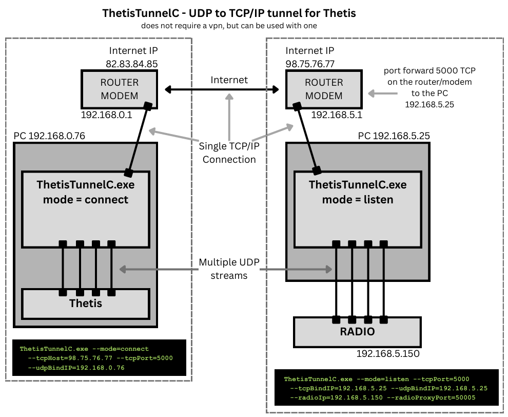

Also, related to all of this network stuff I built a small tool (ThetisTunnelC) in c++ that does the following. Still a WIP and is undergoing testing.
If you are willing to go to 48KHz sample rate it sure does become a lot easier!
Very cool!Also, related to all of this network stuff I built a small tool (ThetisTunnelC) in c++ that does the following. Still a WIP and is undergoing testing.
