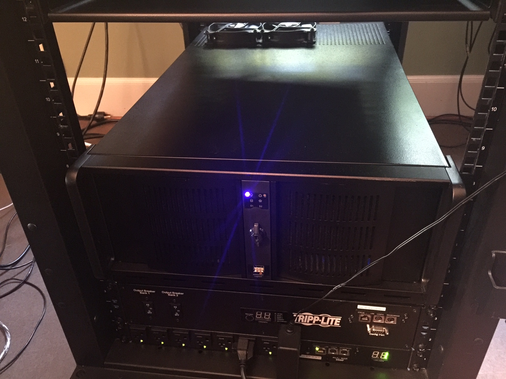

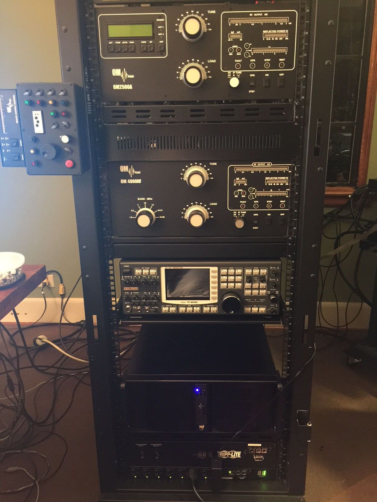

My build was a lot different than yours as I needed to rack mount the computer and its hard to find the space in server rack cases. I bought a 27 inch depth case and, as you can see, it is massive. Still, its too cramped to get all of the Corsair H100i V2 water cooler inside the case. I had to mod it to separate the fans and mount them on the outside. I also noticed your video card appears to be water cooled?
I had a bit of a pucker moment last night as I was tweaking the BIOS to see if I could improve my Passmark score. I inadvertently selected the wrong DRAM speed in the BIOS and thereafter the computer would not boot. Nothing. Black screen. Nothing would let me back into the BIOS. I figured a back-door work around today to get back into the BIOS and then reset everything, simplified some settings and BOOM, I was not only back in business but my Passmark score jumped by about 1k.
Attached some pics. Station is being rebuilt and 8000 will sit on top of the computer.

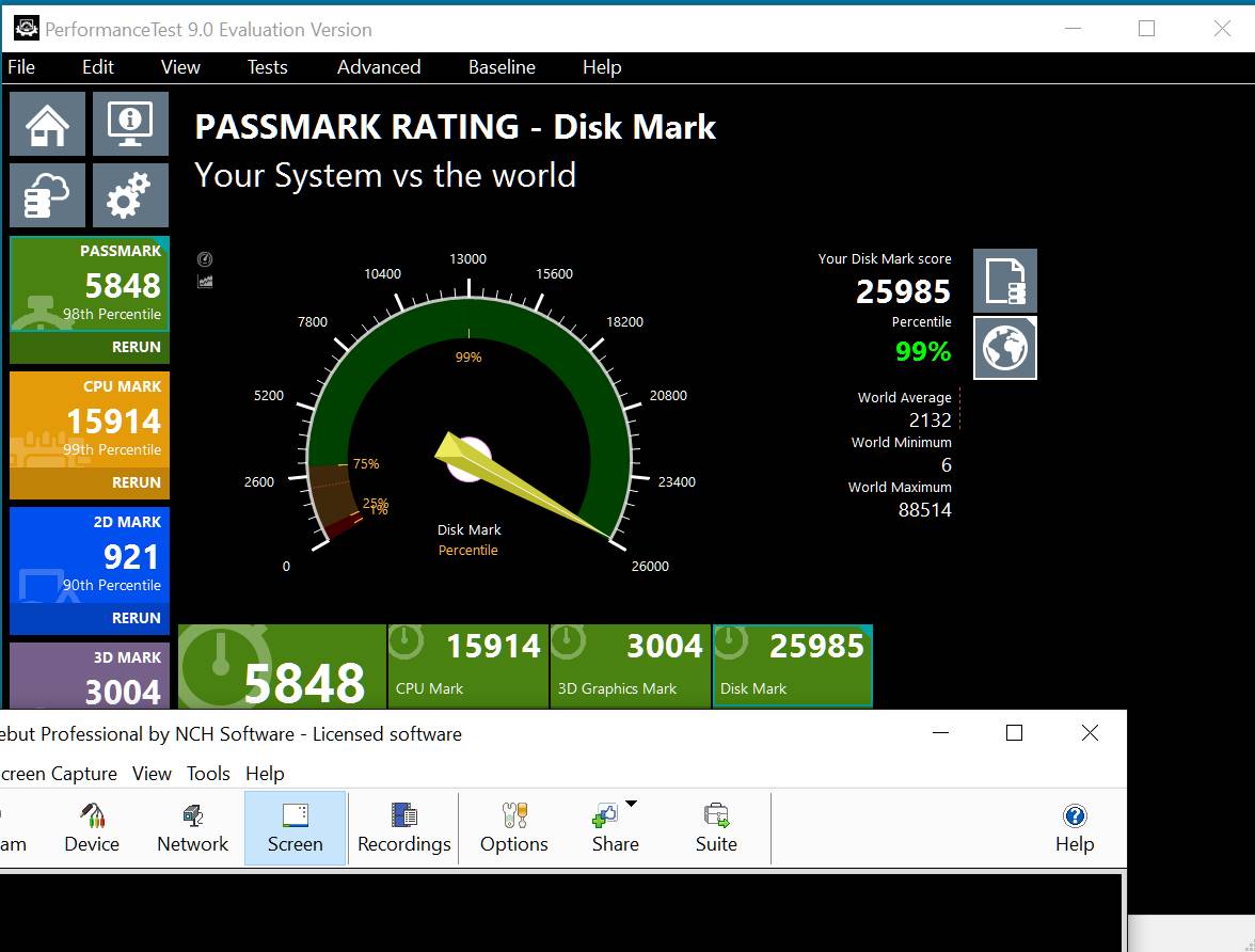

Re: New PC Build
Scott, not sure but here is my most recent Passmark score:
I am using Samsung Magician with the SSD and the CPU is an I7 Haswell. So, will be working on the video and RAM. I don't see any problem with the 8000 sitting on the computer. There is no heat under the unit and it is well supported by the case and a shelf under the computer which is rated at 250 pounds. Plus, I have a total of 72 RU's and have an Excel spreadsheet that says I will use 71.67 RU's. I ain't got the space for another shelf. Here's what it looks like so far.

I'd be interested to know what the CPUMark was for the Ryzen?
Also, to Simon's point, back when I first got my Flex 3000, my Nvidia GPU caused horrible problems with system audio performance. Reading the Flex forum at the time, it seemed people were having good luck with AMD GPUs, so I switched, and it did fix my problems. Fast forward to today, and now it was my AMD Radeon GPU that was causing problems, particularly in a Displayport, multi-monitor environment. In my new build I used the EVGA 1070 Nvidia-based GPU and I have to say it is soooo smoooooth. Not a lick of trouble audio-wise, nor in my multi-monitor environment. I'm very pleased with it, and plenty of CUDA cores to go around
Re: New PC Build: now UPDATED with overclocking performance
The CPU mark is 11918, that is a Ryzen 7 1700 at about 3GHz. Inside temps are around 100 degrees. I'm not thrilled I needed to buy Windows 10 to make it work. I did want a better video card so I can use SDR Console with my HackRF and my LimeSDR.

That's a pretty respectable CPUmark for a 3GHz CPU. 100C is Way Too Hot, though...

Another update:
- Got the deal of the century off of Craigslist: triple Dell P2815Q 4K monitors. The EVGA 1070ti runs them just fine.
- Blew some money on a next level sound interface, a Presonus Studio 192 Mobile.
- Got the tiny Hercules DJControl Compact. It's great, it has just enough buttons and wheels, and fits under the monitors when I don't want it.

Looks good Scott!
I keep on rebuilding and trying to eleminate everything that I really do not need, but it will quickly get a lot of cable that requires a lot of work ...
As I wrote in another part of this forum, I rarely have the same setup more than a month or two before I'm rebuilding, because then I've come up with another solution that may be of both major or minor nature.
There are many branches in this wonderful hobby that I usually say
Posting a picture when it's ready for this time.
Very nice, Scott. I love the colors, subdued lighting and overall clean look. 4k monitors are the bomb, particularly the Dells. I recently did what I thought was a small rebuild; really a relocation of the main computer and addition of a solid state amp. I moved the computer to the small (audio) rack) from the big (RF) rack. As usual, that turned out to be much more complicated than I expected. Once complete, I had some random black screens on my Dell 4k's. Nothing really changed except I added some DP extension cables. I juggled things and determined that the original cables yielded the same problem. I updated drivers, swapped monitors, everything I could think of and nothing worked. I Googled the issue and found no useful info. I then Googled the specific monitor model number and "black screen" and found an obscure note on the Dell support site that informed me that there are two different DP protocols available in the monitor setup, in a deep menu that I did not know existed. I changed the protocol and the black screens ceased. My graphics card supposedly supports both protocols but, after the computer move, it did not. No logical explanation for this. I pass this on in case someone else runs into this issue with DP connections.
