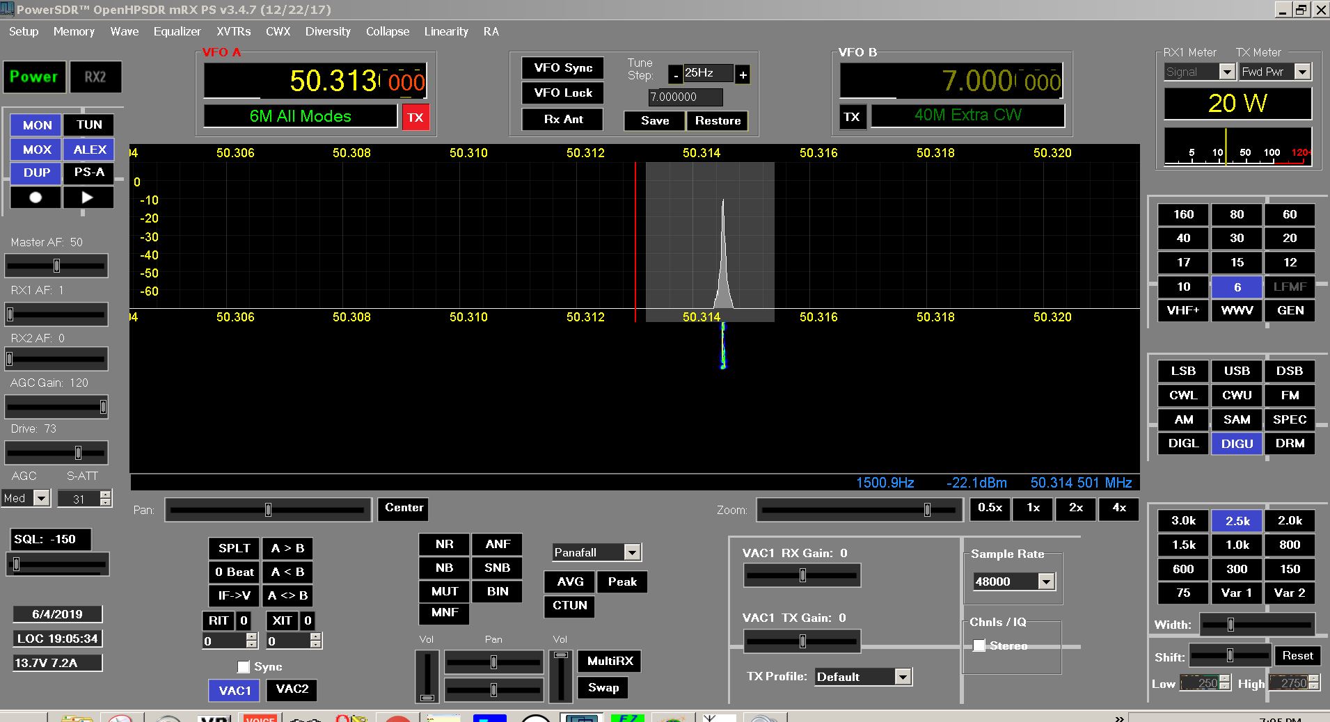

Dick--does it look like this?

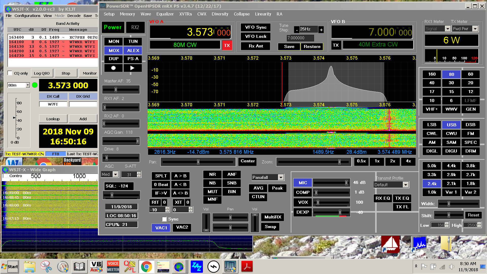

Greetings All !
This is what the signal looks like when it jumps from a narrow normal signal to a wide-jumpy one.
Whoops! It appears to be not possible to attach the "Screen Capture" image of the jumpy-wide FT8 signal to this message. It seems like "everything-computer" turns into garbage for me.
I tried to drag/drop the image from the saved file to this message - failed. Tried to copy/paste it - failed. This forum's process does not work
like the Windows-7 stuff in my computer. It would be too easy to attach the screen-capture to an email message to one/many but that would not
leave tracks-in-the-snow for other forum users.
How does one attach a screen-capture - or anything else - using the forum system?
Meanwhile, I am stuck with a jumpy digitally generated signal and a ghost system where VoiceMeeter Banana is NOT running, WSJT-X software and PowerSDR mRX settings call-out VMB input/output instructions, and it is working as effectively as when everything was when VMB was in the loop.
I hope to be able to use the digital modes with my ANAN-200D and 7000dle and not be stuck with just CW/SSB to guarantee a clean signal. ANY help will be appreciated !
73 Dick/w7wkr

- 1screen-capture.png (820.27 KiB) Viewed 34491 times
Re: ANAN-200D and WSJT-X/FT8 TX tone on waterfall display mushrooms
Dick,
That is not what I thought you were talking about ... turn DUP on first to see what the actual signal looks like... generally I don't run with DUP off but if my recollection is correct I don't 'see' any issues there... its when I have DUP on, when I'm looking at my actual signal fed back to the receiver, that I see there are issues.
Also I'm not sure what you're saying about VMB ... it (more than likely) is loaded on startup and you'd not have any signals to/from WSJT without having it running yet you seem to suggest it is not running? Not sure what you're referring to there. Scott might better understand.
Note the signal I'm seeing on your waveform isn't that aberrant - I'm seeing the side coming out at about 50 db down ... so that doesn't look overly harsh. The rounded top looks unusual though.... mine is as I'd expect - very peaky with steep sides (when right). My anomalies, when they occur, are much worse than this. I'll work on getting it on video (or maybe try to get lucky enough to capture an image as it is happening).
ok - I see one big faux pas .... you don't have DIGU selected! You're in USB mode!!!!!
Change that - otherwise nothing is going to be right.
Yes, as Gary says, select DIGU for digi modes. Doing this will automatically disable all transmit audio signal processing in PowerSDR (EQ, compressors, etc.) This is very important as such signals must be transmitted in an unmodified fashion.
And as Gary also says, turn on DUP. This will display the actual signal going out as received by RX1 during transmit. This signal will be sourced from either the internal coupling (on an older 200D this could merely be internal crosstalk on the board) or from the external coupler if set up that way. This is substantially different then the representation of the DAC datastream shown without DUP activated.
I would also recommend fine tuning the settings in Setup > Display, in particular those in Setup > Display > TX. See this thread for more information on how to do that:
https://apache-labs.com/community/viewt ... f=6&t=2545
Do all that, then report back your results.

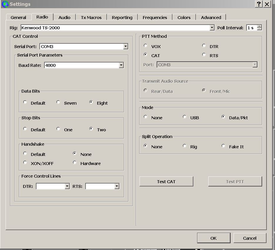

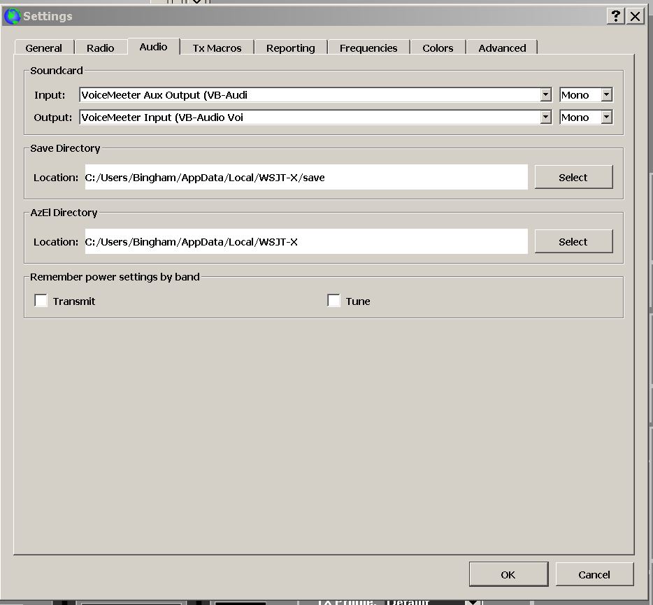

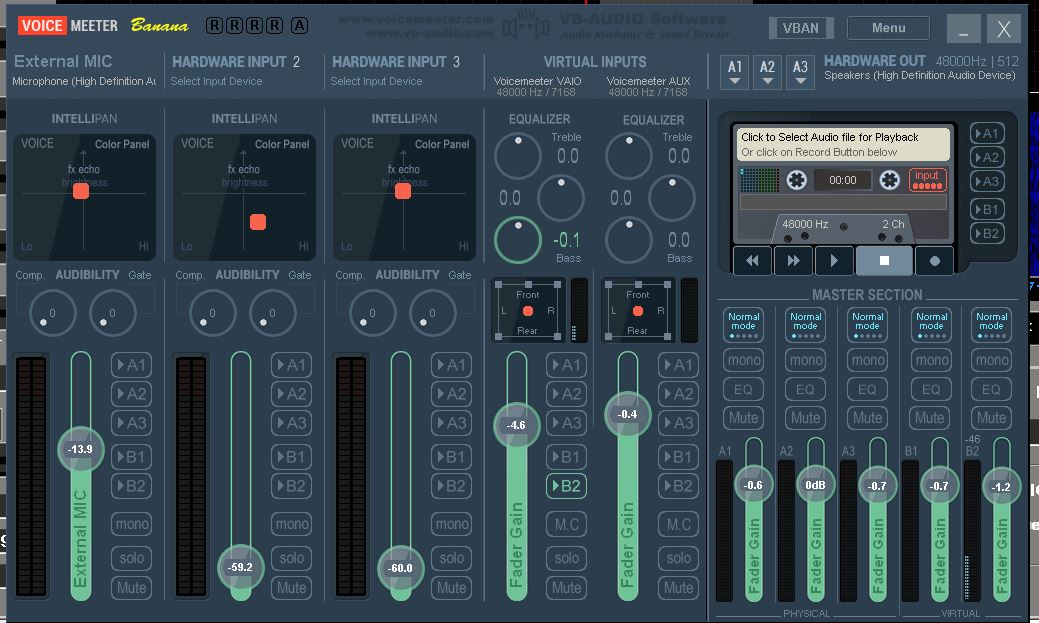

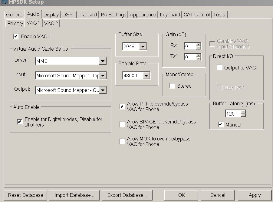

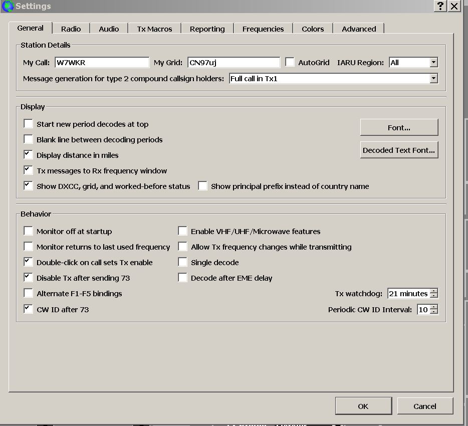

Gary - I did what you described below, examined ALL of the tabs and their contents and did not see the PowerSDR anywhere. In fact, there was no Tab labeled "Details" or anything close to it.
I am using a DELL "LATITUDE E6510" laptop running W-7 software so it may not support the 'affinity' stuff.
thank you for your reply. 73 Dick/w7wkr

==================================================w-u-2-o wrote:Yes, as Gary says, select DIGU for digi modes. Doing this will automatically disable all transmit audio signal processing in PowerSDR (EQ, compressors, etc.) This is very important as such signals must be transmitted in an unmodified fashion.

Gary/Others
OK, I have performed the following:
1 - Selected DUP
2 - Selected DIGU
3 - Started transmitting an FT8 signal with MON on so I can hear what is being TX'ed
When the transmission begins the signal I hear has a "Reverb-like" sound. I hear the expected tone and a significant 'click-sound' that repeats (slowly in seconds) in a decaying manner. Rather ugly in the display like a SinX/X waveform when the single-tone is accompanied by the decaying amplitude 'click'. Toward the end of the 15-second transmission the reverb-like condition has decayed to almost not detectable by ear.
I do not know if the Voicemeeter Banana SW is involved with the reverb-like decaying 'click' sound.
The displayed waveform/signal TX signal IS much more clean with this setup. Now If the reverb stuff can be eliminated, MAYBE I will get some responses to my CQ's and attempts to contact others who are calling CQ.
Repeating the above with affinity set to core #2 (Cores 0/1/2/3 available and ALL were initially selected)
No change in behavior.
73 Dick/w7wkr

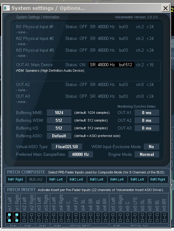

We need a whole bunch of screen shots to know what is going on. There should be no reverb sounds or anything else weird. You almost certainly have a problem with your setup somewhere.
Please post screen shots as follows:
1. Panafall with DUP on showing your transmitted FT8 waveform. Show the entire PowerSDR window so we can see all the control settings.
2. Your VAC settings tab.
3. Your WSJT-X settings.
4. Your Voicemeeter Banana settings.
5. Your VB Audio Virtual IO Control Panel and VB Audio Virtual Aux IO Control Panel.

Hi Scott
OK, #1 ===> DAMN ! I can snip the screen shot but it will NOT paste into this reply. What am I doing wrong - or not doing correctly - that prevents a snip from being added to this note?
Snipping/pasting works fine for me in Gmail.
73 Dick/w7wkr
You cannot just paste from the clipboard into a post. You have to save each screenshot to file. Then look carefully below the editor window on the forum and you'll see the "Options" and "Attachments" tabs. Choose the Attachments tab, click "Add Files" and add the files into your post.
OK, here they are - 8 attachmentsw-u-2-o wrote:You cannot just paste from the clipboard into a post. You have to save each screenshot to file. Then look carefully below the editor window on the forum and you'll see the "Options" and "Attachments" tabs. Choose the Attachments tab, click "Add Files" and add the files into your post.
73 - Dick/w7wkr
- 1.3.2-wsjt-x-audio-settings.JPG (89.49 KiB) Viewed 32189 times
- 1.3.1-wsjt-x-radio-settings.JPG (101.46 KiB) Viewed 32189 times
- 1.1-VAC Settings.JPG (93.27 KiB) Viewed 32189 times
Here are three more that did not get sent earlierw-u-2-o wrote:You cannot just paste from the clipboard into a post. You have to save each screenshot to file. Then look carefully below the editor window on the forum and you'll see the "Options" and "Attachments" tabs. Choose the Attachments tab, click "Add Files" and add the files into your post.
- 1.5-voicemeeter-control-panel-settings.JPG (92.46 KiB) Viewed 32189 times
- 1.4.1-voicemeeter-settings.JPG (123.9 KiB) Viewed 32189 times
- 1.3-wsjt-x-settings.JPG (112.18 KiB) Viewed 32189 times
OK one more screen capturew-u-2-o wrote:You cannot just paste from the clipboard into a post. You have to save each screenshot to file. Then look carefully below the editor window on the forum and you'll see the "Options" and "Attachments" tabs. Choose the Attachments tab, click "Add Files" and add the files into your post.
- 1-entire Window.JPG (261.66 KiB) Viewed 32189 times

Hi Dick, perhaps try clicking on MUTE on the external mic slider in voicemeeter banana ,perhaps there is a feedback loop that with latency sounds like reverb. Having said that that the input is not selected anyway but worth a shot. I notice also 0.01 - bass on voicemeeter banana , reset that to 0 just in case.
