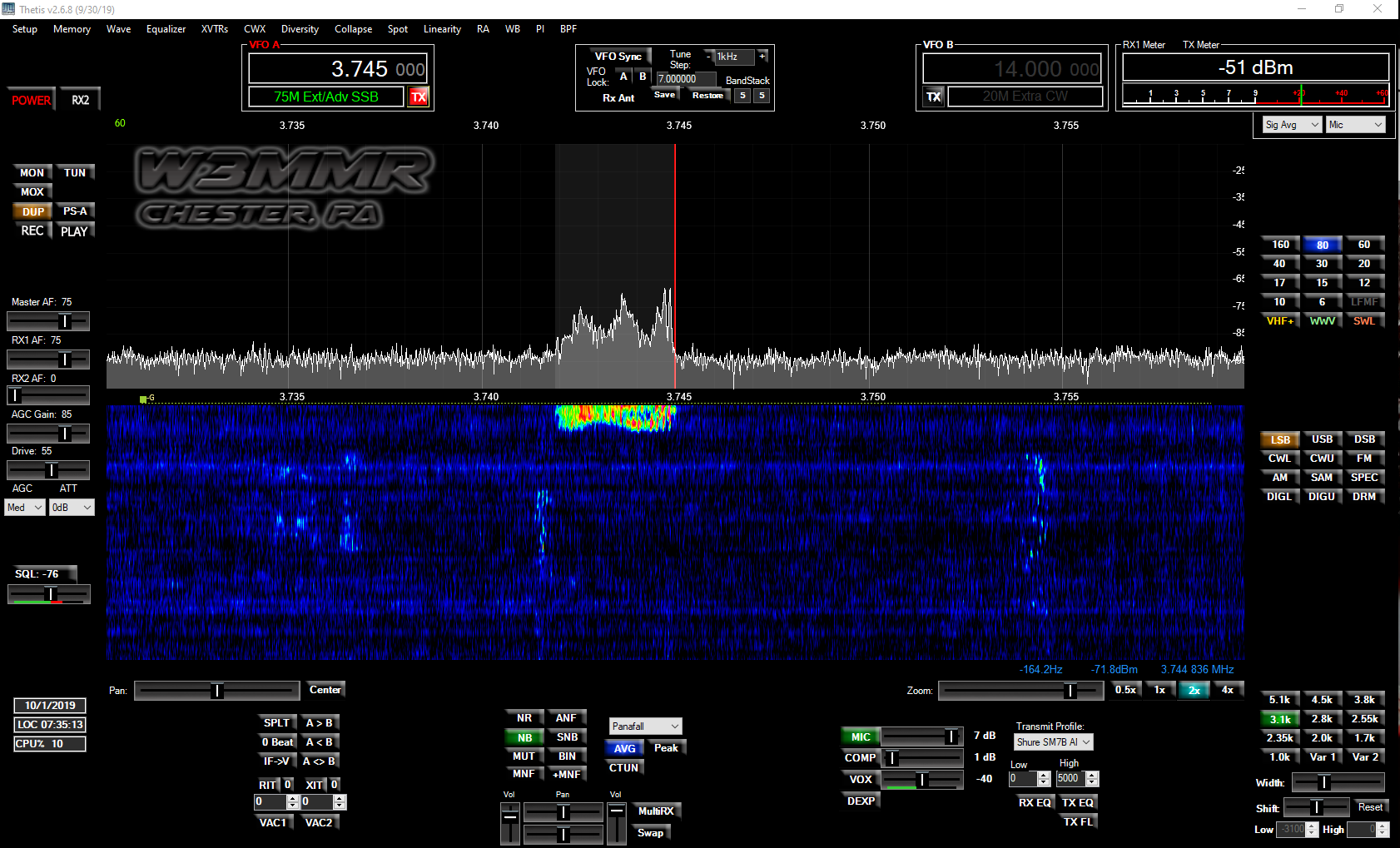

Great job Richie. the 9/30 update is working fantastic. CPU % is down to 6% in RX, and 8% in TX on a Dell XPS 8700 i7, 16gb of RAM, 2 monitors, and I can now stream cable TV, have picDisplay enabled, 2 monitors, and still hold 60fps with no problem. Kick ass!

One thing I did notice is that when the spectrum gird is aligned to the right on the panadapter, almost half of the numbers are chopped off. Its not that way when aligned to the left. Ive attached a screenshot.

W3MMR wrote:One thing I did notice is that when the spectrum gird is aligned to the right on the panadapter, almost half of the numbers are chopped off. Its not that way when aligned to the left. Ive attached a screenshot.sdsd.PNG
Perry
W3MMR
cheers Perry.
