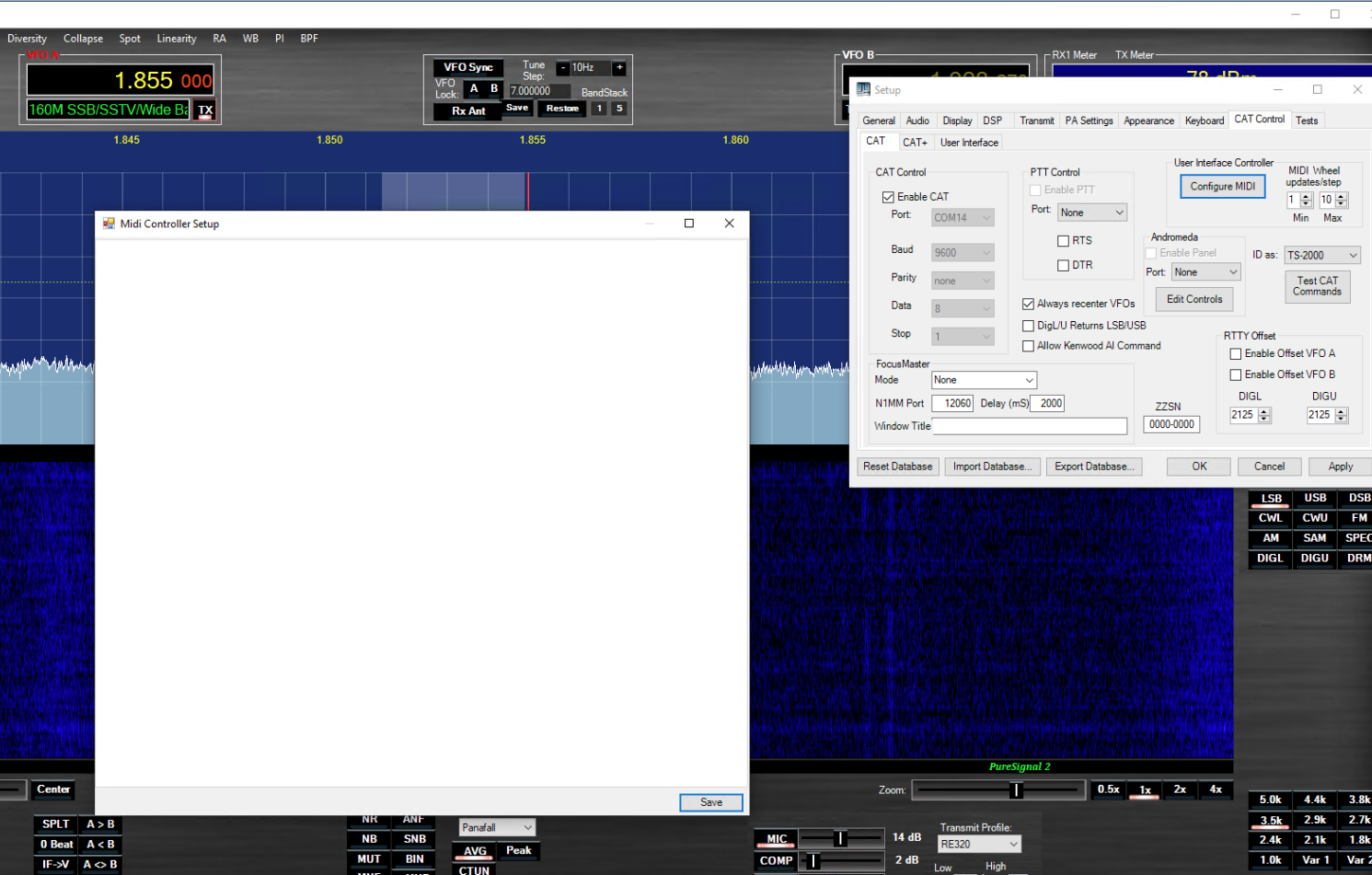

Re: 2.6.9
I use a MAC for my main computer and windows for my 8000DLE. Everything was working and all of a sudden after updating to the 2.6.9 A1, my MIDI controller will not work in a RDP session. I use RDP so I can easily use my 43 in monitor for my Mac and Thetis. This is what I get with the MIDI setup and I tried this via a windows 7 to the windows 10 via RDP and its the same result. The Midi screen is blank, if go direct to the windows 10 console, its fine and the Midi controller works fine which is a DJController compact.
Richie if you can test this using RDP and see if you see a blank screen, that would be great. If I need to do a total reinstall I'll do that but would like to get some input if this happens to someone else before I go through all that work.

Re: 2.6.9
Midi....Same problem here Nicholas. I will try and take a look at it today. Everything else seems to be fine except that midi window. Has this ever worked?
Edit:
ok, after getting laptop RDP'ing to dev machine (which took a bloody age because laptop windows needed updating), and running Thetis in debug mode, two functions :
midiInGetNumDevs
midiOutGetNumDevs
from winmm.dll (windows low level multimedia dll), are both returning 0, zip, nadda, when running over RDP.
So after investigating further, if you have your RDP connection set to play audio locally (ie on the mac) then Thetis host will see 'audio devices' from the Mac or remote computer. As your remote computer probably doesn't have midi devices plugged into it none will be listed. If you set your RDP to play audio on the Thetis host machine then midi devices will be listed. Please can I have the hour or so back of my life
W2SDR, try running at a low resolution say 1280x768 and re-test if you can please. If that works you might need to go into your bios and allocate more shared vram to the onboard 4600 HD chipset. It is the only thing I can think of really. However, a bit odd that the DirectX initialisation doesnt fail gracefully.

Re: 2.6.9
Thanks Richie!!! The funny thing is, this was working and I had no drivers installed on my mac, all was good. Then all of a sudden after the 2.6.9, it stopped. I tried almost everything. After I saw your post I installed the MIDI software on the mac and attached the DJController to it. Same issue. So for the hell of it, I plugged the DJcontroller back into the windows 10 machine and connected to it from the mac via RDP. Then all was happy! I guess the driver for the Mac needed to be installed on my mac, which makes no sense to me at all because it was setup to use everything local on the windows machine. I even tried redirecting the sound to the mac and attaching the DJcontroller to my mac (before installing the DJ software). But never thought about installing the software on the mac.ramdor wrote:Midi....Same problem here Nicholas. I will try and take a look at it today. Everything else seems to be fine except that midi window. Has this ever worked?
Edit:
midiInGetNumDevs
midiOutGetNumDevs
So after investigating further, if you have your RDP connection set to play audio locally (ie on the mac) then Thetis host will see 'audio devices' from the Mac or remote computer. As your remote computer probably doesn't have midi devices plugged into it none will be listed. If you set your RDP to play audio on the Thetis host machine then midi devices will be listed. Please can I have the hour or so back of my life![]()
Anyway....... All is working now..... Sorry to hit you with this nonsense, I'll mail you back the hour along with a pint.

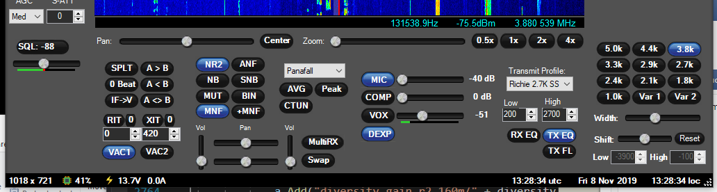

Re: 2.6.9
Status bar, clock panel removed, info now sits in the status bar.

Re: 2.6.9
Sexy!ramdor wrote:Status bar, clock panel removed, info now sits in the status bar.
Re: 2.6.9
Good Morning Richie,
is that new status bar on that picture ,,is that a teaser ?
Because I don't see that on my screen or it may missing something
if it's a teaser ,,,well thank you for the candy and I agree with Gary it's sexy.
Al
Al
Re: 2.6.9
It will be in a4 soon(tm). Hopefully people wont miss the old clock box. Can set text and background colour of it. I am going to add a warning triangle that will appear if there have been any seq errors. Click that to bring up seq log window. V/I is only available on 7000/8000's, not sure if that info is available from other hardware.
