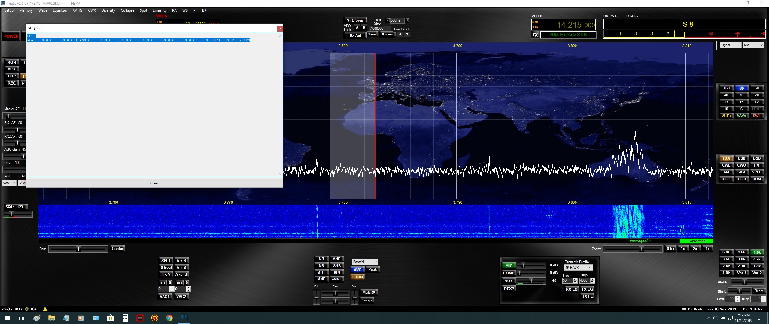

So far, I have not seen any -ve numbers in my SEQ log. But, in this selection from my log
s11=0 0 0 0 0 0 0 0 0 0 0 0 0 0 0 0 0 0 0 0 0 0 0 0 0 0 0 0 0 0 0 0 0 0 0 11 0 0 0 0 11/10 06:34:47:637
s12=0 0 0 0 0 0 0 0 0 0 0 0 0 16 0 0 0 0 0 0 0 0 0 0 0 0 0 0 0 0 0 0 0 0 0 0 0 0 0 0 11/10 06:31:28:511
s13=23 0 0 0 0 0 0 0 0 0 0 0 0 0 0 0 0 0 0 0 0 0 0 0 0 0 0 0 0 0 0 0 0 0 0 0 0 0 0 0 11/10 06:31:00:375
s14=13 0 0 0 0 0 0 0 0 0 0 0 0 0 0 0 0 0 0 0 0 0 0 0 0 0 0 0 0 0 0 0 0 0 0 0 0 0 0 0 11/10 06:23:41:703
s15=0 0 0 0 0 0 0 0 0 0 0 0 0 0 0 0 0 0 0 0 0 0 0 0 0 0 0 0 0 32 0 0 0 0 0 0 0 0 0 0 11/10 06:11:49:158
s16=0 0 0 0 0 0 0 0 0 0 0 0 0 0 0 0 0 0 0 0 0 0 0 36 0 0 0 0 0 0 0 0 0 0 0 0 0 0 0 0 11/10 06:11:03:900
what do the nonzero 's' numbers (bold above) mean?
And, for no particular reason, here's a screenshot of my current Thetis.
Thanks Richie for everything!
73, John

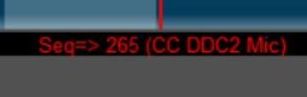

Good news Nicholas, but looking into it there does seem to be an event logged that is not trapped in code, which can be seen in the Event Viewer application log. I am still trying to locate it. An out of array bounds followed by a sharpdx exception, it might be an issue internally in sharpdx/directx, not sure yet.
John, the positive numbers signify that a data packet arrived from the radio that has a sequence number greater than expected. In your case it looks like the odd bit of packet loss. The values are a delta, received vs expected.
If you see negative then those are the important ones. -ve signifies that a packet has arrived that has a sequence number lower than expected. Certain patterns of these these could be fixed with a packet reordering system. You will see a red surround on the warning icon if there are any negative deltas, and we would like the logs from these. There is a thread that has started related to SEQ errors here : https://apache-labs.com/community/viewt ... f=9&t=3189
This is what you will see if a negative shows up :

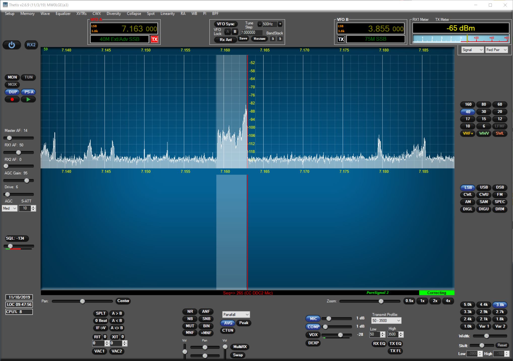

Re: 2.6.9
Inexplicable!jeffreydoran wrote:Saw this morning on 7000DLE 2.6.9 a4 (Pre4 Firmware))
NJ2US
I just don't see how the stack can do something like that.
Richie, can clumsy generate a sequence that rewinds three packets and then continues on from there?

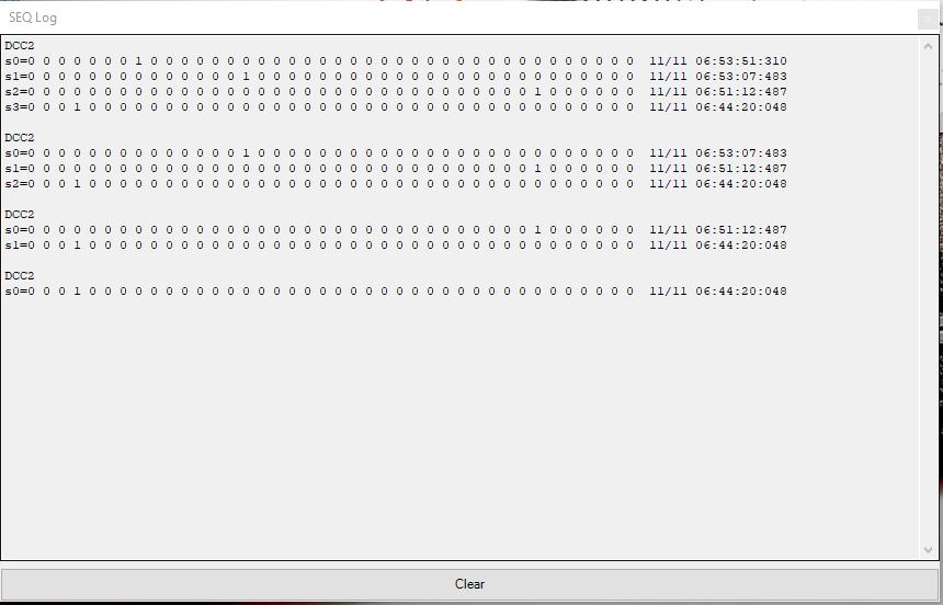

Re: 2.6.9
I am getting some SEQ errors. Seems to only be on transmit that I get them... Heres a screenshot from a half hour QSO this morning. I was running OBS and making a recording, streaming WebSDR, and had Thetis maximized @ 1920x1027. Zero audio glitches, no drop outs, no freeze ups. I cross posted this in the Seq Log thread as well. Not sure the best place to post it.
W3MMR
W3MMR

Re: 2.6.9
Several thoughts for the group:
1. If you are going to post a looooong seq log, I'd suggest putting it into a text file and attach it. It will make reading the ongoing conversation easier.
2. Carl: has ANY combination of P2 firmware and Thetis not crashed for you? If the answer is "Yes", I'd suggest you go back to that to confirm that it is in fact still the case. If it is no longer true then something else has changed in your system to cause this. If the answer is "No", then it may be that you have some corner case hardware that just can't run the firmware properly. Also, do these crashes ever require you to power cycle the ANAN hardware itself? If no, then maybe the firmware is coughing up a malformed packet of some sort that is not trapped in 2.6.9 and that is what is causing the crash.
3. It appears we are all obsessing about seq logs a bit too much. UDP is a lossy protocol. There will be dropped packets occasionally. If you see a few entries in the log and the results are not audible then I'd suggest everything is working fine. If you see large dropouts (large positive numbers), or just have a lot of them, then it could literally be anything: poor firmware performance, a bad switch, a bad cable, a bad NIC, something in your PC associated with the network protocol stack, or blocked threads preventing timely Thetis execution. The thing is, the seq log will NOT tell you what or where any of these things are broken or struggling. Hence posting them is unlikely to buy you anything unless you see a pattern in the numbers other than occasional positive integers.
Re: 2.6.9
Looks like just a bunch of packet loss, which as Scott pointed out could be a whole host of things.
I am still yet to see any -ve +ve -ve patterns here and i've been hammering it. Looking for these -+- patterns is the main reason for the seq logging. Unless you see a red warning symbol I would say there is not much to be gained by posting the seq log.
I'll get a new build out later today, and the source sent off to Doug. There have been a couple of 'under the hood' tweaks and changes but nothing really groundbreaking.
