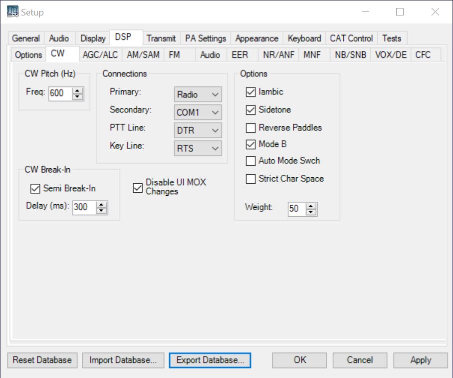

Serial port CW keying connections are not working properly on 2.6.9 b6 (and using an 8000DLE with pre8).
1. The serial port CW PTT line function does not operate under any combination of CW modes and controls. Thetis does not go into a TX mode (and not emit RF) when the serial port CW PTT line is asserted. Expected behavior is that, with QSK OFF and Semi Break-In ON or OFF, asserting this signal should put the radio into TX mode but not emit RF energy.
2. With Semi Break-In disabled (unchecked), the serial port CW Key Line input also does not work. Expected behavior is that asserting this signal should put the radio into TX mode and emit RF energy, regardless of the state of the CW PTT signal.
3. With Semi Break-In enabled, QSK on or off, the serial port CW Key Line input does work. The radio goes to TX mode and emits RF energy. So that part is OK as long as Semi Break-In is enabled.
I can confirm that both RTS and DTR control modes work OK. I can switch back and forth between them for key line and it works as expected.
This is a Thetis problem at the very least--even if the firmware had an issue the software should at least change to a TX state.
For reference and clarification:
When DTR is selected one shorts DE9 pin 4 (DTR output) to DE9 pin 6 (DSR input) to assert the function.
When DSR is selected one shorts DE9 pin 7 (RTS output) to DE9 pin 8 (CTS input) to assert the function.
A sample set of settings is shown below. For my testing COM1 is a real, hardware serial port (a virtual port can be used if desired).
It is worth noting that if QSK and Semi Break-In are enabled, remote, full QSK performance, including sidetone if DUP is ON, is possible on Orion and Orion MKII hardware. This can be a straight key using a serial port on the Secondary connection, or a paddle using a serial port on the Primary connection. The latter works perfectly, with dots when asserting DTR and dashes when asserting RTS.

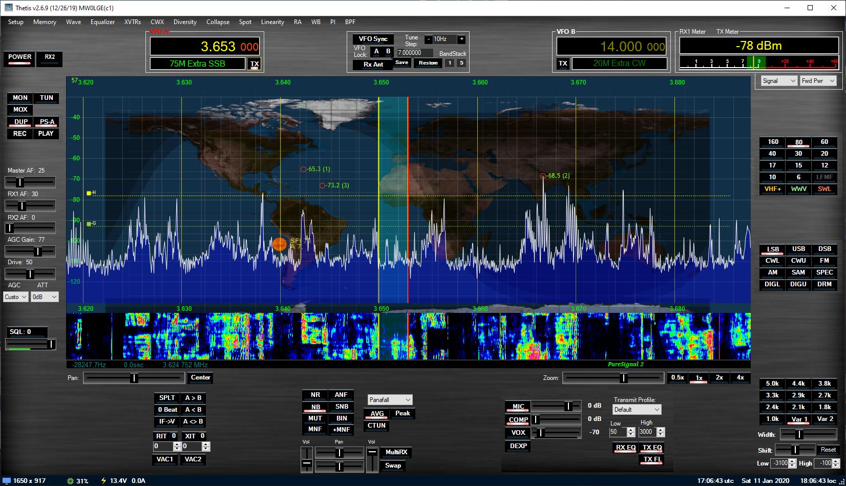

On Saturday, December 28th I came up with a question regarding the "non moving Worldmap". It appeared to me that either Sun Tracking and Gray Line Track are not moving at all, After some in-depth tests - and an info of a friend who tested that also - I have to correct this at least half way:
Once "Disable PicDisplay" is disabled and the Spot menu is enabled accordingly it's important to leave the "Spot" window open (do NOT close it!)! If it's still open and running Gray Line and Sun Tracking are moving every 2 minutes.
If it's not too much work it would be simply nice to have this option available on startup one day - as of now it disappears every time when closing Thetis.
May be it's simple and a check box can be implemented which allows auto-start?
Would be great as most HF operators are keen to see at least Gray Lines......right now we use Simon's WorldMap in an additional application.
Thanks for reading - 73,
Andy
Andy

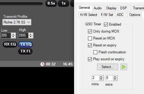

(1/4/20) c2
-fix: TX profile was incorrectly being selected during saving/updating when modes use different profiles (thanks Ultimax for spotting this)
-add: spectral area gets surrounded in red if high swr
-change: statusbar clock updated once per second instead of 10 times per second
-add: QSO timer, left click start/stop, right click reset. When in Mox activation only mode left click is ignored. Flashing timer if elapsed, with optional sound played through default windows audio device
(1/4/20) c2_1
-add: auto timer reset on expiration + flash continuation, some other bits tidied
link updated to c2_1
HI all,
Quick update, please try : link removed, see post #1 or latter posts
- QSO timer settings added to Options2 tab until a sort out/tidy of the setup happens.
- Left click on the timer on the status bar to enable/disable, or right click it to reset.
- If 'only during mox' is enabled the left click start/stop has no effect and is purely driven by mox.
- Reset on mox does just that, every time mox/tx starts the timer is reset.
- The sound playing is very simple and uses the default sound device in windows. There may be future work to integrate this into a specific audio device and/or mix with other streams.
- The timer flashes in status bar when expired, and also play the sound once if set in options
- Tooltips have more info

Nice Timer option. Once it is all working I can remove HamTimer that I use for this exact feature.
Any way you can add an option to reset once it hits the Expiration and count again?
Re: 2.6.9
yep, will do a repeat option, forgot about thatNC3Z wrote:Any way you can add an option to reset once it hits the Expiration and count again?
Re: 2.6.9
Update post above has new links to c2_1
73 Richie.
73 Richie.
Re: 2.6.9
Thanks for C2_1 Richie. Love the QSO timer with auto-reset and how quick and easy it is to use. Everything is working very well with 2.6.9 (c2_1) here.
Re: 2.6.9
nice one Rob. There may be some other ideas for it from others, but it seems to work ok. The audio playback is quite simple for now.W1AEX wrote:Thanks for C2_1 Richie. Love the QSO timer with auto-reset and how quick and easy it is to use. Everything is working very well with 2.6.9 (c2_1) here.

If your looking for homework..
CTUNE has no effect in Panascope mode.

Re: 2.6.9
aye, all noted John, however at the moment it is qso/tx timer, not just an id countdown timer. You can use to to see how much airtime there has been, you can use it to ding and reset to remind you to voice an ID. You can reset it manually when you voice an ID, or set it to an hour and when it starts flashing go talk to the XYL. It was a quick add that probably needs more features, count direction, etc etc.W1JA wrote:Thank you Richie for the ID timer!
