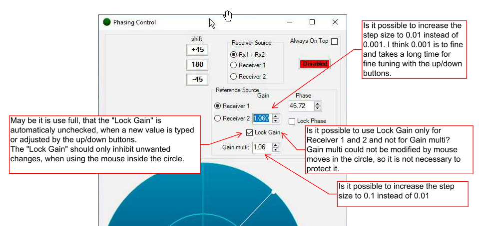

1st: I wish you a happy new year and
2nd: Thanks for your great job and time your are investing here.
And now my concern:
For me the diversity function is very important, due to a lot of local QRM.
I am not sure, if you had the time for all my wishes / proposals concerning the diversity function.
My issues were placed in my replies from 29. June and 3. 13. and 18. of July.
I saw, that one bug (aborting when typing numbers in the locked box) is fixed.
Had you the time for my other wishes / proposals regarding the diversity functions?
And please forgive me, when I didn't recognize a fix of my issues. I didn't install all of your releases, because I have to go back every time until diversity is running or until I can download your source code (for own modifications) from github.
In the last version which I tested, the values were limited to 1 and I need values up to 5 (or better 10).
Thanks again for your great work.
73 de Josef

Hi Richie,ramdor wrote:@dl5tt Josef, most (if not all) of your diversity concerns (and zero beat issue) were addressed in 21b, 21d and 21f, all released sometime in July 2021, including the ability to change the max gain beyond 1.
tnx for your quick reply.
I downloaded your latest version and testet the diversity-functions.
Because I have to use diversity nearly all the time, an easy and quick handling is very important for me.
So I have some additional wishes / proposals in the screenshot below. May be they are universally valid for other users of diversity.
Thanks in advance for your patience with me.
73 de Josef
- 2022-01-02 13_15_20-Window.png (162.1 KiB) Viewed 27898 times
