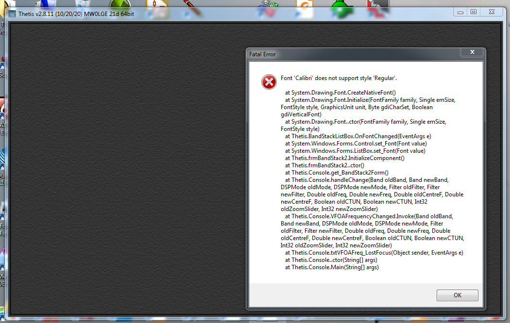

Hello
Please help
Installation 21a, 21b, 21с goes well, without errors.
As soon as I reach 21d, this is the picture.
Please help
- 21d.jpg (277 KiB) Viewed 30159 times
- 21c.jpg (288.53 KiB) Viewed 30159 times
@YL2GVC should be resolved in 21l
@Nigel should be resolved in 21l

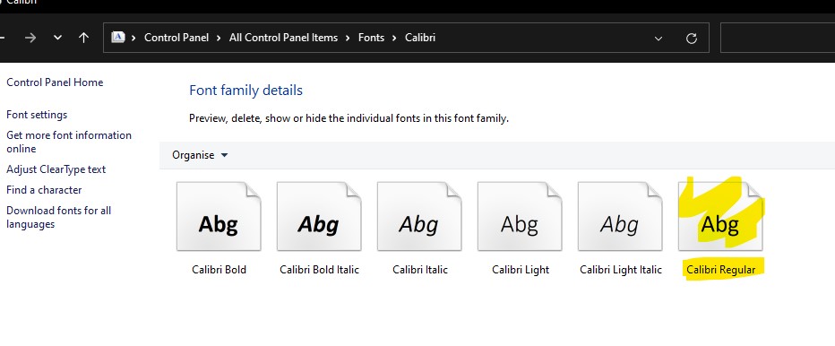

@Yevgeni it looks like you may not have the regular style of Calibri, or Calibri installed. It should be part of Windows.

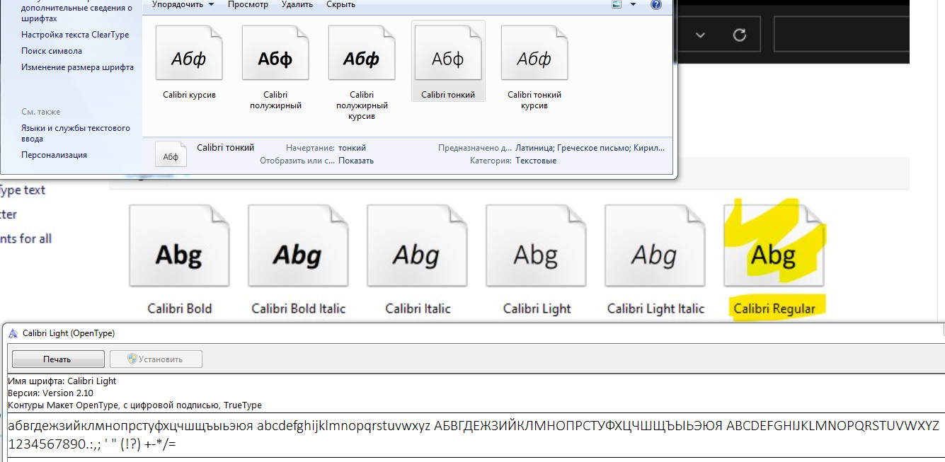

Hi Richie
Thanks for the answer. You're right. There is no font.
- calibri.jpg (188.94 KiB) Viewed 30113 times
Installed the font.
The launch was perfect !!!
Thank you!!!
