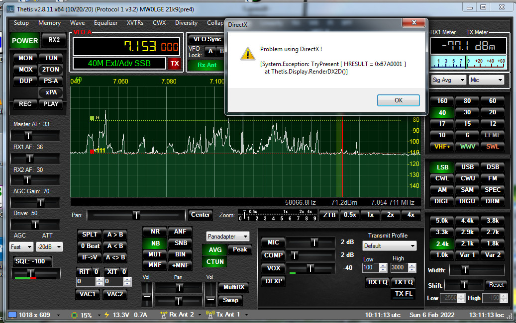

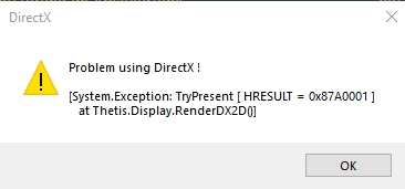

Re: Thetis v2.8.11 - UPDATES and current issues
Thank you for the DirectX Initialization fix for Windows 7. I had the same issue that Walter reported and your last K9 (Pre) update works fine here.
Hey all,
Cheers for the reports, we are slowly getting there with this pre build. Thanks to the button/skin builders as well for their updates. Anyway, here is another version to try, perhaps the last test of this before it moves out to post 1.
For those running PC's that are having difficulty maintaining 30fps/60fps check out the decimation option (display tab, refresh rates). It requests 1/N pixel width worth of data from the WDSP analyser and results in far less queuing / work by the cpu+gpu. For example, if you set it to 2, then only half the spectral data will be processed. Of course, the waterfall for example might end up looking somewhat 8bit ! (see attached image for level 6 decimation)
Angular mean option added to phase, and a couple of other fixes here and there, such as turning off SD when vfosync is selected, not selecting an entry every time the memory form is loaded, etc. Filter shifting now will be limited if filter limit option is use and an edge is hit. Also assigning a a dummy set of dsp filters/buffers etc to help with the CW mode swap. Please test the MUTE fixes for vacs/startup, I didn't connect up a headset to the radio to check.
Also, it is possible to enumerate the adaptors in a machine, and assign the directX render to a specific one. Please let me know if anyone thinks this is worth while adding to setup. I have also tested it with the directX software rasteriser, it does work, but somewhat slowly.
Oh, and after a year or so with it left in a bit of a resource mess, DirectX now clears everything down correctly, enabling it to be restarted on the fly.
219kpre4 Download x64 [md5:] - down below in the thread

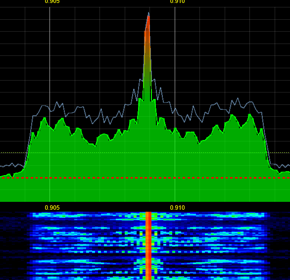

add: drop speed for active peaks and peak blobs, in dBm/second
add: zoom to band. Only works if in CTUN. Note: will only zoom out if the band can not fit into the sample rate selected
add: enable/disable un-mute when rx af sliders are dragged option (new options tab in audio section)
add: option for MHz and/or seconds/dbm/filter on the mouse cursor when in spectral area. When disabled you can hold shift to show on demand
add: limit filters to sidebands option. Prevents crossing the 0 point with certain filters, shifts are also restricted
add: dragging AM/DSB/SAM/SPEC filter edge with Shift held, will match the other side
add: decimation added to display engine. This can be used to reduce the amount of getPixel data and consequently speed up render with a reduction in resolution/
change: moved over to VS2022 as the ide
change: new wdsp release
change: PS client loops do not run if power off
change: mouse wheel adjustment on AGC sliders will disable AGC Noisefloor compensation
change: var ratio is shown even if force is enabled. You can see what is happening even if not used (reverts change made in 21k4)
change: moved DirectX over to a two buffer swapchain. UI events seem to be improved
change: added DX feature level support from 9_1 all the way up to 12_1. Will use the highest available on the default adaptor
Hi
There is a problem. Work on time and mistakes. Panorama in place. Thetis continues to work. I have Directx 11 and W7-64.
@Yevgeni , can you check the vysnc setting in display tab, and switch it the other way, save out, and restart. Just as a check.
R.
yes, DXGI_PRESENT_DO_NOT_WAIT is only supported from Windows 8 onwards, and is being set if VSync is OFF (unchecked) in Thetis Display Options. Tick it on, restart and should start up ok.
I'll will look at gating this option behind an OS check.
Performed various activities. The error remains. When starting other programs, the error appears immediately.ramdor wrote:@Yevgeni , can you check the vysnc setting in display tab, and switch it the other way, save out, and restart. Just as a check.
R.
did you check 21k9pre4c ?Yevgeni wrote: Performed various activities. The error remains. When starting other programs, the error appears immediately.
Maybe not all my actions are correct.
Richie.
hmm in that case it perhaps failed with the shutdown of directX. Can you send me the error.log from in the C:\Users\<user>\AppData\Roaming\OpenHPSDR\Thetis-x64 folder and I will have a look.
Thanks.
ok, after much reading, it is found.
The error is thrown when the render area is occluded, ie, there is no need to draw anything as it is covered up. Yes who knew that an error would occur with that ! Shees.
Build in an hour or three
Richie.
Richie.
