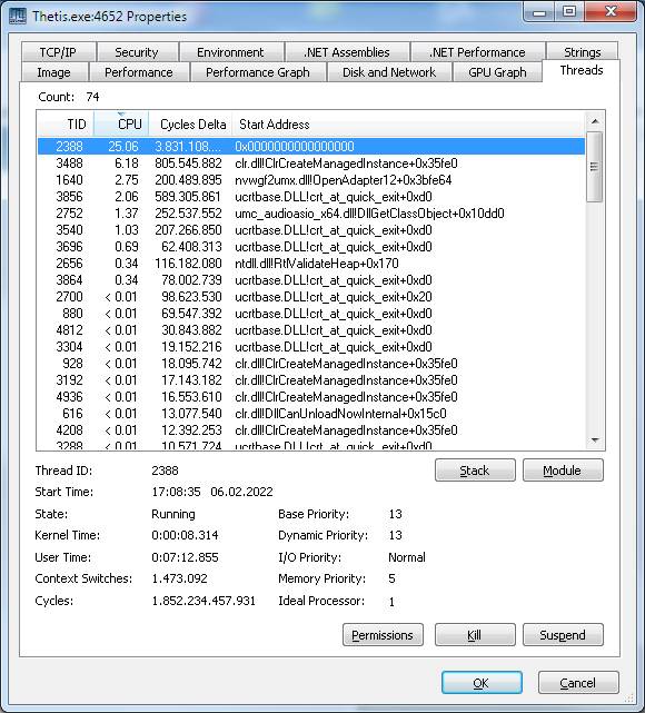

It's not the 2-3s i am be used to, this is way more and it's definitly introduced by 21k9.ramdor wrote:that is very interesting, perhaps the window issue was a bunch of dead msg boxes related to this occlusion issue spamming up. I added catch all error handling into the render function just to check things were behaving, and resulted in catching..... well.... everythingDL2XY wrote:Have another one, maybe related?
Thetis 21k9pre4c:
Switching modes takes a very long time (up to 30s) if mode specific panel have to be changed, e.g. USB/LSB/AM to DIGU/DIGL.
During this time the mode specific panel is only partional updated and GUI is unresponsive.
Starting Thetis in DIGU/DIGL leads to 6s black window (only bachground) after splash screen.
Database reset was futile, no exceptions or error log.
Walter

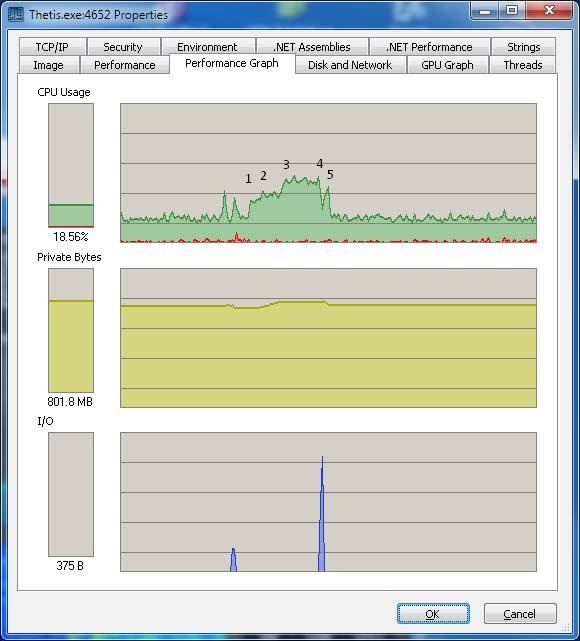

It happens in phases one can clearly monitor on CPU load:
1. DIGU click- sound stops, panel garbled, panadapter freezes, GUI freezes.
2. Panadapter works again
3. Sound starts
4. Mode specific panel is updated
5. GUI is responsive again
All in all that's nearly a minute of unresponsive GUI, most users would have killed the process before... (I did at first
hope it helps a little,
73 Walter
Edit: most CPU load during hang is in main thread.

You are right, i have tracked down the delays by adjusting everthing manually - it's mostly changes in DSP Buffersize and Filter Size.ramdor wrote:@Walter
21k9pre4c has been and gone, gone to the code grave. It could have been thrashing out exceptions every frame for all I know at this stage. Move on to next next version
WDSP has changed, that is out of my control, and the changing of buffers/filters/types for the dsp is slower than it was before. I will spend some of tomorrow working through the codepaths when changing modes and filter changes, because I think they are causing some problems.
For the moment align the modes that you are switching between for your DSP filter widths and types. There is some additional delay wdsp causes by the large amount of work it does when everything need swapping around and rebuilding. That is fine if you are calling a 1second delay function once, but not if it is accidentally being called 10 times. I've not had a chance to start looking.
EDIT: the new wdsp was introduced in 21k9, I only had it on the 30th Jan.
thanks for your time,
Walter
