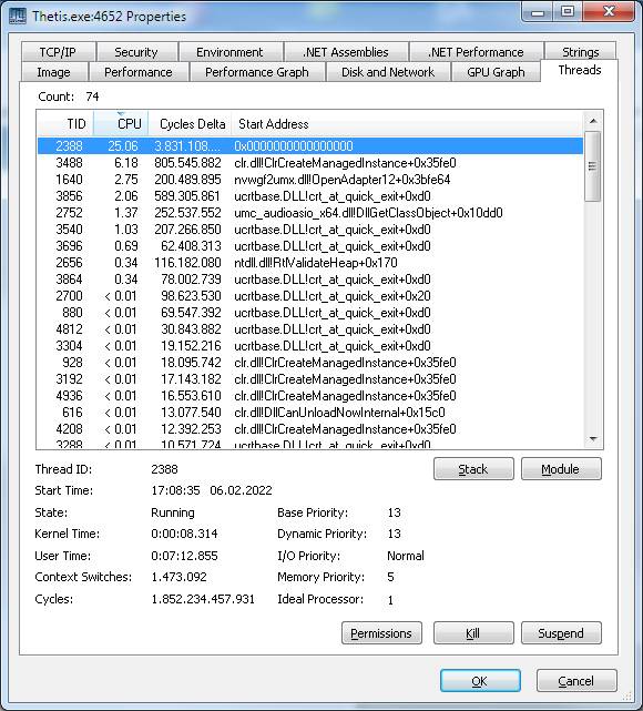

Thetis 21k9pre4c:
Switching modes takes a very long time (up to 30s) if mode specific panel have to be changed, e.g. USB/LSB/AM to DIGU/DIGL.
During this time the mode specific panel is only partional updated and GUI is unresponsive.
Starting Thetis in DIGU/DIGL leads to 6s black window (only bachground) after splash screen.
Database reset was futile, no exceptions or error log.
Walter
that is very interesting, perhaps the window issue was a bunch of dead msg boxes related to this occlusion issue spamming up. I added catch all error handling into the render function just to check things were behaving, and resulted in catching..... well.... everything ;)
Yes, the slowness of mode swap, it is a concern. I will build with older wdsp and time the difference. It can take upward of 2-3 seconds to rebuild the buffers/filters/types for a given mode depending on how different they are from the mode you just left. If there is some odd Mode/State swapping at startup then it could be doing this multiple times and the time adding up. It is not too high on my list at the moment, but it is there.
It's not the 2-3s i am be used to, this is way more and it's definitly introduced by 21k9.
I measured a few older versions to compare:
21j2 4.13s
21k6 4.05s
21k7 4.18s
21k8 5.36s
21k9c 45.96s

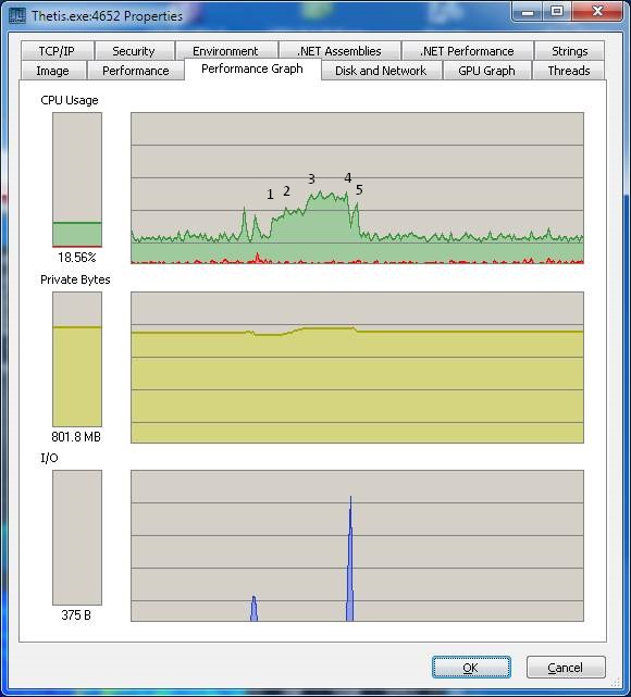

It happens in phases one can clearly monitor on CPU load:
1. DIGU click- sound stops, panel garbled, panadapter freezes, GUI freezes.
2. Panadapter works again
3. Sound starts
4. Mode specific panel is updated
5. GUI is responsive again
All in all that's nearly a minute of unresponsive GUI, most users would have killed the process before... (I did at first :oops:)
hope it helps a little,
73 Walter
Edit: most CPU load during hang is in main thread.

You are right, i have tracked down the delays by adjusting everthing manually - it's mostly changes in DSP Buffersize and Filter Size.
thanks for your time,
Walter

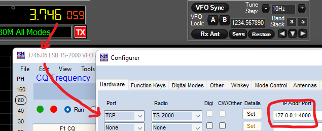

- add: TCPIP CAT server (under CAT+). Any number of connections can be made, each client has their own cat 'answer' strings. Currently the connection is terminated after 30 seconds of inactivity [todo: option to disable this/increase time]
