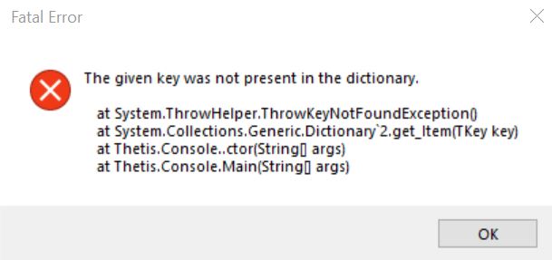

Got this error when using ctrl on the initial opening to merge the database
It didn't seem to hurt anything, but thought I'd mention it.

@scott, thanks, mark that one down to something stupid ;) will be fixed for next release but at the moment import/merge is broken.
Edit: i have updated the pre5 download with that fixed

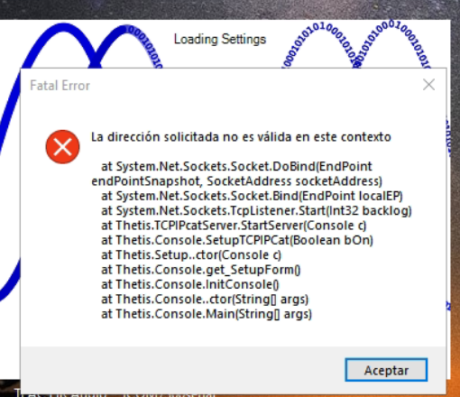

EA1DAV
Posts: 52
Post by EA1DAV »
Thetis 21k9 pre5, Anan 100D direct connect to nic card in same ip range, wifi adaptor for internet another ip range.
At start Thetis stop with this error
Captura de pantalla 2022-02-10 a las 13.20.12.png (191.63 KiB) Viewed 27574 times
