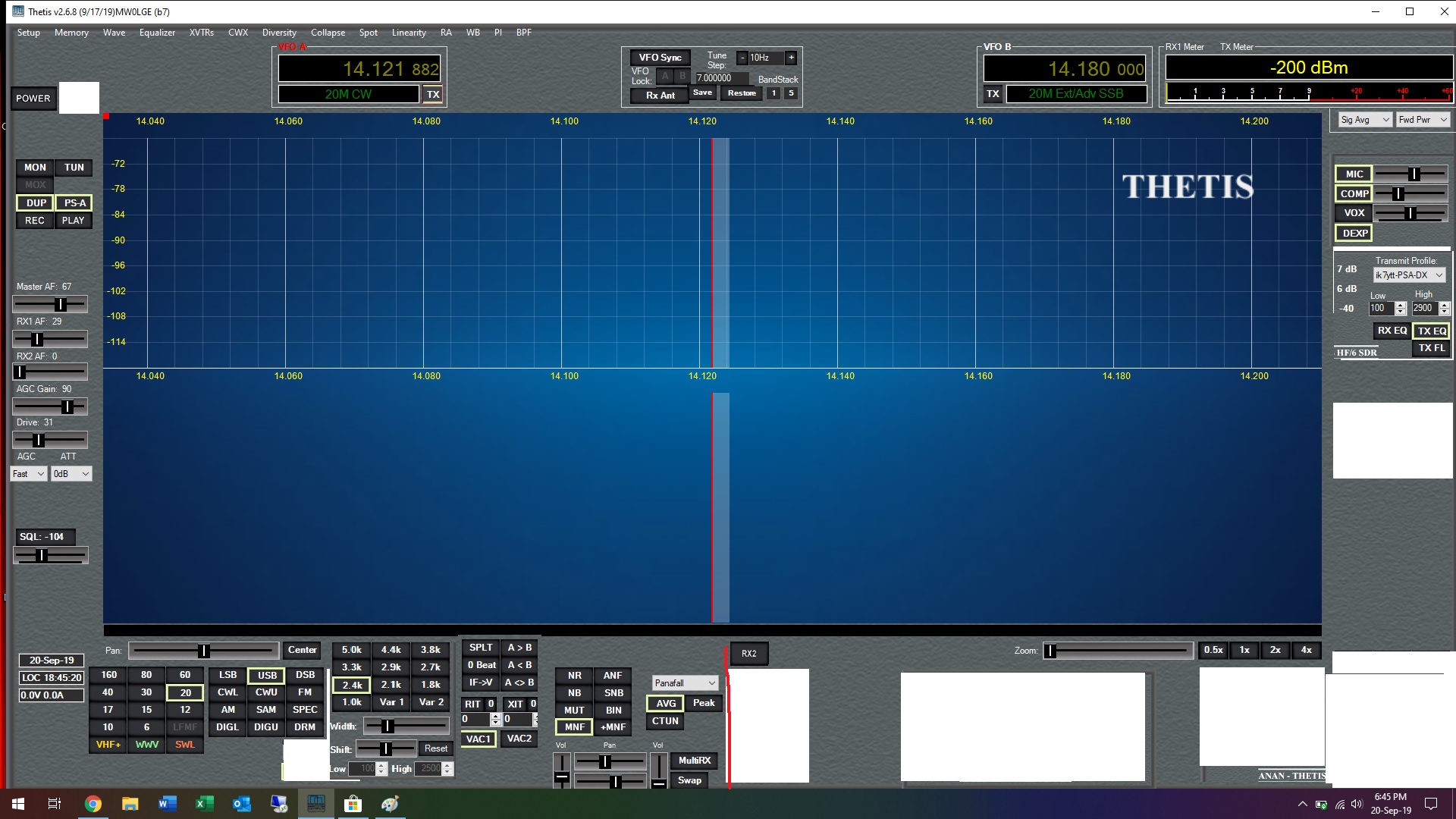

This version doesn't work on my PC (W10pro, german language, NVIDIA GTX1050).ramdor wrote:NC3Z wrote:Should Thetis work with 4K resolution?
Try this version : https://www.dropbox.com/s/srhq9rm6rvlob ... 9.zip?dl=0
I have just quickly added an indicator, that will show top left of spectrum/waterfall. A red indicator will show if the render thread is not achieving requested fps. Turn your fps down until this red indicator turns off 99.9% of the time. I can just about manage 40fps at 4k full screen on a 680GTX when showing panafall (with disable picDisplay enabled and no spot background).
Everything is a trade off at the moment. GDI+ into a picture box is not the fastest, and until the DirectX engine is completed (yes I have started working on it... dont tell anyone), then it will be a case of managing fps vs responsiveness.
But it does after moving the database into trash

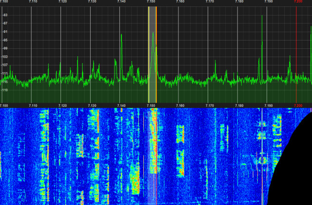

and while we're on the subject of window manipulations: suggestion - correct the water fall so that it is always 'correctly' displaying the signal independent of tuning.
Currently when one tunes the waterfall is smeared until the tuning has stopped ... since you know when tuning how much frequency change you've made, and you know the relationship of that to the amount of pixels traversed - you can use that value to move the waterfall whenever tuning thus keeping it always 'in sync' with the panadapter. Obviously the one side you are tuning away from would have a blank (background) screen for all of the displayed time and would only start displaying the new panadapter data/signal from that moment on ... but since it was off screen anyway (previously, before you tuned) its irrelevant. Yaesu I believe does this in the nex 101.
