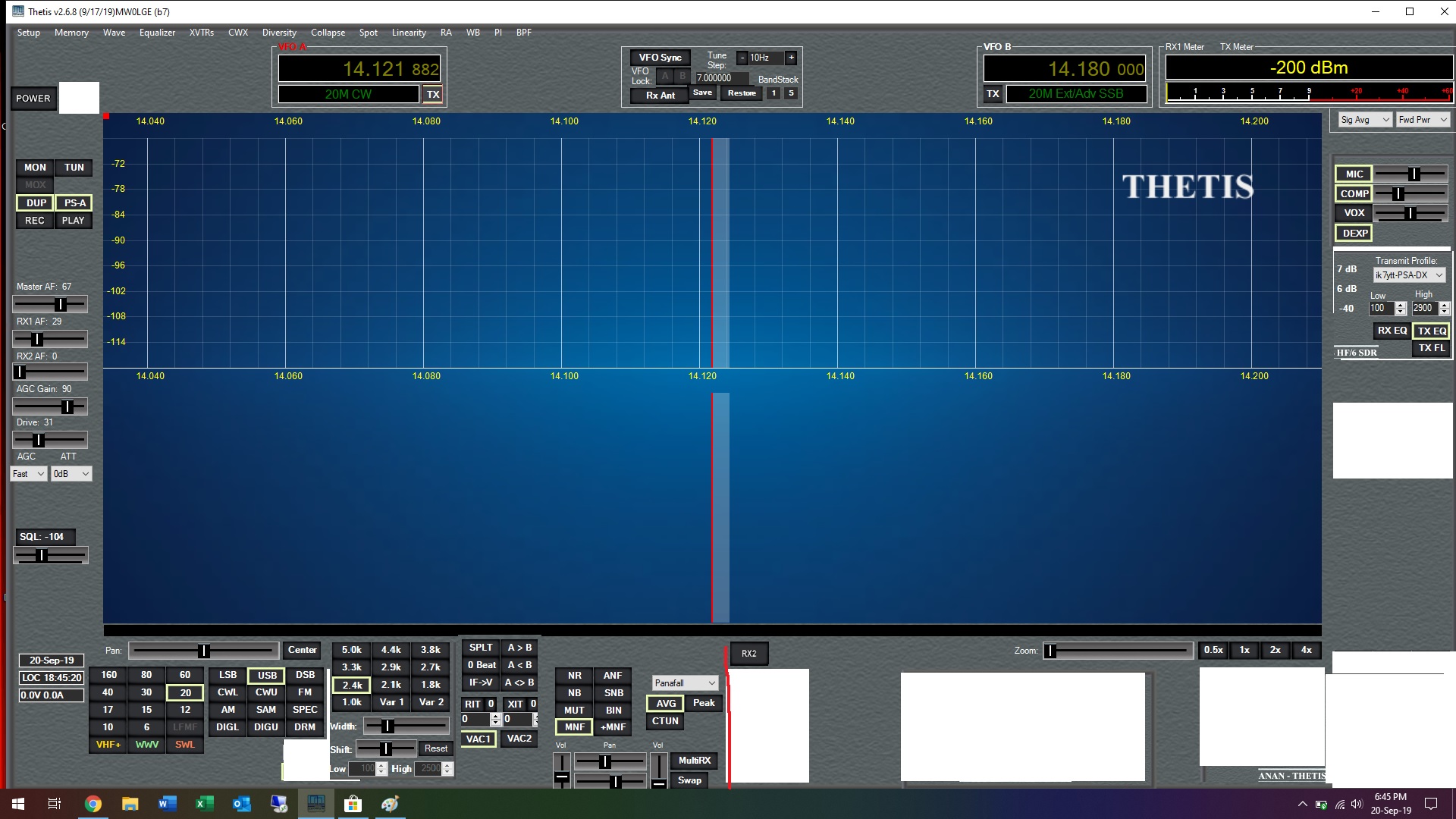

NC3Z wrote:Should Thetis work with 4K resolution?
Try this version : https://www.dropbox.com/s/srhq9rm6rvlob ... 9.zip?dl=0
I have just quickly added an indicator, that will show top left of spectrum/waterfall. A red indicator will show if the render thread is not achieving requested fps. Turn your fps down until this red indicator turns off 99.9% of the time. I can just about manage 40fps at 4k full screen on a 680GTX when showing panafall (with disable picDisplay enabled and no spot background).
Everything is a trade off at the moment. GDI+ into a picture box is not the fastest, and until the DirectX engine is completed (yes I have started working on it... dont tell anyone), then it will be a case of managing fps vs responsiveness.
This version doesn't work on my PC (W10pro, german language, NVIDIA GTX1050).
But it does after moving the database into trash :-)
Thanks Richie :-)

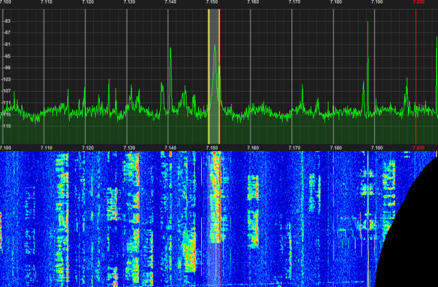

Re CTUN mouse shift of the window ... when the filter window hits the edge of the displayed window, stop its motion! This of course is accomplished by changing its frequency to keep it positioned at that edge of the screen. That way it is always on the screen - just at the edge as long as you are tuning in that one direction. You're never 'lost' as to where it is and there's no issues of turning off TX/RX because its no longer visible.
Re: 2.6.8
Posted: Sun Sep 22, 2019 1:00 pm
by K9RX
and while we're on the subject of window manipulations: suggestion - correct the water fall so that it is always 'correctly' displaying the signal independent of tuning.
Currently when one tunes the waterfall is smeared until the tuning has stopped ... since you know when tuning how much frequency change you've made, and you know the relationship of that to the amount of pixels traversed - you can use that value to move the waterfall whenever tuning thus keeping it always 'in sync' with the panadapter. Obviously the one side you are tuning away from would have a blank (background) screen for all of the displayed time and would only start displaying the new panadapter data/signal from that moment on ... but since it was off screen anyway (previously, before you tuned) its irrelevant. Yaesu I believe does this in the nex 101.
Re: 2.6.8
Posted: Sun Sep 22, 2019 3:08 pm
So, two couple of possibilities :
1) Move the RX/TX passband when the IF edge is hit, but it will mean that whatever frequency you were on before is now lost. The RX/TX passband will now be on either edge depending which way you are tuning.
2) RX/TX disabled if outside IF, and the RF/TX passband left as tuned and will not move (this is how it is at the moment but rx/tx is not disabled)
Any other possibilities?
Also Gary, with ref to moving the waterfall data. At the moment the whole texture data is shifted down by one pixel, and then new row added at the top. This is very fast, when analysed the waterfall function completes in half the time of the panadaptor. Keeping the waterfall 'in line' will mean pushing each line of that texture by the tune delta, which whilst ok on an ftdx-101d with 480 pixels ( :lol:) vertical if they were using the whole screen is somewhat quicker than someone running at 4k. Would it not result in something like this with a big chunk of black appearing as you tune up in the band in this case?
Cheers Richie.

I don't know that it matters that if you tune to the edge - in CTUN - you lose where you are! Its the nature of hte beast. You ARE tuning afterall AND asking to tune outside of where you are... NOT showing where you are, i.e. having it off screen to me is a non-starter as it means I don't know where it is or how far away it is if i happen to get carried away with it.... but again - it is what one intuitively would expect, get to the edge and now the window moves vs. the filter passband moving.
When I partnered with a Planetarium program way back in the 90's for astronomy and I asked to provide a means to have a digital setting circle tie it to the program (no one, at that time, was doing this - it was all new by us) the planetarium guy said "but I can't refresh the screen fast enough" to which I said "let the position of the telescope move around the screen - say if it were tracking or if it were being moved ... and if it gets to the edge of the screen redraw it with the telescope centered at that point in time... then repeat. You could do that here but the downside of that you are still losing your TX/RX passband position and b) you keep the edge near to the edge ... another option.
As for doing a pixel shift - you couldn't just move a pointer to the display array? You have an array the size of the window and a pointer for where new data enters and one for where it exits ... and when moving those shift relative to the array. If this were data in general this would be an easy thing to do - how video is handled, IF it is even handled or accessible this way I don't know.
Re: 2.6.8
Posted: Sun Sep 22, 2019 11:02 pm
by K9RX
That stated what you had said - the 'black area' is what I had said would be a result of doing this - although I was thinking it would be a line which was the left (or right) edge of the display - the edge you are moving towards.
If however you are saying timing-wise it is a different animal - one to the other the pan vs. the WF then indeed possibly there isn't a clean solution and the limited window of the Yaesu is what allows them to get away with it.

The Ctune implementation will be super.
if possible for me will be nice also re-organize position of band/filter and other button in better way.
there is a lot of un-used space, and when RX2 is activated , become really difficult to understand. i made a screenshot and moved some buttons just for general idea.
Thetis desing idea.jpg (419.75 KiB) Viewed 31474 times
thanks again
Andy ik7ytt

Thanks for the reports for various things/issues, all have been added 'to the list'.
..... Direct X conversion
Needing a change of 'scenery' from the rest of the code, I thought I would have a play with the SharpDX (2d) library. The following video shows current progress, running on my brothers rather nice PC (mine is a bit crusty with 8+ year tech).
https://youtu.be/N5bMWviKivs
(sorry not a 4k video, but hitfilm express is unable to export in 4k@60fps)
His system can reach around 38fps@4k with GDI+ with the picDsiplay background turned off before the red indicator fps issue starts showing. Switch it to DirectX and boom, 4k@60fps no problem with 2 Rx both in panafall mode. The responsiveness of the whole thing is in a different league when running in DirectX as can be seen just by the redraw speed of the setup window. You can see from the vid that in GDI+ mode the primary thread is 100% capped, however when switching to DirectX all that effort is offloaded to GPU and additional directx controlled cpu threads.
It is probably a couple of weeks from being put to out test.... coming soon (tm) :D
Cheers,
Re: 2.6.8
Posted: Tue Sep 24, 2019 10:21 pm
Drooling over that video! My god, I can't imagine what it is going to be like living in the 21st century, finally!
Fabulous work, Richie, really outstanding!
