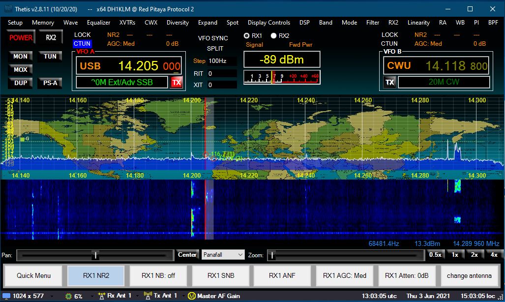

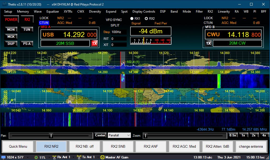

Re: Andromeda???
Posted: Thu Jun 03, 2021 1:20 pm
by DH1KLM
Ken wrote: Will the new Andromeda allow the old back grounds to be used in the pan-adapter window?
Short answer: Yes
Copy your "833 Tubes" background pic (picDisplay.png) in C:\Users\your-name\AppData\Roaming\OpenHPSDR\Skins\your-skin\Console
It will be displayed also in collapsed mode (Andromeda)
Like this.
