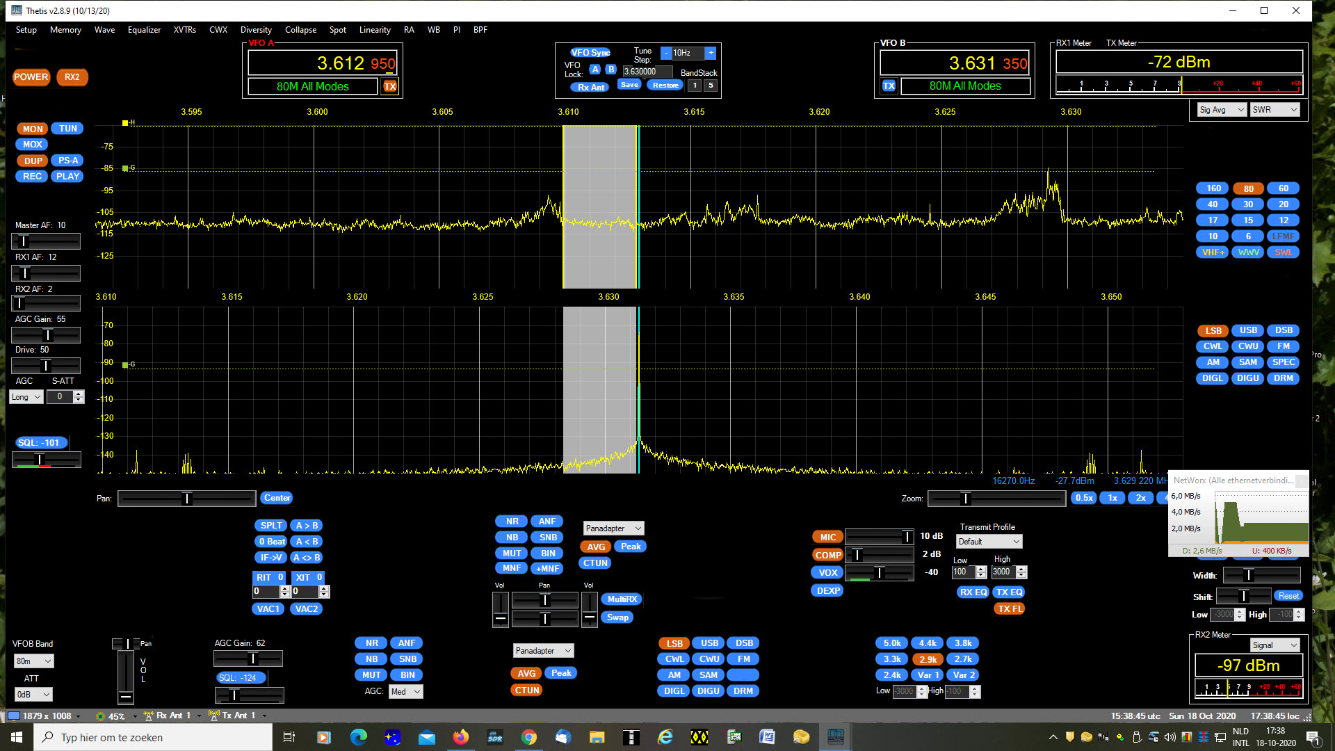

Strange, with OpenHPSDR mRX PS V3.4.9 everthing with RX2 working well.
Also try the Thetis x86 version but with the same result,RX2 don't work.(see picture above)
Walter.

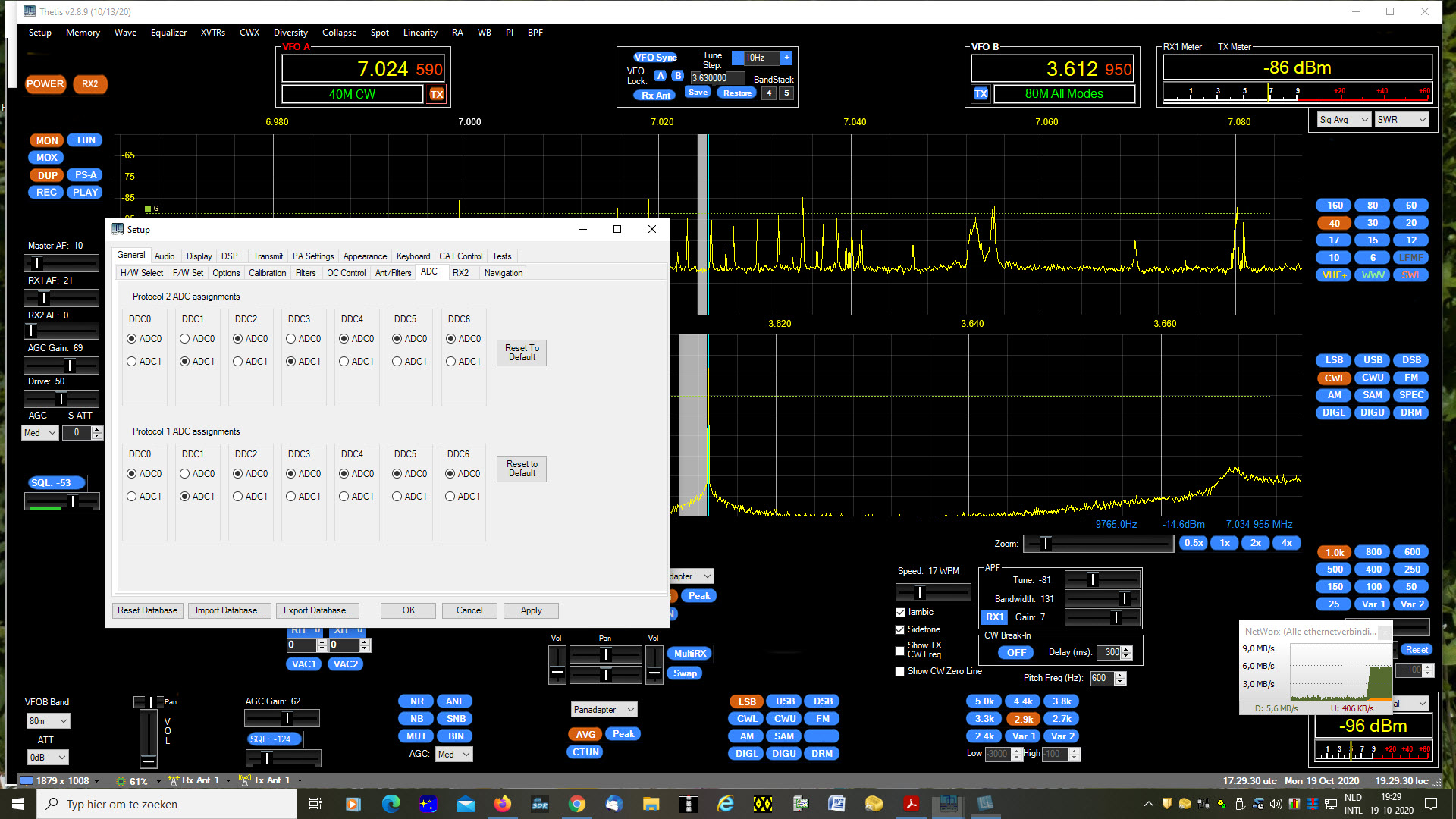

Have you checked the ADC assignments in the setup window? There is a separate set for protocol 1 (because the default settings are different from protocol 2) and a button to reset them to default settings.
Laurence Barker G8NJJ
PA0ALW-Walter
Posts: 8
Joined: Sun Apr 09, 2017 6:00 pm
Location: Terneuzen, Anan-10
Re: Thetis 2.8.9 Released!
Post by PA0ALW-Walter »
laurencebarker wrote:Have you checked the ADC assignments in the setup window? There is a separate set for protocol 1 (because the default settings are different from protocol 2) and a button to reset them to default settings.
I have try several settings also the Default for Protocol 1on my Anan10 (16bits) but still the same.
I have noise from the speaker but no hf signal as you can see .
See the spike in the middle, its always visible in the middle when i switch to several bands.
73,Walter
