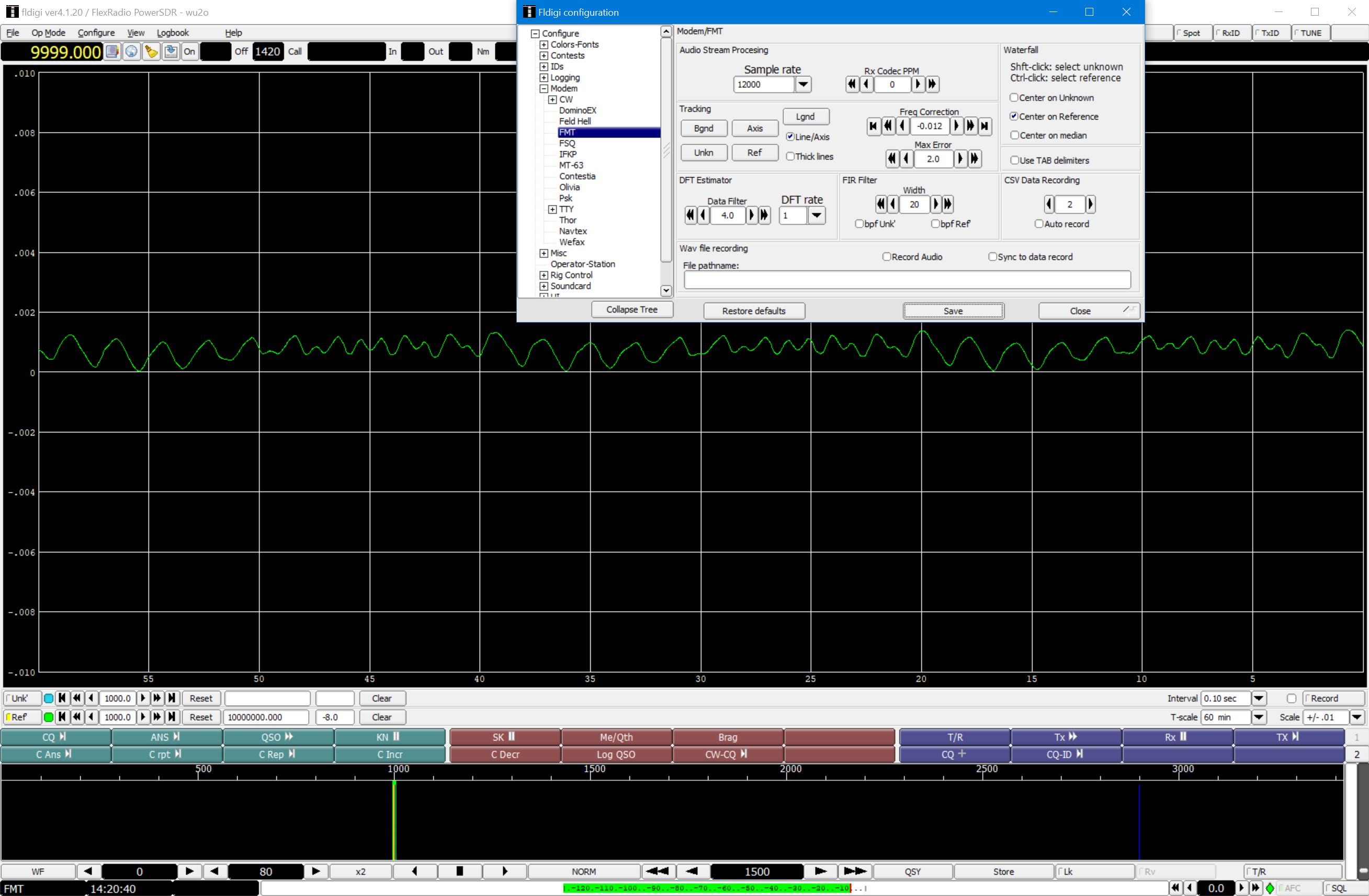

This is with 21k6
I'm using FLDigi's FMT mode to track my GPS to see the practical effect of these settings.
#1 One problem is the Buffer Size and Buffer Latency checkboxes are not being saved so have to change them on every restart of Thetis.
#2 Takes about 3 minutes to get close to where it should be...seems this could be faster so maybe the slew rate can be increased. I'll experiment
#3 I'm seeing a couple of transients which you can seen in the FLDigi data -- they coincide with a jump in the plot in Thetis. I'll have to capture one of those.
#4 Since I turned of Window buffer cache flushing I've had virtually no dropouts and been able to drop buffer size to 64.

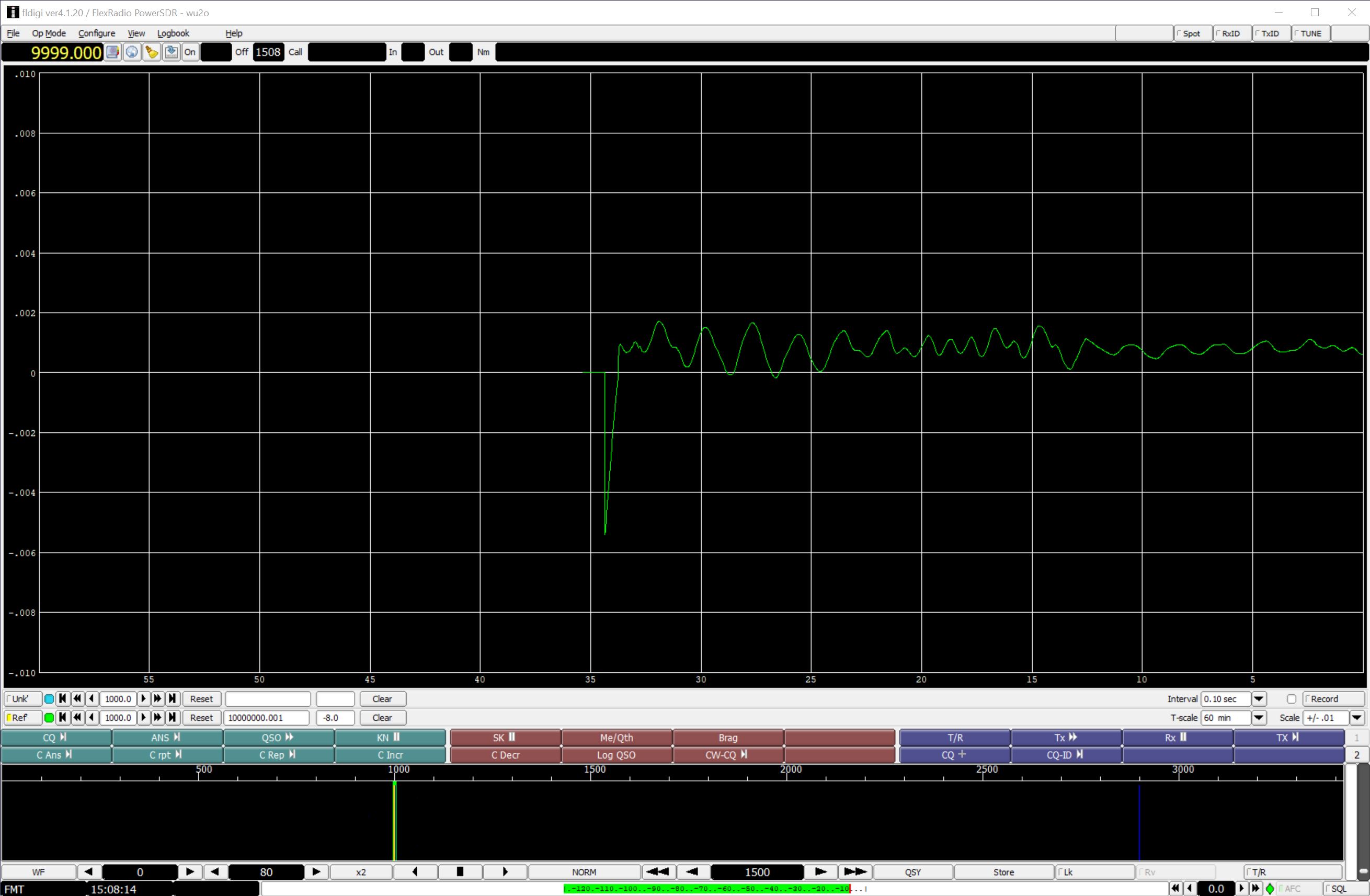

Caught one of the transients
Looks kind of like a bit flip from negative to positive
This was about 3 minutes after startup.

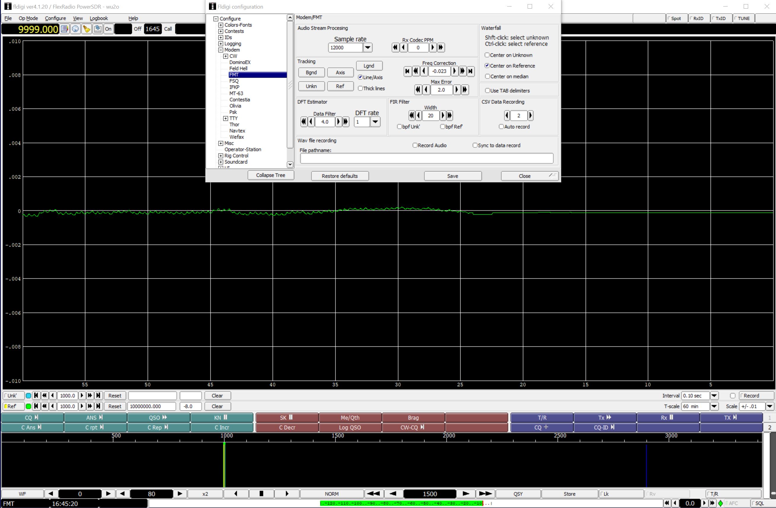

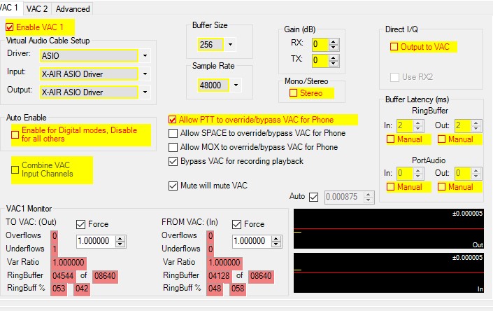

30 minutes with Force checked shows how stable things can be. Just one small burp of around 50mHz accuracy for some reason.
So the drift in the resampler needs to be looked at. Could this just be accumulated error? With 15 significant digits is there some scale difference in the resampler that may be hitting the 15-digit precision?

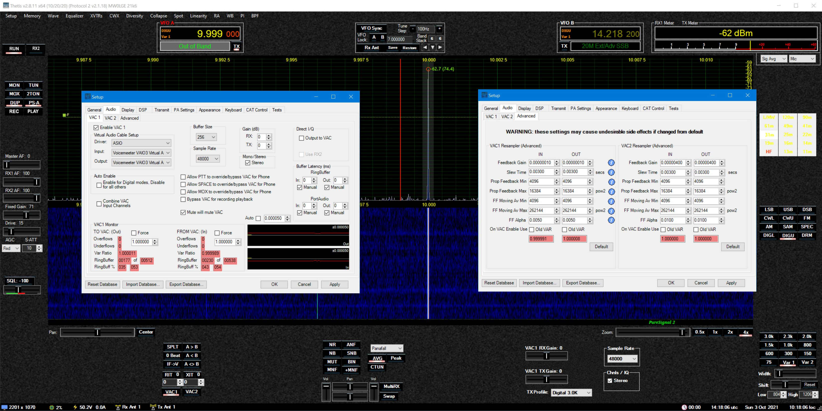

I got serious today and took a few hours of data. As before, my setup used a Mini Circuits hybrid splitter to split my BG7TBL GPSDO output so it could continue to feed the 8000 reference input and, after putting on a big attenuator, also feed the Ant 1 input at -63dBm. The Bodnar GPS reference was available to the Presonus audio interface, and the fldigi FMT feature was again the measurement device.
Thetis setup is as shown below (that's a composite image, not some special dual settings display :) ). Nothing crazy in the VAC advanced settings, just slowing down the feedback gain and FF alpha settings a bit from the default to gain better stability. Some step attenuation was added to lower IMD from the GPSDO 10MHz, and the passband was restricted to lower noise.
The computer was used for light web browsing while these experiments were taking place. No special measures were taken to restrict operating system activity.
If you right click any of these images and select "Open image in new tab" you will get them full size for easier viewing.
Thetis Settings.JPG (1.04 MiB) Viewed 59743 times

I have two PCs both relatively quick with Passmark CPU ratings in the 13,000 range.
I have tried different buffer sizes between 64 and 256.
I have one PC connected to my 7K which is what I had been focused on. I decided to try to apply what I had learned to my ANAN 100 attached to a different and slightly faster PC. That didn't go well.
Below with 256 buffer and ANAN 100.
After the feedback servo stabilizes with ringbuffer between 45 and 55 %, I can reduce the receive ringbuffer size to about 20 before getting over and underruns. Unkeying the transmitter triggers a quick batch of receive over and underruns as the servo is destabilized.
The transmitter ringbuffer is stable during receive and transmit at about 25.
A few minutes ago, I had a VarAC QSO with a station where we exchanged SNR reports of about +15 dB. Exchanges both ways were at the slowest 18 bps rate until I ticked the two Force boxes. Speed shot up to the maximum 270 bps for small chat size messages. I attribute that to the frequency slewing caused by the resampler.
In addition to ARQ, the VARA modem implements good forward error correction. My experiments show no real difference in VARA large message transfer speed or packet error rate with resampler on and stable or off. I think it is time to give up on this one. As an old and tired clock maker, I just want to tell time.
Larry

W6LVP wrote:I have two PCs both relatively quick with Passmark CPU ratings in the 13,000 range.
Each PC will require it's own unique set of setting for the VAC resampler to work well.
I have a very fast computer and use 512. You should try larger values. The penalty for a larger main VAC buffer is very small compared to adding a lot of ringbuffer. Consider that at 48KHz a buffer of size 1024 is only 21ms long.
AFAIK, that behavior has never before been described by anyone. That is a very unique problem and should not occur. TX/RX state should have no effect on VAC performance. It is indicative of some unique problem with your setup. Having never seen this problem before I'm somewhat at a loss to understand it.
My take away is that there are way too many variables to allow one setup to transfer to another.
That is correct.
Is the digital audio clock, typically 48 kHz, derived from a source that is referenced to the 10 MHz input on the back of the radio?
The problem is that there are two clock domains that must share data.
The first clock domain is that associated with the ANAN hardware. Ultimately the 48KHz rate of the audio data delivered to the PC, or accepted from the PC, is tied to the 10MHz reference (internal or external) associated with the ANAN hardware.
The second clock domain is that associated with the PC, and derived either from a clock on a sound interface installed in that PC, or the PC CPU itself.
Thus ultimately you have an audio source & sink at some frequency close to but not exactly 48KHz (clock domain 1, aka the PC clock domain), and another source/sink pair at another frequency close to but not exactly 48KHz and different from the other source/sink pair (clock domain 2, aka the ANAN clock domain). Data must be transferred from one domain to the other. Obviously there will be, by definition, errors associated with that because the two clock frequencies are not exactly the same.
The VAC interface gives you two ways to deal with those errors. Method 1 is to ignore them and let them happen (the force checkbox). Method 2 is to use a resampler algorithm to smooth them out (the resampler). The resampler DOES work, and work for demanding digital modes that require high levels of frequency stability (FMT tests, FT8, etc.). That has been proven beyond any shadow of a doubt in this thread and the other thread I referenced. However not everyone needs/wants/has-the-patience-to achieve that level of performance. If you are getting the results you want with the resampler turned off I suggest you stick with that. However the resampler DOES work, it's just unfortunately a very complex implementation that requires a lot of tweaking.
One thing I just thought of: it's not clear the ASIO implementation in Voicemeeter is stable unless you have an ASIO hardware sound device in the PC. Without an ASIO sound device assigned to the A1 hardware output of Voicemeeter you might be getting an unstable configuration. If you want to continue experimenting you might try switching VAC to WDM-KS. You might need to add in a little portaudio buffer with WDM.
