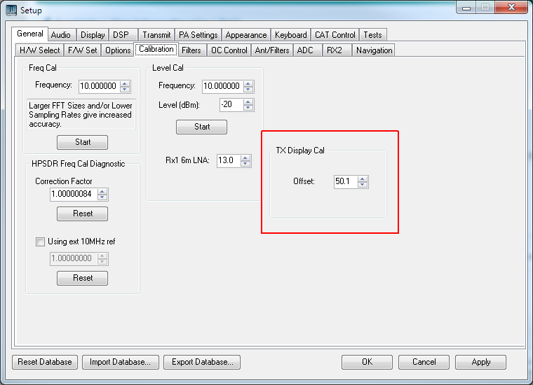

One thing occurred to me is that using an amp and pure signal.....is there anyway of using the pure signal feedback signal to drive a meter and scaling it so that I can look at the actual station output signal ?
Regards Bob
Regards Bob
Re: Thetis v2.9.0.8 - meters and then some more

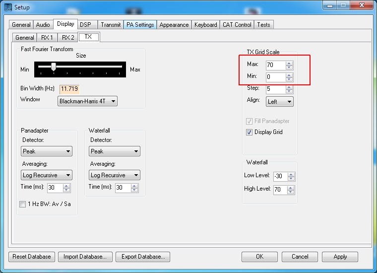

Just calibrate your panadapter!
The value is roughly the attenuation of your coupler, maybe you have to adjust a few dB.
Scale the tx-display and make sure DUP is enabled.
