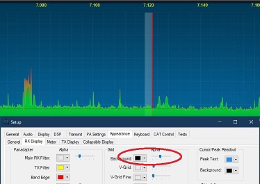

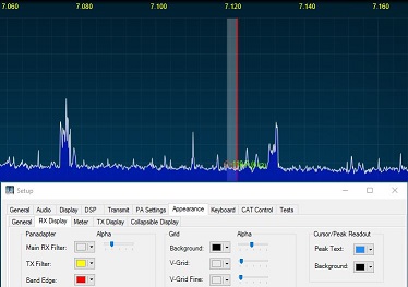

Just noticed that Setup>Appearance>RX Display>Grid>Alpha is not working anymore like it is in 2.8.11.
Any other box/slider works fine.
Compared 2.8.11 and 21k9pre6 side by side. In both versions Disable picDisplay is unchecked. Skin is IK3VIG Special.
Note the grid background. Should be the same on both pics.
I don't know in which version it came up the first time.
Posts: 1588
DH1KLM wrote:Only a small one. ;)
ever since DirectX was implemented I expect. Probably due to draw order. I expect the picDisplay image is over the top of the rectangle fill for the background, where as it was probably the other way around under GDI+ engine. You could use black to 'darken' the picDisplay with some alpha applied.
I will take a look.
Edit: ah yes, that draw rectangle was 'optimized' away recently ;) I will draw it over the top of the picDisplay if one is in use. Thanks !

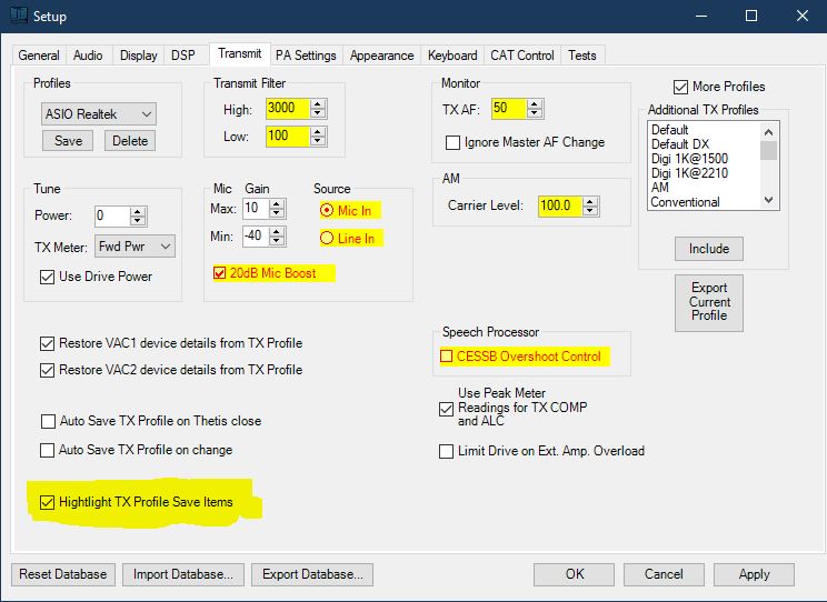

It would be useful if the "Audio" settings were saved to a profile TX
DH1KLM
Posts: 222
Location: Germany
Post by DH1KLM »
This is already the case.
Goto Setup>Transmit and mark "Highlight TX Profile Save Items" and go thru all setup pages to see which parameters will be saved in your profile.
Alexander UC
Posts: 10
Joined: Thu Feb 10, 2022 2:41 pm
Post by Alexander UC »
Thank you, I didn't see the elephant -)

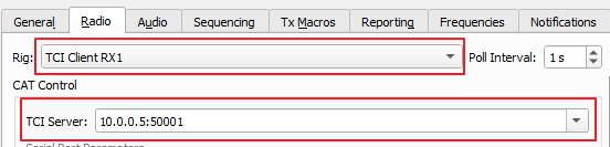

has anyone got TCI working with JTDX software for CAT?
W2PA
Posts: 178
Location: LaGrangeville, NY
Post by W2PA »
ramdor wrote:*** another test release, 21k9pre7
Richie - Switching from AM/SAM or any SSB or CW mode into DIGU/L is still slow, as before (~3 sec). Other mode transitions are fast, including going from DIGU/L back to SAM/AM or SSB/CW.
Note: my DSP options are identical between Digital and phone/CW modes. The only other difference I can think of is that (in my setup) VAC is only used in DIGU/L and no other modes and switches automatically when going in/out of DIGU/L. But even when I uncheck auto enable in both tx profiles and save them, the above switching is still slow.
Everything else working well thus far.
(Edited for completeness.)
Chris, W2PA
Tony EI7BMB wrote:has anyone got TCI working with JTDX software for CAT?
Yes, works perfect.
Thanks Ernst, can you share your settings please as I'm missing a step I think?
Tony EI7BMB wrote:Thanks Ernst, can you share your settings please as I'm missing a step I think?
Thanks Ernst. Its still crashing Thetis so guess I'll wait until its further developed
