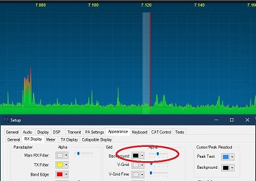

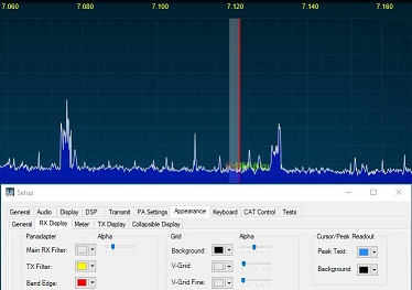

by DH1KLM
Only a small one. ;)
Just noticed that Setup>Appearance>RX Display>Grid>Alpha is not working anymore like it is in 2.8.11.
Any other box/slider works fine.
Compared 2.8.11 and 21k9pre6 side by side. In both versions Disable picDisplay is unchecked. Skin is IK3VIG Special.
Note the grid background. Should be the same on both pics.
I don't know in which version it came up the first time.
Posted: Thu Feb 10, 2022 5:59 pm
DH1KLM wrote:Only a small one. ;)
ever since DirectX was implemented I expect. Probably due to draw order. I expect the picDisplay image is over the top of the rectangle fill for the background, where as it was probably the other way around under GDI+ engine. You could use black to 'darken' the picDisplay with some alpha applied.
I will take a look.
Edit: ah yes, that draw rectangle was 'optimized' away recently ;) I will draw it over the top of the picDisplay if one is in use. Thanks !

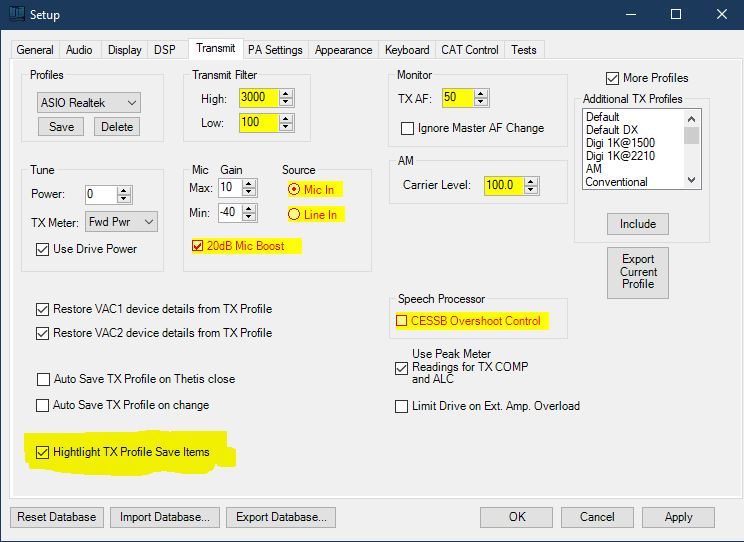

It would be useful if the "Audio" settings were saved to a profile TX
Posted: Fri Feb 11, 2022 12:40 pm
by DH1KLM
This is already the case.
Goto Setup>Transmit and mark "Highlight TX Profile Save Items" and go thru all setup pages to see which parameters will be saved in your profile.

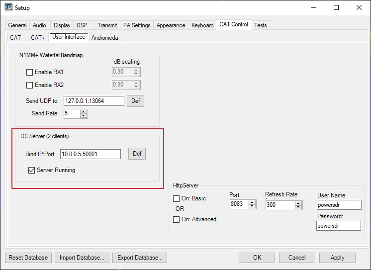

*** another test release, 21k9pre7
Download x64 [md5:9E95862C3A0E45FD205972BC51E7A927] - https://bit.ly/3oN9QaK
TCI options are in CAT->User Interface
Option to disable the 0 beat to mouse is in general options
There is minimal error handling in tci atm, so don't be shocked if it crashes ;) Client count not yet implemented so will always show 0.

by EA1DAV
I see that for TCI the default port is 50001. This is defaul port in Anydesk and also in Icom RSBA. Just to avoid conflicts if someone use this aplications in the same PC than Thetis is running.
73, Jesus

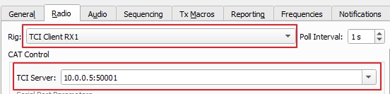

by Tony EI7BMB
has anyone got TCI working with JTDX software for CAT?
Posted: Mon Feb 14, 2022 6:54 pm

by oe3ide
Tony EI7BMB wrote:has anyone got TCI working with JTDX software for CAT?
Yes, works perfect.
Posted: Mon Feb 14, 2022 7:45 pm
by Tony EI7BMB
Thanks Ernst, can you share your settings please as I'm missing a step I think?
Posted: Mon Feb 14, 2022 8:07 pm
by oe3ide
Tony EI7BMB wrote:Thanks Ernst, can you share your settings please as I'm missing a step I think?
Posted: Tue Feb 15, 2022 9:34 am
by Tony EI7BMB
Thanks Ernst. Its still crashing Thetis so guess I'll wait until its further developed
