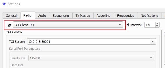

With help from Richie and Ernst I now have JTDX running for CAT and PTT. Thanks guys

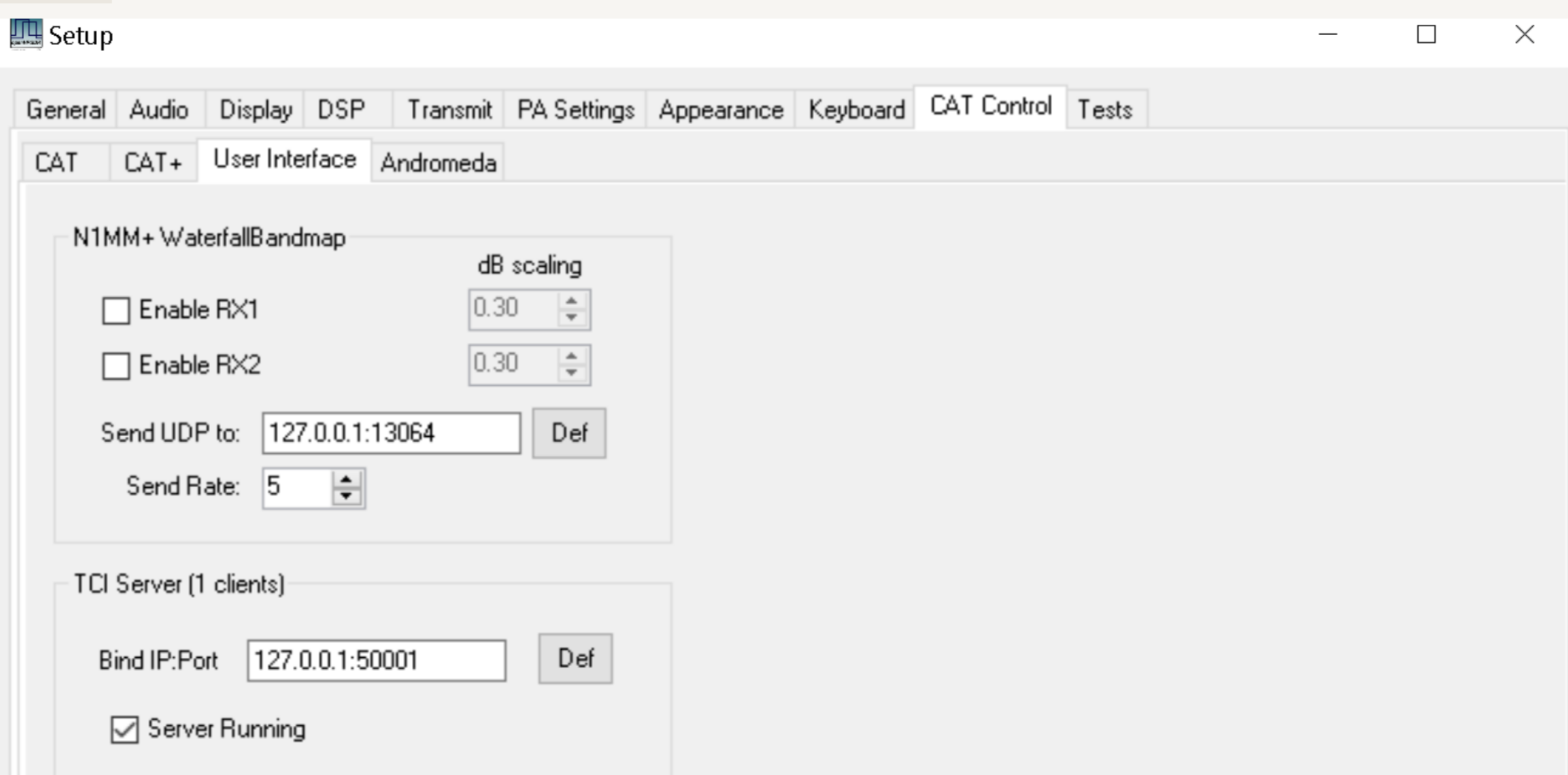

w2ner wrote:Screen Shot 2022-02-15 at 10.47.05 AM.pngRichie
Did you move the TCI settings off the user interface tab?
In the same place here on K9 pre 8

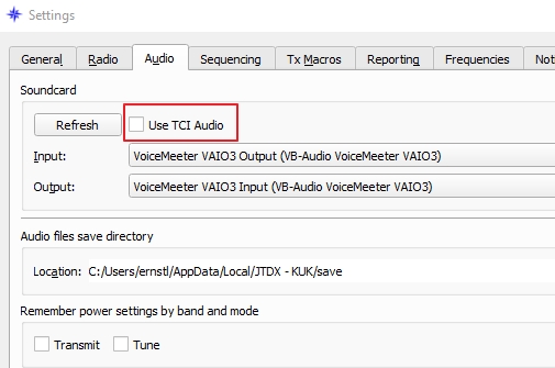

Problem. When communicating with TCI, JTDX does not work for transmission through VAC. Reception is working. When the settings are changed to CAT, transmission via VAC is resumed.
Posted: Tue Feb 15, 2022 8:04 pm
by oe3ide
RU6AI wrote:Problem. When communicating with TCI, JTDX does not work for transmission through VAC. Reception is working. When the settings are changed to CAT, transmission via VAC is resumed.
Do you have TCI-Audio enabled? That would not work. TCI-Audio is not implemented yet.
Activating TCI as transceiver interface (instead of OmniRig or hamlib) has no influence on the audio in/output.
Posted: Tue Feb 15, 2022 8:12 pm
by RU6AI
No... Everything is the same.
Posted: Tue Feb 15, 2022 8:15 pm
by RU6AI
When I switch the transceiver control to TPI, the audio signal for transmission disappears. Everything is fine with the reception. As soon as I switch back to CAT, everything returns to normal. I don't change the AUDIO settings
Posted: Tue Feb 15, 2022 8:24 pm
yep make sure use tci audio is checked off, and you hit refresh to get the audio devices listed, then select suitable ones
Posted: Tue Feb 15, 2022 8:29 pm
by RU6AI
That's exactly what I did .. I did not connect AUDIO TCI and did not change anything ..
Posted: Tue Feb 15, 2022 8:33 pm
vac is set correctly in Thetis? Mute the vac? gain level? rx1 af level ? Line 1 + Line 2 set the correct way around to match the in/outs?
Posted: Wed Feb 16, 2022 5:34 am

Yes..When switching to CAT everything works fine.
Posted: Wed Feb 16, 2022 6:29 am
RU6AI wrote:Yes..When switching to CAT everything works fine.
cant explain it, works fine here. TCI audio off in JTDX, and audio devices set to match those in Thetis.
Posted: Wed Feb 16, 2022 6:37 am
by RU6AI
Ok. Most likely something local .. I have.
Posted: Wed Feb 16, 2022 6:46 am
RU6AI wrote:Ok. Most likely something local .. I have.
latest JTDX?
Posted: Wed Feb 16, 2022 8:59 am
by RU6AI
JTDX 2.2.158
Changed the VAC program. Did not help.
Posted: Wed Feb 16, 2022 9:17 am

@RU6AI - I cant explain it. If you set the vac device in Thetis to headset/speakers do you hear ft8 signals? If all else fails. RX levels are up, mute is off, AGC level is ok etc etc, then back your database up and try a fresh one. Stranger things have happened.
Posted: Wed Feb 16, 2022 9:27 am
by oe3ide
TDX 2.2.158
just some ideas:
* maybe you have enabled mute? (mute works now also on VAC)
* is it only rx or also tx
* do you get audio (power out) when pressing "Tune" in JTDX
* do you "see" audio going out in Voicemeeter when pressing "Tune" in JTDX
Posted: Wed Feb 16, 2022 9:32 am
by RU6AI
Yes .. The same is not clear. It shouldn't be, but for some reason it is. On a regular CAT, everything works properly. I will sort this out. Thank you.
