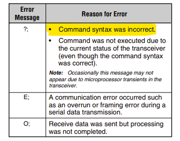

The TS-2000 spec defines the following :
http://manual.kenwood.com/files/B62-1221-70.pdf
page 114
So it entirely feasible, by the spec to send the following :
ANYoldJUNK;
When 21k9 goes out that # enclosed, semi colon terminated string, will probably also include Thetis version number. I can include yet another option to turn it off in setup so that poorly coded parses that do not correctly handle 'command syntax errors' and return ?; carry on working. However, it is not being removed as I have need for it.

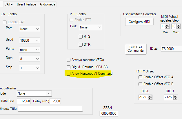

Are you telling me that you have problems if you have a 'syntax error' message arrive unexpectedly? Wow, blimey. Like I said, there will an option to turn it off and not send it.
Thetis does have kenwood AI 'support', although am not sure it is switchable via cat. There is a checkbox option for it already in the CAT tab to 'broadcast' frequency and vfo changes. I noticed the code not long ago.

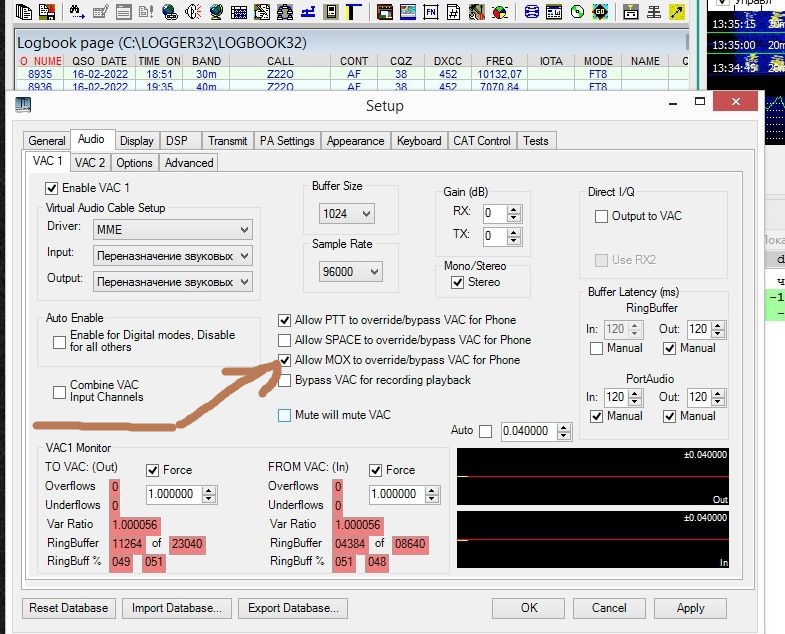

Hello ! Sorry, there was an extra tick due to inattention. There was no transmission with her when controlled via TCI. After removing the checkmark, everything started working normally. Once again, sorry for the inattention.
- 334444.jpg (193.35 KiB) Viewed 24592 times

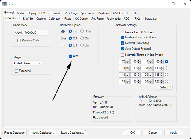

I am not sure how this is supposed to work, but if I un-check Alex in the Setup => General Tab, then re-checking it does not re-enable it. I have to close and re-open Thetis in order to turn it back on.
I am using a 7000, P2, and 21k9(rc1)
Thanks for all your amazing work! It is appreciated.
-Rick, W1RHS
-Rick, W1RHS

Not sure if this is valuable or if there is a fix or not for me. I use Maclogger and if I use TCI it will read the data and display the correct information. It will also change modes, but will not change frequency or bands. When I try and change freq, Maclogger will display the correct changed frequency in its display but within 10 sec it changes back to what Thetis was showing originally. Connecting via the RS232 port, it works great but not TCI. I have Thetis running on a Windows 10 machine and I run maclogger on my Imac M1. Connection is via a RS232 port on both machines and using a null modem cable.
DDS and IF values into Thetis are not implemented as yet which can be suppled through TCI from external software. This is probably the issue. Essentially dds becomes the centre frequency, and the if is the shift from there.w2ner wrote:Richie
I will get around to it shortly. TCI implemented the vfo message in the last couple of years or so, which I am using currently.

Recorded a short video.ramdor wrote:Not possible for spectroscope to change augoAGC noise floor compensation. The process is only performed once per frame, either in panadapter code, or in waterfall code, no where else.Alexander UC wrote:Adjusting the spectroscope bin width affects auto AGC.
The set gain RX of the VAC after rebooting the software is lost. After restarting the program, my -20dB settings sound as loud as 0dB. To return - 20dB the setting, it is enough to change 1 dB . Perhaps this is an old mistake.
Perhaps you haven't saved your gain settings by saving the tx profile?
I change the window of the spectroscope, along with it the AGC of the receiver changes.
After starting the program, gain RX = 0 dB, and does not depend on your settings. The settings will only take effect after an adjustment of at least 1 dB. Pay attention to the power of the sound.
https://youtu.be/ny-plqeSH40
@Alexander, thanks for the video. I have not been able to replicate the issue with the vac gain, but I have fixed some code related to vac2 rx/tx sliders shown when in digi u/l. Please could you send me your database.xml from C:\Users\<user>\AppData\Roaming\OpenHPSDR\Thetis-x64
Regarding the auto noise compensation and the AGC shift when you change FFT width and/or sample rate I have made some changes which have improved things. Please see video : https://youtu.be/hFSReBhhbjA
Those changes will be in rc2, which wont be out tomorrow, but sometime later in the week/next weekend.
