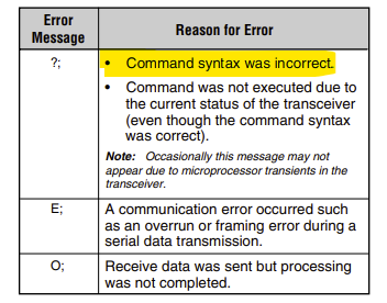

Well I will have to disagree with your disagreement ;)
The TS-2000 spec defines the following :
http://manual.kenwood.com/files/B62-1221-70.pdf
page 114
So it entirely feasible, by the spec to send the following :
ANYoldJUNK;
When 21k9 goes out that # enclosed, semi colon terminated string, will probably also include Thetis version number. I can include yet another option to turn it off in setup so that poorly coded parses that do not correctly handle 'command syntax errors' and return ?; carry on working. However, it is not being removed as I have need for it.

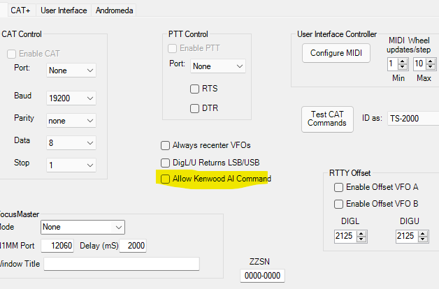

Posted: Thu Feb 17, 2022 11:54 pm
Are you telling me that you have problems if you have a 'syntax error' message arrive unexpectedly? Wow, blimey. Like I said, there will an option to turn it off and not send it.
Thetis does have kenwood AI 'support', although am not sure it is switchable via cat. There is a checkbox option for it already in the CAT tab to 'broadcast' frequency and vfo changes. I noticed the code not long ago.

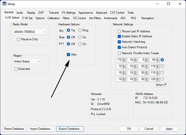

by WR1S
I am not sure how this is supposed to work, but if I un-check Alex in the Setup => General Tab, then re-checking it does not re-enable it. I have to close and re-open Thetis in order to turn it back on.
I am using a 7000, P2, and 21k9(rc1)
Thanks for all your amazing work! It is appreciated.
