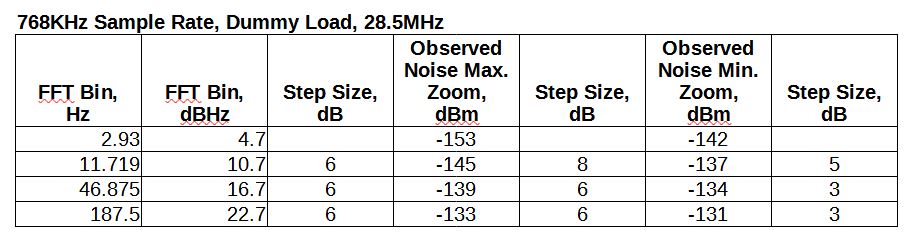

ramdor wrote:@Alexander, thanks for the video...
Richie: one moment, please. Let's make certain that the panadapter display remains correct.
The noise power in a given FFT bin depends on the bin width. An "x" dB change in bin width should equate to an "x" dB change in noise power.
Using the Auto-AGC level line, which accords very well with my "eyeball" of the noise floor (it's really a very handy little line :) ), and a little averaging just to make things a bit more accurate, I made the following measurements:
As you can see, at maximum zoom (smallest frequency range on panadapter), the increases in noise power match very well with the increases in bin size, just as they should. There's some kind of 2dB bobble in that first step which I can't explain (maybe Warren can?), but the additional steps accord well with theory. Whatever changes you are making should not disturb this behavior.
It's worth noting that at minimum zoom (largest frequency range on panadapter), there would appear to be some scaling going on in terms of bins per pixel, but I'm not sure I understand the math or if it is correct. In the RF instrumentation world a spectrum analyzer would display a value called "resolution bandwidth" that would define what unit bandwidth the displayed noise power should be referenced to. Again, another question for Warren, perhaps, and ultimately it would be good to determine this number and display it in the status line directly under the panadapter.
Note also that maximum zoom under these conditions gives a panadapter bandwidth of approx. 7.06KHz, and minimum zoom gives a panadapter bandwidth of approx. 706KHz.
Window size, i.e. absolute number of pixels, seems to make no difference.

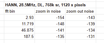

@scott, "Whatever changes you are making should not disturb this behavior". It wont, it has nothing to do with it as it is just a change to the the auto adjusted AGC gain based on the 'noise floor'. The display, fft sizing, fft bin width etc, are not touched.
The display data is already offset according for a number of things including hard coded dB offset values based on hardware, alex offsets, preamp offset, 6m offset, calibration offset. This display data is used to generate the noise floor, and thus pre-offset. The auto agc function was then incorrectly offsetting again, and using the fftoffset incorrectly. I could change it to not use the adjusted data at all, but easier at this stage to to remove the adjustment for the time being.
So now, after the fix. the offsets from all those adjustment above are removed from the noise floor calculation, the shift applied that you specify in the AGC noise floor comp config, along with the fft size offset, and then a new gain is calculated.
For ref, I get the following,
Yes the x resolution of the display area has seemingly zero impact on the data. Extreme decimation (general->refresh rates) does, but that would be expected as the data set reduces.
DL2XY wrote:It's not only binwidth, it also depends on window function and detector characteristics.
One can find a good overview including math by this link: https://www.ap.com/technical-library/ff ... for-noise/
Thanks, Walter, I'm very familiar with the math overall. It's just not clear to me what sort of resolution bandwidth scaling is going on in the WDSP and/or Thetis code as zoom level changes.
BREAK
ramdor wrote:@scott, "Whatever changes you are making should not disturb this behavior". It wont, it has nothing to do with it as it is just a change to the the auto adjusted AGC gain based on the 'noise floor'. The display, fft sizing, fft bin width etc, are not touched.
Perfect!
Yes. As you might remember we discussed all this some time ago, especially with regard to how auto-AGC interacts with changes to the attenuator. But as this was specifically addressing FFT bin width I was concerned about that, and only that.
Better linearity than I got with my measurements! :D

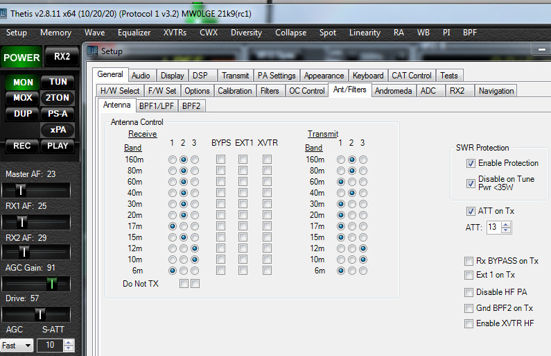

Yevgeni wrote:Hi
It is not possible to set the desired value of the RX1 attenuator for transmit mode. Always set to 31 dB.
For RX2, too, at the time of transmission, there is always a setting of 31 dB. Not very convenient for transmitting on one band and receiving at that moment on another.
yes Yevgeni, the attenuation stuff really needs stripping out and re-doing. A quick look, and it seems 31dB is being applied if auto atten is on, PS is switched off OR you are in either CW modes. This might be a change related to QSK, or a hack to add max attenuation for PS in case it is turned on? I am not sure, it was in version 2.8.8 but not in 2.8.7.
Yevgeni
Posts: 58
Post by Yevgeni »
ramdor wrote: This might be a change related to QSK, or a hack to add max attenuation for PS in case it is turned on? I am not sure, it was in version 2.8.8 but not in 2.8.7.
When the PS mode is on, ATT is controlled by the program. Everything is clear here.
In other cases, the user should be able to set the ATT value for RX1 and RX2 to any desired value during transmission.
If there is time and desire for this. Thanks..
Posts: 1588
It would have been added the for a reason. I expect if that was taken out we would have lots of AGC overload posts here. Somewhat concerned about just removing that, although I can't see any point having user adjustable TX attenuation with it there.
Set to 31
If PS-A is OFF
or mode is CWL/CWR
when TX is enabled
Somewhat odd.
Yevgeni
Posts: 58
Post by Yevgeni »
Hi
It's just that no one is working on transmission on one band and at the same time has normal reception on another band. And when there is an ATT of 31 dB during transmission, then a sensitivity dip occurs on a different range.
Sorry for my questions if they distract from the case.

Yevgeni
Posts: 58
Post by Yevgeni »
Sorry, I'll try my idea again.
How to eat now
Check box "ATT on TX"= ON
receive S-ATT RX1=ab transmit S-ATT RX1=31
receive S-ATT RX2=ab transmit S-ATT RX2=31
Check box "ATT on TX"= OFF
receive S-ATT RX1=ab transmit S-ATT RX1=ab
It should be
receive S-ATT RX2=ab transmit S-ATT RX2=ab
