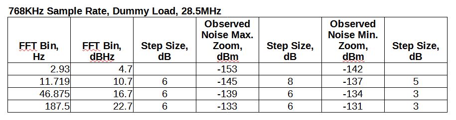

Richie: one moment, please. Let's make certain that the panadapter display remains correct.
The noise power in a given FFT bin depends on the bin width. An "x" dB change in bin width should equate to an "x" dB change in noise power.
Using the Auto-AGC level line, which accords very well with my "eyeball" of the noise floor (it's really a very handy little line :) ), and a little averaging just to make things a bit more accurate, I made the following measurements:
As you can see, at maximum zoom (smallest frequency range on panadapter), the increases in noise power match very well with the increases in bin size, just as they should. There's some kind of 2dB bobble in that first step which I can't explain (maybe Warren can?), but the additional steps accord well with theory. Whatever changes you are making should not disturb this behavior.
It's worth noting that at minimum zoom (largest frequency range on panadapter), there would appear to be some scaling going on in terms of bins per pixel, but I'm not sure I understand the math or if it is correct. In the RF instrumentation world a spectrum analyzer would display a value called "resolution bandwidth" that would define what unit bandwidth the displayed noise power should be referenced to. Again, another question for Warren, perhaps, and ultimately it would be good to determine this number and display it in the status line directly under the panadapter.
Note also that maximum zoom under these conditions gives a panadapter bandwidth of approx. 7.06KHz, and minimum zoom gives a panadapter bandwidth of approx. 706KHz.
Window size, i.e. absolute number of pixels, seems to make no difference.
It's not only binwidth, it also depends on window function and detector characteristics.

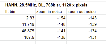

@scott, "Whatever changes you are making should not disturb this behavior". It wont, it has nothing to do with it as it is just a change to the the auto adjusted AGC gain based on the 'noise floor'. The display, fft sizing, fft bin width etc, are not touched.
The display data is already offset according for a number of things including hard coded dB offset values based on hardware, alex offsets, preamp offset, 6m offset, calibration offset. This display data is used to generate the noise floor, and thus pre-offset. The auto agc function was then incorrectly offsetting again, and using the fftoffset incorrectly. I could change it to not use the adjusted data at all, but easier at this stage to to remove the adjustment for the time being.
So now, after the fix. the offsets from all those adjustment above are removed from the noise floor calculation, the shift applied that you specify in the AGC noise floor comp config, along with the fft size offset, and then a new gain is calculated.
For ref, I get the following,
Yes the x resolution of the display area has seemingly zero impact on the data. Extreme decimation (general->refresh rates) does, but that would be expected as the data set reduces.

DL2XY wrote:It's not only binwidth, it also depends on window function and detector characteristics.
One can find a good overview including math by this link: https://www.ap.com/technical-library/ff ... for-noise/
Thanks, Walter, I'm very familiar with the math overall. It's just not clear to me what sort of resolution bandwidth scaling is going on in the WDSP and/or Thetis code as zoom level changes.

ramdor wrote:@scott, "Whatever changes you are making should not disturb this behavior". It wont, it has nothing to do with it as it is just a change to the the auto adjusted AGC gain based on the 'noise floor'. The display, fft sizing, fft bin width etc, are not touched.
Perfect!
Yes. As you might remember we discussed all this some time ago, especially with regard to how auto-AGC interacts with changes to the attenuator. But as this was specifically addressing FFT bin width I was concerned about that, and only that.
Better linearity than I got with my measurements! :D
