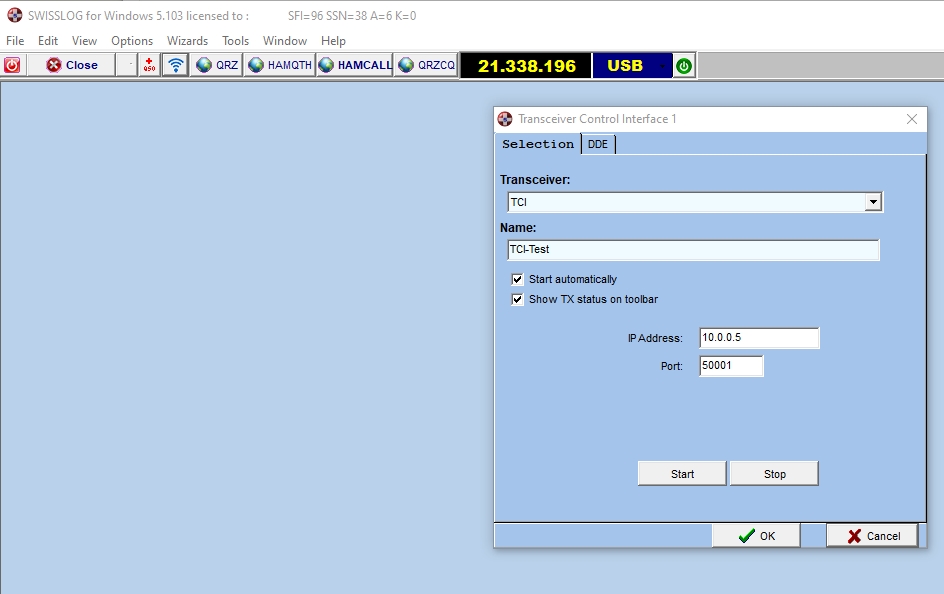

I have a TCI issue connecting Thetis with Swisslog logger (https://www.swisslogforwindows.com/).
If I change band/mode on Thetis, Swisslog follows my changes, but unfortunately it doesn't work in the opposite way from Swisslog to Thetis.
Changes on Swisslog are not followed by Thetis
Talked with Swisslog developer and he told me that his program is working fine (both ways) with Sun SDR radios/sofware.
CAT over TCP/IP is working fine with Swisslog.
Any help?
Hi!
Just installed Swisslog 5.103 and made a quick configuration (TCI for Thetis).
Mode change is working in both directions.
Do you use the dropdown in the topbar to change the mode?
swisslog vs thetis.jpg (124.71 KiB) Viewed 22678 times
ea3aqr
Posts: 313
Location: BCN
Post by ea3aqr »
oe3ide wrote:Hi!
Hi Ernst and thanks for testing it!
Yes, the top bar to change the mode works also for me, but when i click on any spot from Swisslog cluster or band maps nothing changes.
No frequency or band change. Seems it is using different commands... see next post

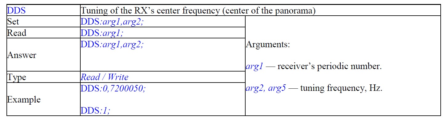

Swisslog developer sent me this:
Are these command working with Thetis's TCI implementation?
I just tested Swisslog + SunSDR.
This is what is sent via TCI on double-click on spot:
dds:0,7115000;
modulation:0,lsb;
DDS: Tuning of the RX's center frequency (center of the panorama)
This is what LogHX is sending:
modulation:0,LSB;
vfo:0,0,7110000;
VFO: Set receiver's tuning frequency
I guess DDS is not implemented yet.
ea3aqr
Posts: 313
Location: BCN
Post by ea3aqr »
oe3ide wrote:I just tested Swisslog + SunSDR.
dds:0,7115000;
modulation:0,lsb;
modulation:0,LSB;
vfo:0,0,7110000;
Ernst,
thanks a lot!
Let's wait for DDS implementation in a future release...

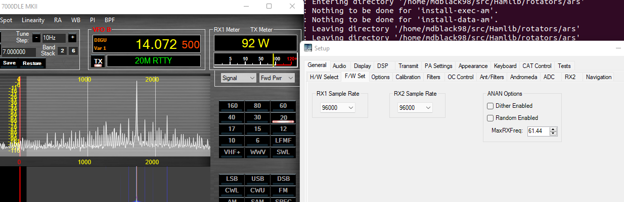

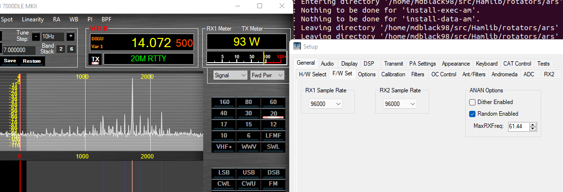

Was just testing Dither and Random on 7000DLE MKII with 21k9(rc1)
Dither seems OK.
Random adds about 40dB to the signal level though....seems a touch high isn't it?
Posts: 1588
@Mike W9MDB, 40dB?, yes you have something very odd going on with your radio, that is for sure. Firmware version?

2.1.18
w9mdb
Posts: 465
Post by w9mdb »
Hmmm...now it quit doing it.
NN3RP
Posts: 70
Post by NN3RP »
Too much processing in the background, maybe?
