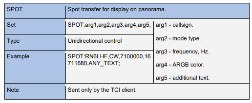

Will be nice to have the option in TCI spots to show the spotter callsign when holding "shift" key like we have on Thetis's spottig system.
That info is not included in the the spot message as part of the TCI protocol unfortunately. The additional text is normally for stuff like 'cq cq dx' etc.ea3aqr wrote:Richie,
I guess 3rd party logging/cluster software that supplies the TCI message to Thetis could include it in the additional argument, but some sort of common approach/format would have to be taken, or EE asked to add a SPOT_DETAILED message with extra arguments.

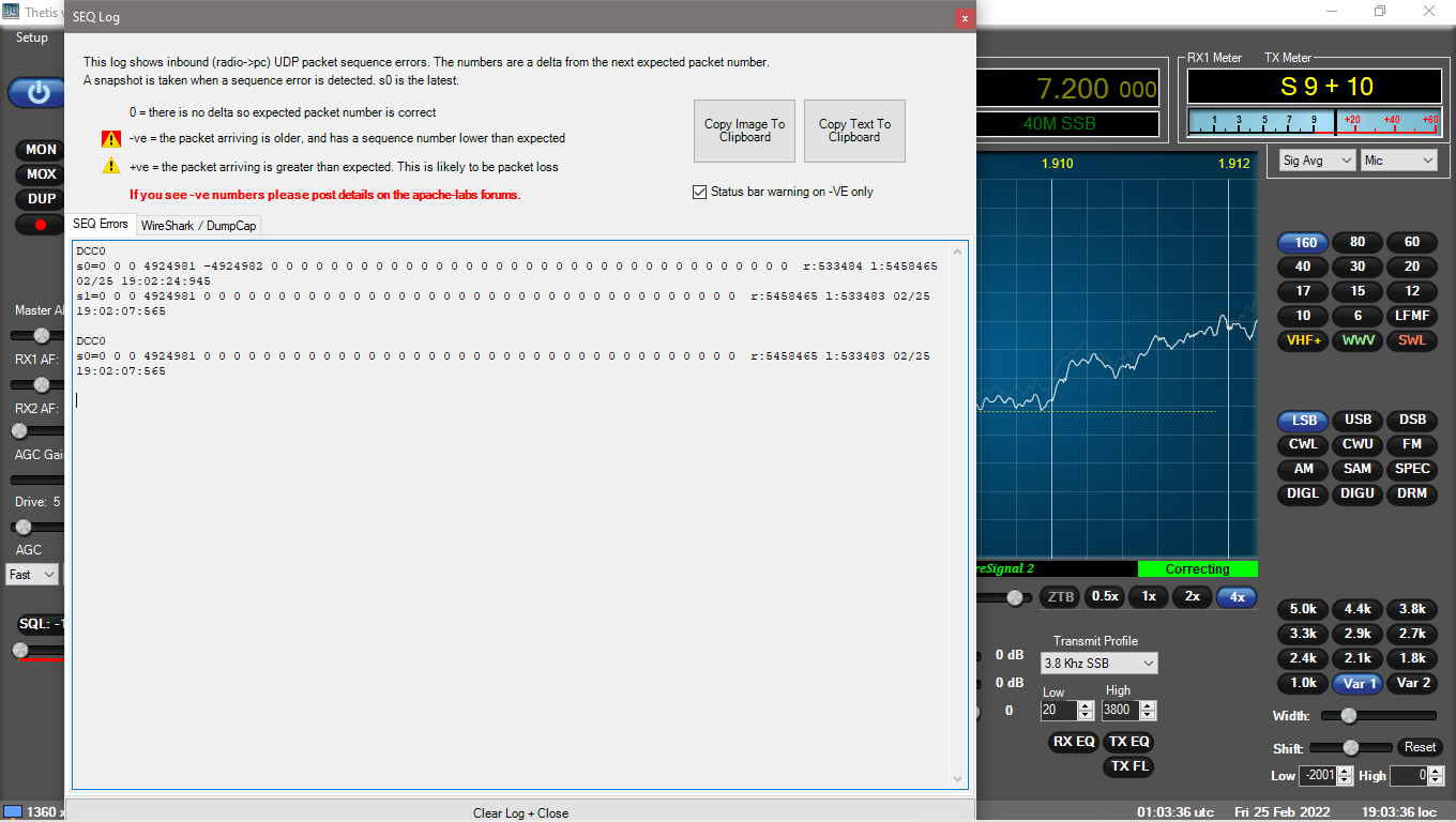

I was just in 160 meters SSB and had the PS engaged and the correction bar was flashing on and off during transmission instead of being on steady.
The att. was at 11db.
I also got an SEQ error alert.
Here it is:
Here it is:

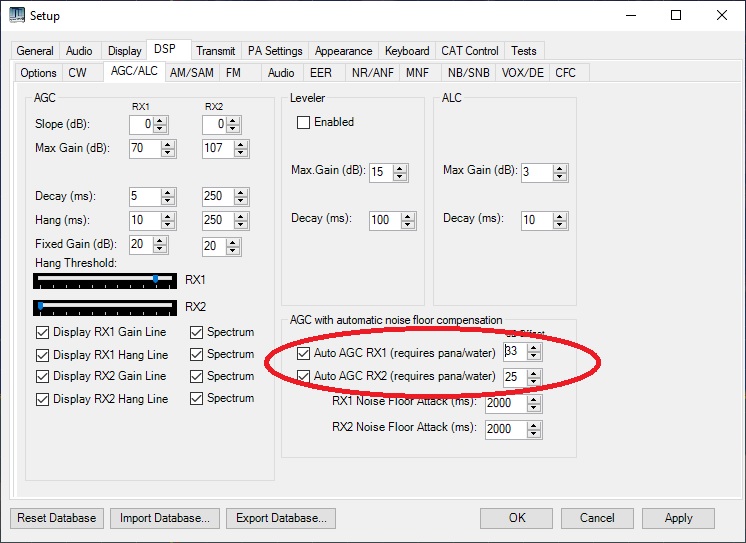

Seems like it's OK here after adjusting the Auto AGC setting in the <DSP><AGC/ALC> menu. See attachment.w2ner wrote:I'm seeing the same thing.NC3Z wrote:Ritchie, can you take a look at Auto AGC in rc2. The offset now seems to be way off, needs way more offset in db, not proportional.

I am seeing the same auto AGC offset problem. Increased the offset as a workaround for now
On RX1 At 192KHz sample rate my dB Offset now has to be an addition 12dB, or in other terms 12dB of offset puts the Ga line equal to the noise floor line. And and number below 12dB offset puts the Ga line below the NF line.NC3Z wrote:Ritchie, can you take a look at Auto AGC in rc2. The offset now seems to be way off, needs way more offset in db, not proportional.
On RX2 that offset dB is 24db for above.
Before RC2 the Offset was pretty close to what was expected.
I am seeing the same issue here with the Auto AGC. The offset is way off now, before seemed to be proportional.

After watching the video, my Auto AGC result tracks with yours. In the earlier screen capture, I should have made Rx2 the same as Rx1. My point was that behavior seemed normal upon changing the Rx1 setting after the initial install.
I can't see any differences in the offset. Both RX offset lines/values are identical for me. RX1 and RX2 are both configured identically.

For me, simply stated, before RC2b, a ZERO DB offset used to place the Gain Line at exactly the same level as the Noise Floor line on the panadapter, which made sense to me, The AGC gain tracked the noise floor with a 0 db offset.ramdor wrote:I just can't explain the agc rc2 problem...

Hi Richie, I saw it immediately on RX1 , never tested RX2. To correct I had to increase the offset value from 20 to 43
EDIT; an offset value of 20db puts the AGC line on the noise floor

25db for me, previously it was set to 0dbTony EI7BMB wrote:Hi Richie, I saw it immediately on RX1 , never tested RX2. To correct I had to increase the offset value from 20 to 43

ramdor wrote:That info is not included in the the spot message as part of the TCI protocol unfortunately. The additional text is normally for stuff like 'cq cq dx' etc.ea3aqr wrote:Richie,
What a pitty!
Could you show, at least, ARG5 on the selected spot when holding "shift" key?

Before if you set the dB offset number for Auto AGC in the box for automatic noise floor compensation say 15, then the Green Ga line was 15dB above the noise floor on the spectrum. Now the numbers do not match and are not proportional.
You can raise the dB offset in the box to get the offset but it is around double the original number.
Cecil
W4CM
With RC2B the noise floor is hit at zero offset and is shown 30dB above noise floor with 30 dB offset - but only if Display/RXn/BinWidth is set to the maximum left side. Interestingly regardless of Sample Rate setting with alters binwidth automaticly.NJ2US wrote:For me, simply stated, before RC2b, a ZERO DB offset used to place the Gain Line at exactly the same level as the Noise Floor line on the panadapter, which made sense to me, The AGC gain tracked the noise floor with a 0 db offset.ramdor wrote:I just can't explain the agc rc2 problem...

The effect of auto AGC on AF-Level seems correct in my opinion, but i think the positioning of the AGC line on display is off depending on binwidth setting.
73 Walter
I now see the point offered by Jeff and others. 20 dB of display correction is required for both Rx1 and Rx2 to equal the noise floor when connected to a dummy load. It does seem like a zero value should coincide with the noise floor. Apart from the display discrepancy, Auto AGC is functioning normally.NJ2US wrote:For me, simply stated, before RC2b, a ZERO DB offset used to place the Gain Line at exactly the same level as the Noise Floor line on the panadapter, which made sense to me, The AGC gain tracked the noise floor with a 0 db offset.
Jeff
NJ2US
In rc2-b, G will now move depending upon fft bin widths, just like it does when auto agc is off. It does this to maintain perceived level of audio. If you set minimum fft size and an autoagc offset of 0, G should sit approximately on noise floor in the spectrum view. If you then increase the fft size, G will be adjusted down. There is no way to keep G at noise floor even with a 0dB autoagc shift anymore as it moves depending on fft size.
ramdor wrote:In rc2-b, G will now move depending upon fft bin widths, just like it does when auto agc is off. It does this to maintain perceived level of audio. If you set minimum fft size and an autoagc offset of 0, G should sit approximately on noise floor in the spectrum view. If you then increase the fft size, G will be adjusted down. There is no way to keep G at noise floor even with a 0dB autoagc shift anymore as it moves depending on fft size.
Thank you Richie, your explanation makes sense now, we were all "holding it wrong" (a reference to the infamous Steve Job's antennagate iphone fiasco)
