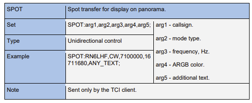

Will be nice to have the option in TCI spots to show the spotter callsign when holding "shift" key like we have on Thetis's spottig system.
Posted: Fri Feb 25, 2022 11:48 pm
ea3aqr wrote:Richie,
That info is not included in the the spot message as part of the TCI protocol unfortunately. The additional text is normally for stuff like 'cq cq dx' etc.
I guess 3rd party logging/cluster software that supplies the TCI message to Thetis could include it in the additional argument, but some sort of common approach/format would have to be taken, or EE asked to add a SPOT_DETAILED message with extra arguments.

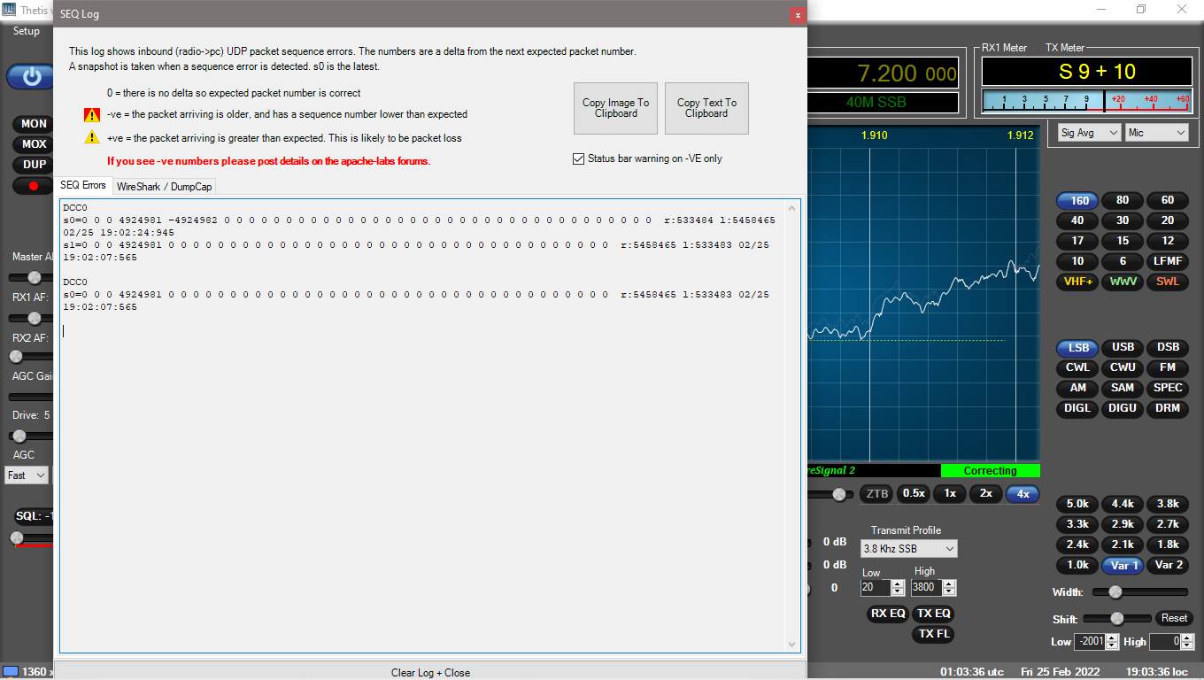

by W9BHI
I was just in 160 meters SSB and had the PS engaged and the correction bar was flashing on and off during transmission instead of being on steady.
The att. was at 11db.
I also got an SEQ error alert.

Posted: Sat Feb 26, 2022 4:26 pm
by ea3aqr
What a pitty!
Could you show, at least, ARG5 on the selected spot when holding "shift" key?
