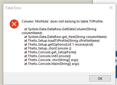

I am attempting to do the latest update to Thetis. I am getting the attached error after copy/pasting the newly downloaded Thetis2_8_11_MW0LGE_21k8_64bit files inot the Thetis install folder as per the video at the top of this thread. Any help is appreciated.

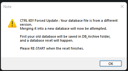

@rdscuba hi, follow the instructions in post1 and it will work. You need to hold CTRL down as you run up the patched version for the first time, this will update your database. Ensure you take a backup first.
You will be presented with the following :
Follow the on screen instructions.

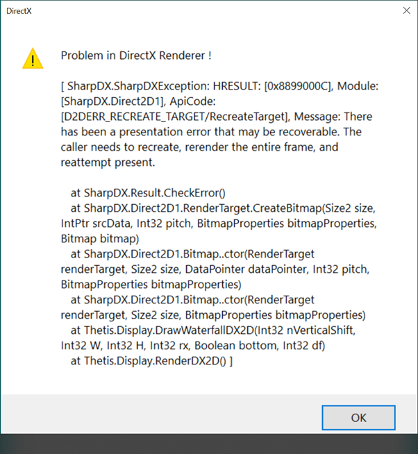

DirectX error message
Thetis 21k9RC2-b has been running fine for a couple of days but this came up this morning after leaving it running overnight. The panadapter and waterfall are blank but otherwise Thetis seems active. Screenshots of DirectX error attached. I had to use Task Manager to shut down Thetis and after this it re-started with full functions restored. I've not seen this before.
73 Dave G3ZQH
73 Dave G3ZQH
- Thetis 21k9rc-2b DirectX error.png (199.18 KiB) Viewed 23176 times
neither have I Dave, could be ...G3ZQH wrote:I've not seen this before.
73 Dave G3ZQH
a) auto update
b) gpu driver crash
c) sleep/awake issue
d) device resolution changes
e) device driver bugs (are you updated to latest)
f) issue in code related to create bitmap (I will have a check later today)
Richie, I'll monitor for now and report if it re-occurs.
73 Dave

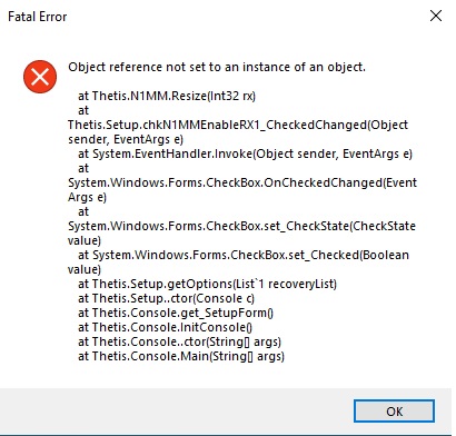

I just patched with release 21k9rc3 and performed a database update as well. I'm getting this error while opening Thetis
@Siddhu Yes that is an rc3 introduced bug by the looks of it. I will get a version out tomorrow to fix that. It is caused by having N1MM spectrum turned on.
You can edit the database.xml file to get around it for now, located here : C:\Users\<user>\AppData\Roaming\OpenHPSDR\Thetis-x64
