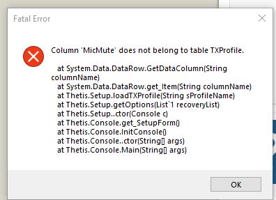

by rdscuba
I am attempting to do the latest update to Thetis. I am getting the attached error after copy/pasting the newly downloaded Thetis2_8_11_MW0LGE_21k8_64bit files inot the Thetis install folder as per the video at the top of this thread. Any help is appreciated.
thetis error.JPG (32.54 KiB) Viewed 23849 times
Posted: Sun Feb 27, 2022 6:46 pm

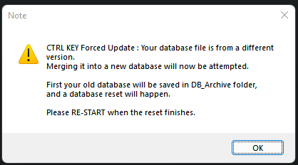

@rdscuba hi, follow the instructions in post1 and it will work. You need to hold CTRL down as you run up the patched version for the first time, this will update your database. Ensure you take a backup first.
You will be presented with the following :
Follow the on screen instructions.
