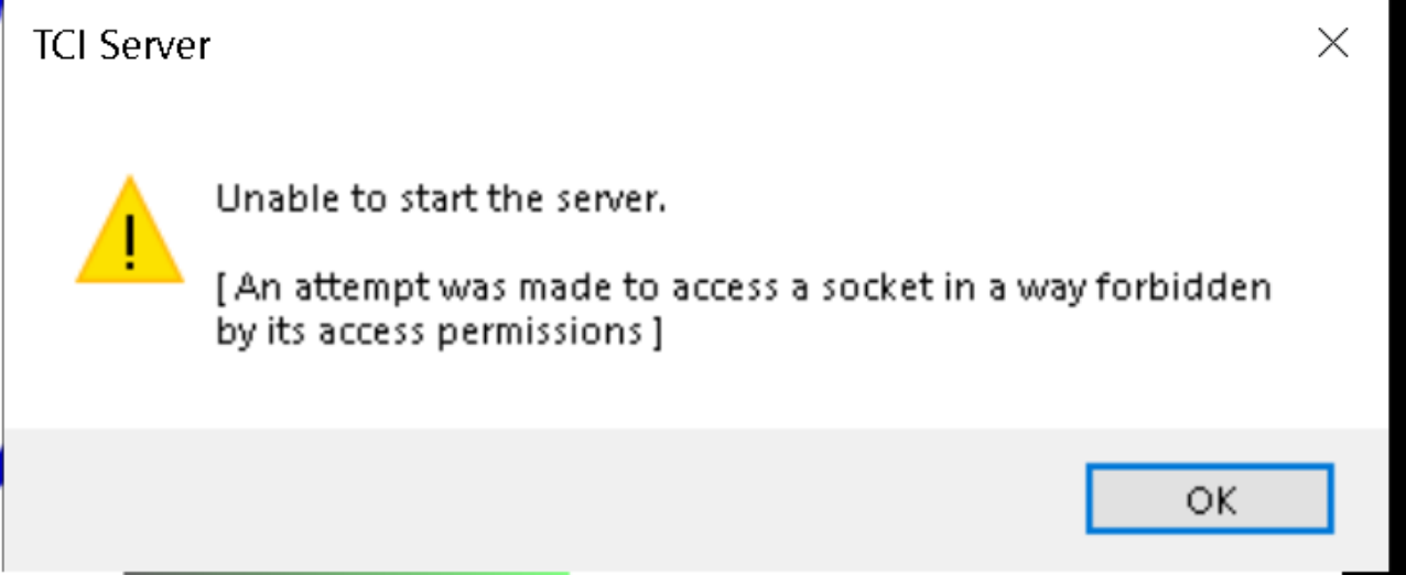

Is anyone else seeing this message on Thetis startup?
Posted: Fri Mar 04, 2022 12:16 pm
might be firewall or might be that port is in use by something else (which is most likely reason)
EA1DAV noticed that 50001 clashed with icom rsba, and anydesk.
Richiie.

Thanks Richie,it does not happen on every start up and re starting Thetis fixes it. Only program I have that uses TCI is JTDX and that is not running when this happens. I've checked the windows firewall and Thetis is an allowed App. I'll un install anydesk as a test in case its doing stuff without being run.
ramdor wrote:might be firewall or might be that port is in use by something else (which is most likely reason)
Richiie.
Posted: Fri Mar 04, 2022 1:02 pm
try...
netstat -o | find "50001"

That command (with JTDX running) shows
C:\Users\ei7bm>netstat -o | find "50001"
TCP 127.0.0.1:50001 DESKTOP-3B6ADBP:50734 ESTABLISHED 18484
TCP 127.0.0.1:50734 DESKTOP-3B6ADBP:50001 ESTABLISHED 9948
Posted: Fri Mar 04, 2022 1:11 pm
Tony EI7BMB wrote:That command (with JTDX running) shows
I assume it is running ok atm? hmm.. let me see if i can find the flag to get the exe names
Posted: Fri Mar 04, 2022 1:15 pm
ok...
tasklist /fi "pid eq 18484"
Will give you the exe name, where the number matches the number at the end of the line when you run
Posted: Fri Mar 04, 2022 1:18 pm
by Tony EI7BMB
Yeah running fine ATM, just needed one re start of Thetis. Guess I need to run the commands again next time the error shows up. Thanks so much for the help
C:\Users\ei7bm>tasklist /fi "pid eq 18484"
Image Name PID Session Name Session# Mem Usage
Thetis.exe 18484 Console 1 281,948 K
