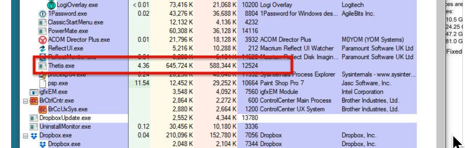

I'm seeing a utilization between 5 - 8% with 177 processes, 2164 threads and 78337 handles, so its running VERY VERY well...
I have a I7 3.5 gig CPU with 32 gig of ram.

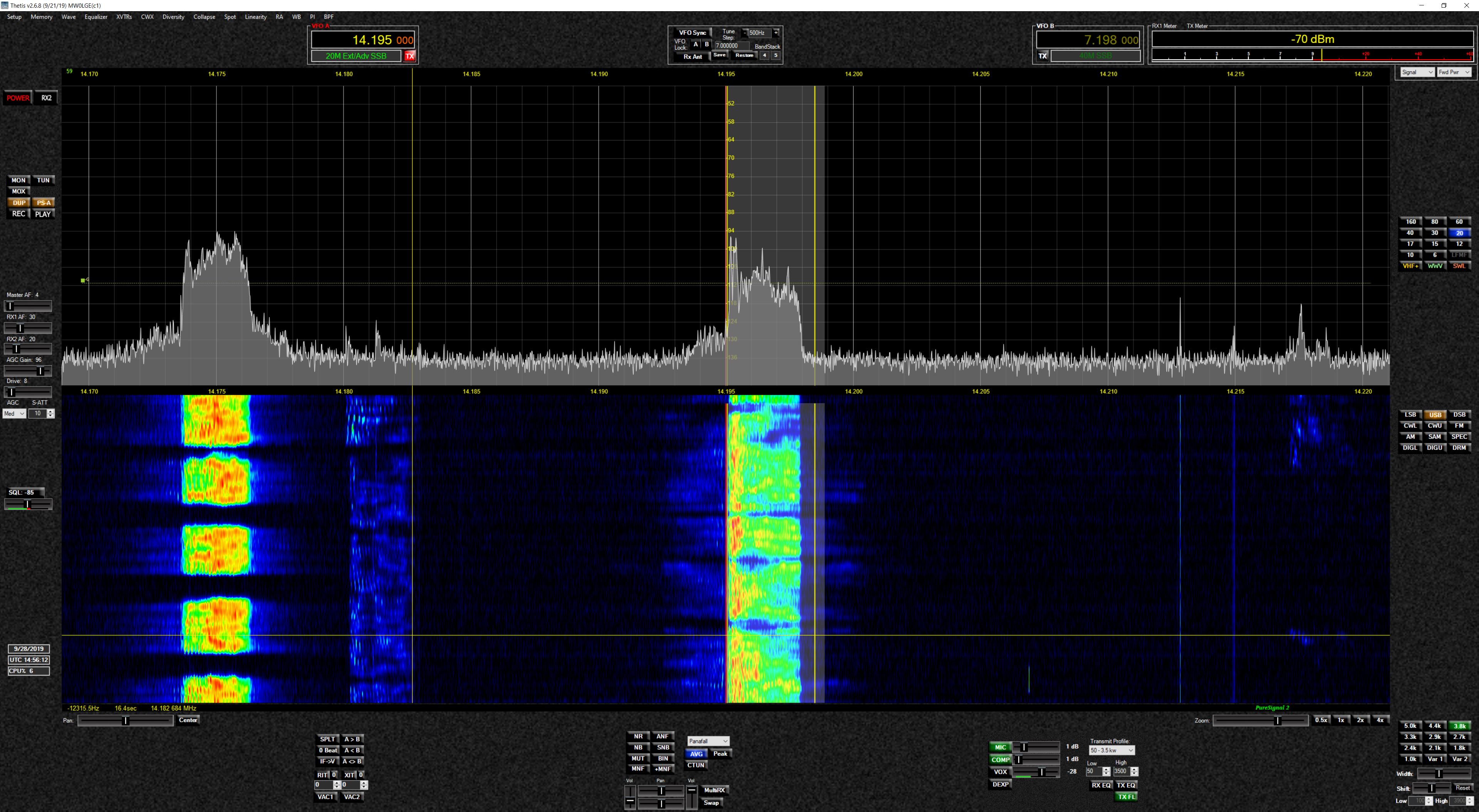

Running c1 full screen on 40" 4k monitor 60fps smoothly...
I did lose the blue panafall background though. Disable picDisplay is not selected.
Is c2 available for download?
[img][/img]
Great job Richie!
[img][/img]
Great job Richie!

40 inch monitor, WOWcLicari wrote:Running c1 full screen on 40" 4k monitor 60fps smoothly...
[img]2.6.8%20c1.JPG[/img]
Great job Richie!

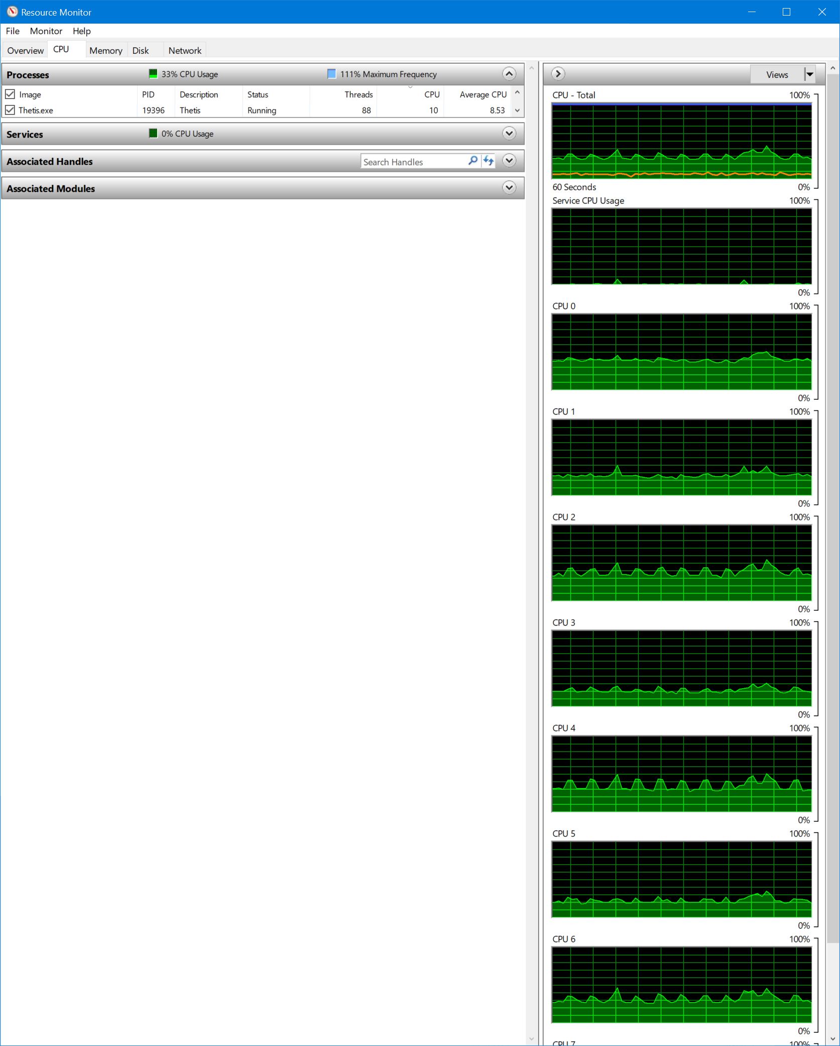

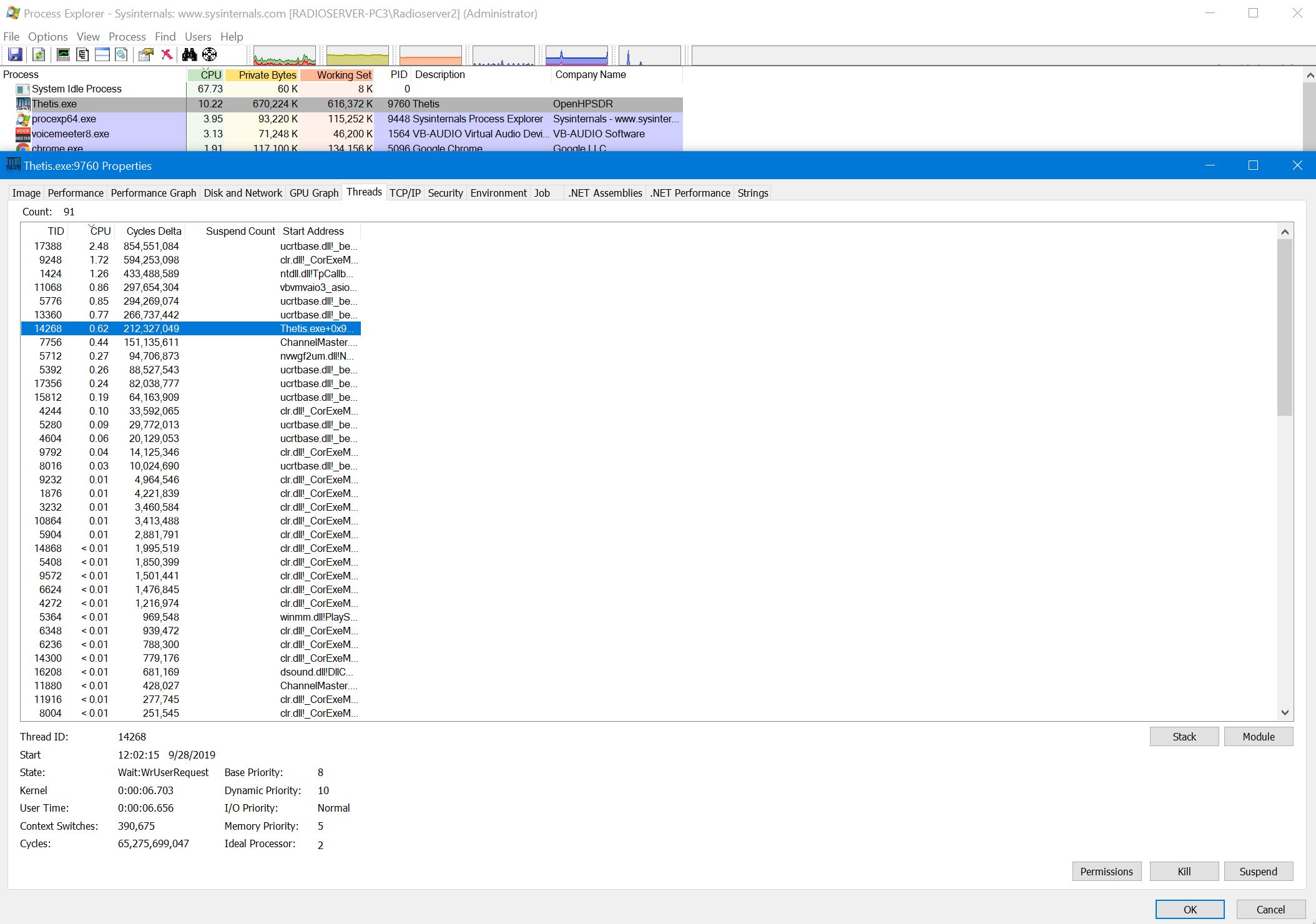

CPU utilization revisited:
The CPU numbers I posted above may be suspect. I was reading about everyone's numbers in the last few posts and getting jealous, as mine were much higher. And I have a cracking machine: i7-7700k overclocked to 5GHz with 16GB of RAM.
I had been using the numbers provided by good old Task Manager, which reports 15% under my normal operating condition (not triple 4K monitor sized window). Meanwhile, Process Explorer reports 10%, and Resource Monitor reports 9%.
Also, Process Explorer and Resource Monitor show minimal variation in CPU utilization with dramatic setting changes. I can run 768KHz on a very large window and the smallest FFT bin size, then change to 384KHz on a small window with a large FFT bin size and see only about a 1% change in CPU utilization. Task Manager will show upwards of a 4% change.
I'm curious what others used to measure CPU utilization. For now, I'm going to be using ResMon or Process Explorer since they are within 1% of each other and generally seem more stable and accurate, particularly ResMon.
In ResMon I note that it goes from 9% to 13% when I activate RX2. This implies 4% per receiver. I've got no idea what thread is doing what, but here are a couple of screen captures for your amusement.
Thank you!
Bryan: a quick perusal of the web says that FFTW is, if not the fastest, among the fastest libraries out there, and I believe that is what WDSP (in channelmaster.dll) uses.
