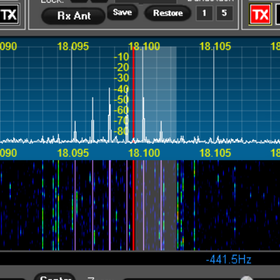

a7 doesn't work here very well on my ANAN 100
Hitting Tune gives a multi tone output as seen in the attachment that my MFJ-998 can't tune with (even though showing 20W it says "increase power" because the power is so spread out.
And doing a Tune from WSJT-X behaves much the same way.

A few of us have observed a "TUNE" anomaly where a wide band spurious signal is transmitted in TUNE WHILE PURE SIGNAL IS ENGAGED. This behavior has been observed in "Pre Richie" versions of Thetis. It is infrequent, but when it happens....it is a wide nasty signal. Disabling PURE SIGNAL before a TUNE sequence fixes it every time.

Some operators report seeing that same multi-tone effect happening if they don't turn off "PS-A" before hitting "TUN".w9mdb wrote:a7 doesn't work here very well on my ANAN 100

You can create a similar tune anomaly by setting your RF drive level very low, at least you can on the 8000. It has been this way for me well prior to Richie's contributions.

The tune issue........ *searches for shrug emoji*
