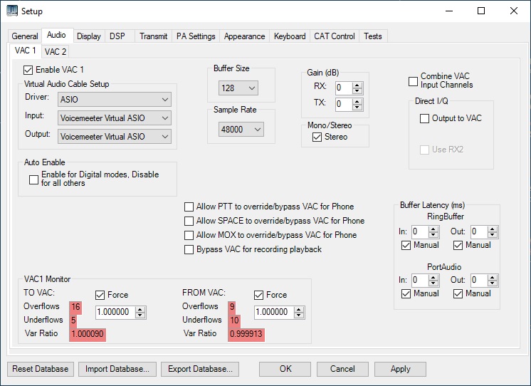

Same experience here, Once VAC channel audio is engaged, I see a brief burst of under/overflows, but with 2.8.11, it mostly stays there for hours without drifting. In prior releases, it would build to several hundred in about an hour. However, none of it affected audio or digital decoding as far as I can tell.Joe-W4WT wrote:I do still see the startup glitch that causes the counters to take off but once I click Manual on Buffer Latency a time or two that solves the problem until the next startup. I also see what others have mentioned regarding Pure Signal not working randomly and a power on reset is required to get it back but this is not new for me.
Voicemeeter ASIO drivers used with a Presonus Studio 192 Mobile, 128 bit Word-locked to a 48 kHz Bodnar GPSDO clocking source. Same source used for the 10 MHz external reference.

Hi Paul,w9ac wrote: Voicemeeter ASIO drivers used with a Presonus Studio 192 Mobile, 128 bit Word-locked to a 48 kHz Bodnar GPSDO clocking source. Same source used for the 10 MHz external reference.
Just curious, why do you use Voicemeeter between Thetis and your Studio 192 Mobile?
73, Bryan
Re: Thetis 2.8.11 Released!
That startup issue with VAC is quite common. I have it all the time.
I use Voicemeeter between my Presonus and Thetis so I can mix/patch two Presonus mic inputs, VAC2, digi mode software, and stuff like that.
