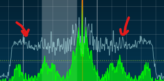

These are how the feedback colours relate to the feedback level.
I would like to swap blue and red. In my mind RED would be too hot, too much feedback level, and blue, too cold, not enough feedback. I didn't change it due to the confusion people would have after getting used to the original. With PS-A, TX Attenuation changes in an attempt to get the feedback level in the green, and as we know having an ALC around 0dB gives PS the best chance.

ramdor wrote:feedbackColours.png
Hi
Agree.
This is logical.

I agree as well on the feedback colors. I'm sure there was a reason but I often wondered why it was the other way. :)

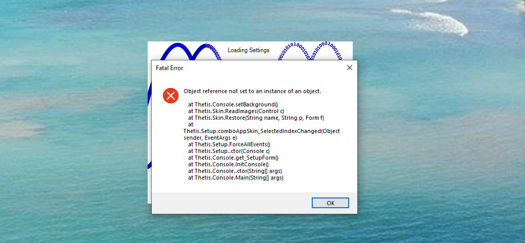

Hello Richie, Can some one help me here. ?
I only have one skin from OE3IDE, I deleted all the other ones
https://apache-labs.com/community/downl ... ew&id=2507
Posts: 1588
yes no doubt caused by the skin not in the folder any more, and Thetis was saved with a skin that is now not there. When setting is applied to the combo, the entry is not found, and... boom. Put the skins back in the folder and will probably start up ok. Something like that anyway. I will add to list.
EDIT: add a [picDisplay.png] to the folder and try that

ramdor wrote:yes no doubt caused by the skin not in the folder any more, and Thetis was saved with a skin that is now not there. When setting is applied to the combo, the entry is not found, and... boom. Put the skins back in the folder and will probably start up ok. Something like that anyway. I will add to list.
Well, I'm in trouble because I deleted for good those out of the trash bin, now what can I do ?
Posts: 1588
if picDisplay.png is in the skin folder you are using and not missing, then...
edit your database.xml, and make sure that
Code: Select all
  <Options>
    <Key>comboAppSkin</Key>
    <Value>IK3VIG Special</Value>
  </Options>
matches the folder name of your skin
EDIT: or use this temporary exe, it should get around the issue... https://bit.ly/3KltZNx

ramdor wrote:if picDisplay.png is in the skin folder you are using and not missing, then...
Code: Select all
  <Options>
  </Options>
Richie, what you just send me goes in
This PC> Local Disk(c:) >Program Files > Thetis
I'm so frustrated with my self right now
Thank your for your help

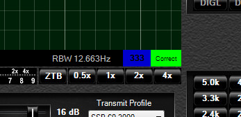

Some feedback on RC4B, mostly esthetic/UI related:
- Having the blobs and peak options as buttons on the main UI like that makes so much sense and has been a long time coming.
- To that end, recommend renaming "Show MHz on Cursor" to "Show cursor marker information" and putting a button next to the peak button labelled "Marker".
- Can we get a right-click-opens-the-setup-page action on the new Blobs and Peak buttons, please?
- I much prefer the old style PureSignal indicators. "FB" and "Correct" are too much of a shortcut, things start to get unclear. If it's a space problem, why not get rid of the weird maximum value readouts that nobody ever uses, then there will be plenty of space.
- There's little value in showing the feedback level, it's a number that has no meaning outside of the software and will likely just confuse people. If you want to change that to a feedback level referenced to the rear panel input in dBm only then would it have value and would actually be quite useful in that form. Warren should be able to give you the math. Failing that I'd like to see that gone, and just have the color codes. BTW, blue is often used to denote "too much of a good thing" in many color schemes, which is why it might seem backwards. However, I agree, reversing that, while it might throw people for a while, might be better, because when feedback is too high it could mean potential damage to internal components. Historically people have had more trouble obtaining enough feedback level rather than too much, that might also be part of it.
- I'm not sure I'm using the VAC under/overflow mini display correctly. I wonder if it wouldn't be useful to have a mode where the grid is up and you get a blink every time you get an under or overflow count, as opposed to it merely denoting a > 0 condition.

goes in the same place you normally move update files, just replace Thetis.exe with the one from the zip. Normally here : C:\Program Files\OpenHPSDR\Thetis ... or fix your db, or copy your existing skin folder and rename it to something you had previously selected

I prefer the new style, as everything was just so large before and having Puresignal 2 shown in full was just a waste of real estate. When the window is relatively small real estate becomes an issue. Unless we move to andromeda screen minimum size (not sure what this actually is) then I plan to leave it.
I like seeing the number as it can be used as a measure to find how close you are to PS-A needing to recalibrate, I will add right click to turn it off, but it will default on with new install.

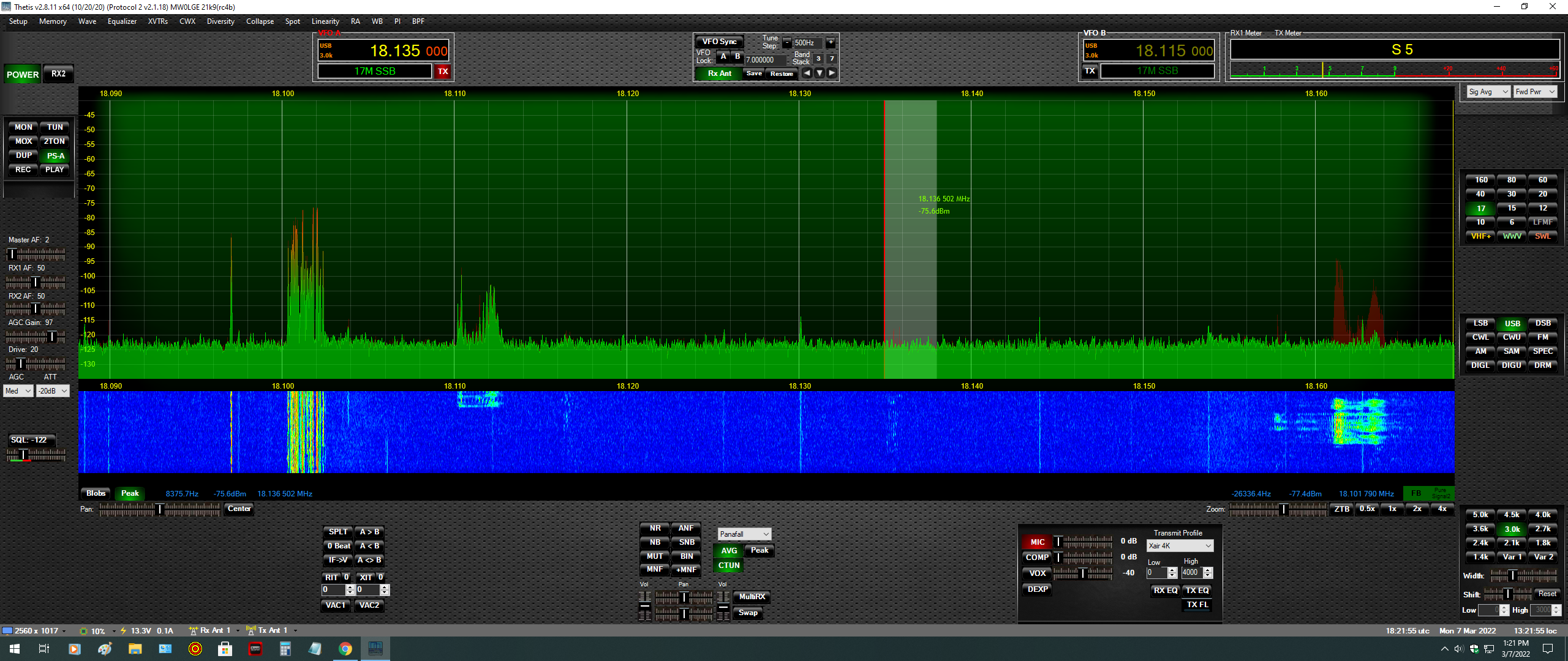

well like things are back to normal I think? any you see wrong??
Thank you so much
Al
73'
screen shot.png (1.54 MiB) Viewed 25805 times
