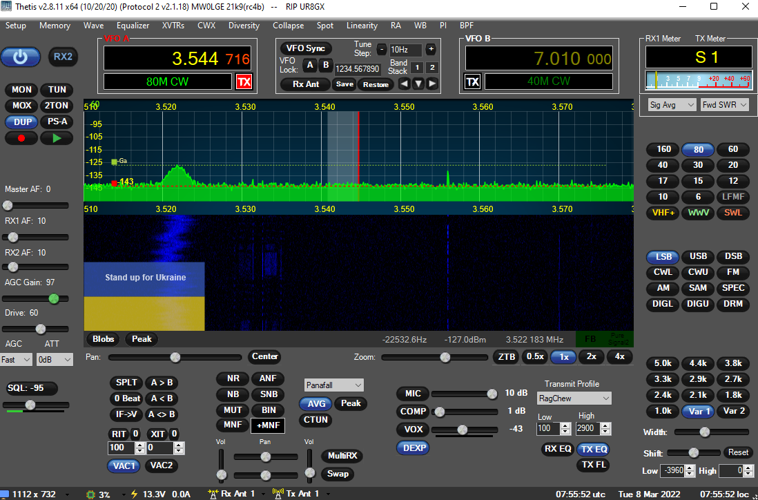

Post by RD4D »
Why is Ukraine flag on my waterfall?
Why does politics intervene in our common hobby?
Posts: 1588
@RD4D It is on mine too, but I have it there to remember and pay tribute to hams like Ivan Lysenko, UR8GX.
https://dxnews.com/forum/forum/silent-k ... on-ukraine

ramdor wrote:@RD4D It is on mine too, but I have it there to remember and pay tribute to hams like Ivan Lysenko, UR8GX.
Thanks for the information. But I do not think it is a good idea. How to remove this flag?
Posts: 1588
RD4D wrote: Thanks for the information. But I do not think it is a good idea. How to remove this flag?
Yes, very sad :( Unfortunately for you in that case, I think it is a good idea, however it is quite possible to remove the flag :
1) do not use your callsign in the software anywhere
2) do not set Russia as the region
3) you should remove any Russian keyboards from your computer and replace with anything else
4) un-install all Russian languages from the operating system
5) use an older version
That should remove the flag, or you could wait a couple of days where it will appear for everyone so you wont feel singled out.

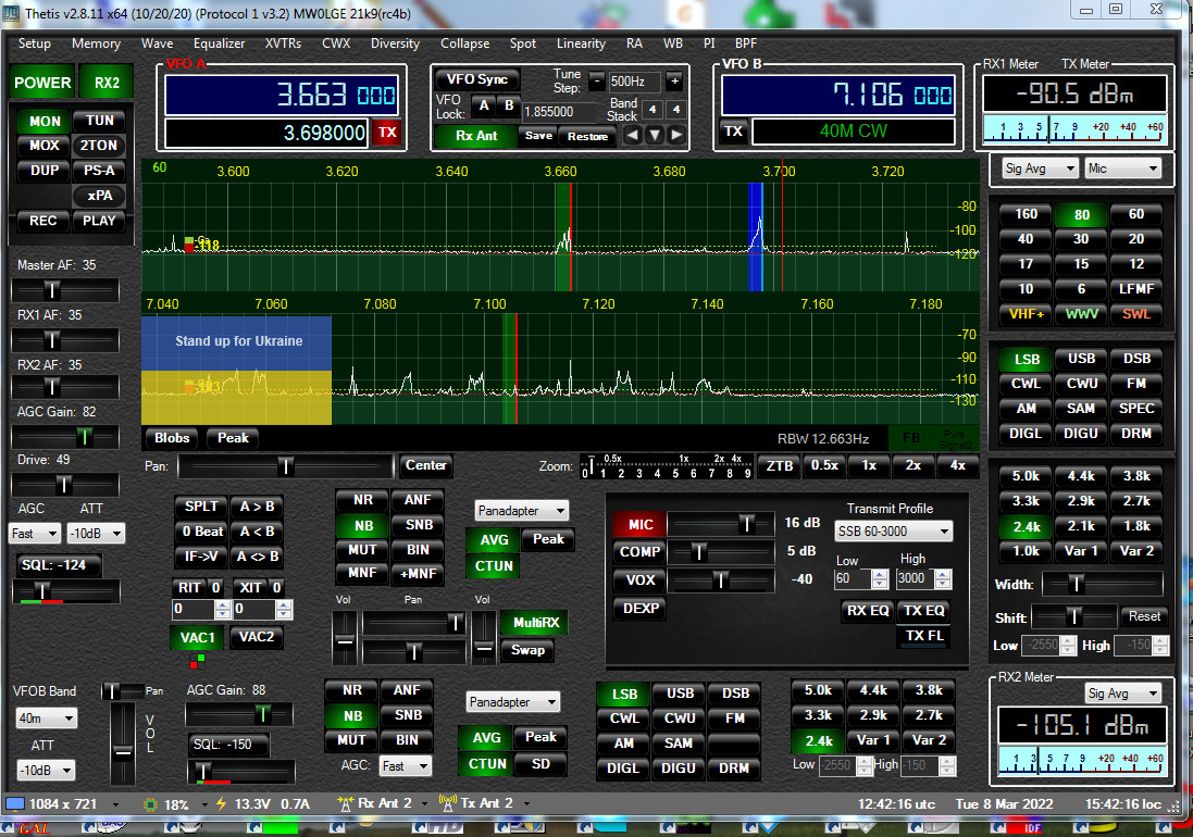

m1tzr wrote: Also the new info bar you say "click the bar to cycle pages" Where is it located, I can't see it for looking?
This is the Info Bar, click anywhere in this area.
Screenshot 2022-03-08 065857.PNG.jpg (58.17 KiB) Viewed 30242 times
Thanks Gary.....
I was looking for a button Dohhhh....
Paul

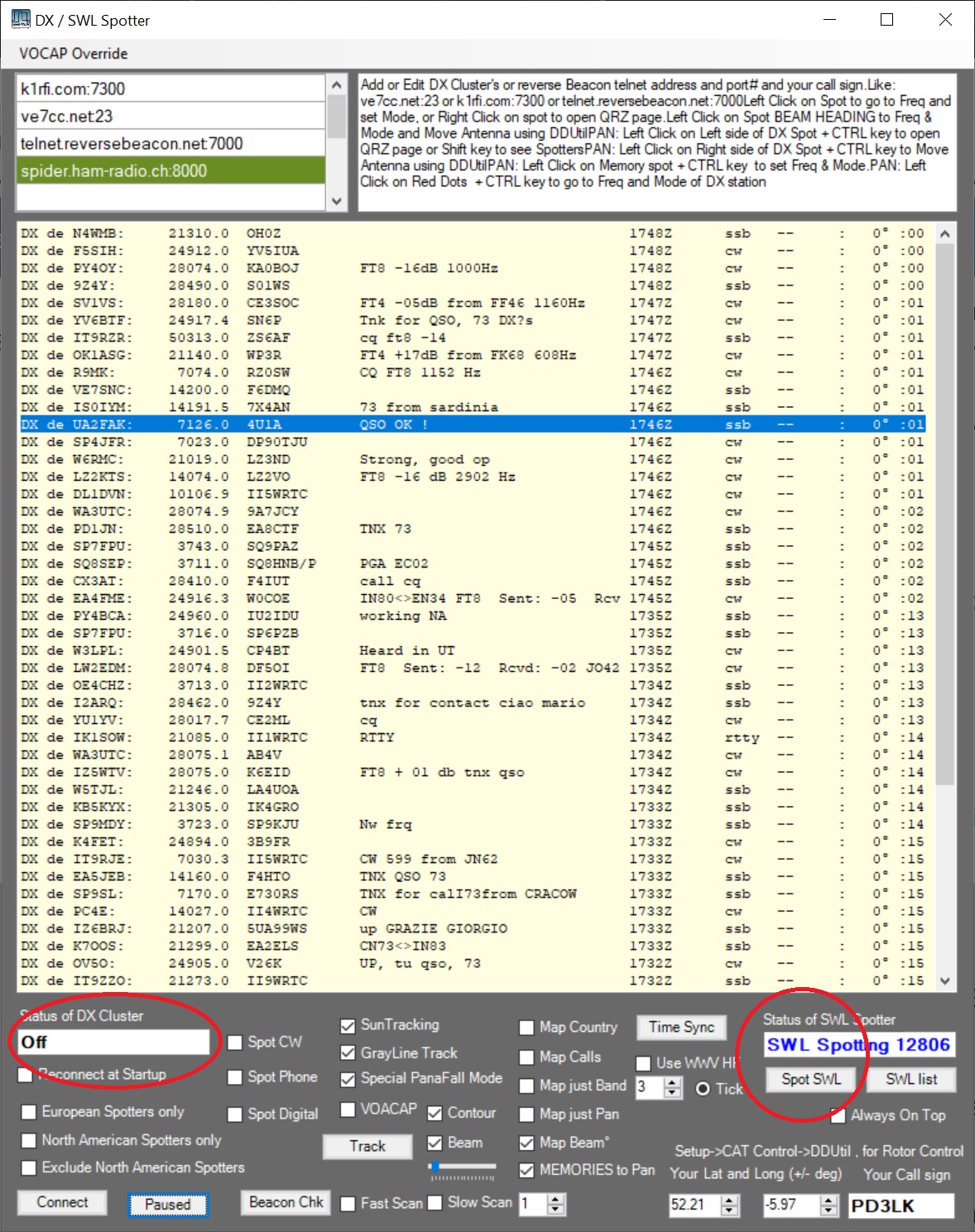

Hi Ritchie, thanks for the latests updates, i have two things about Spotter
1. see pict: when Spotter is not connected it still responds to mouse clicks in the (yellow) list.
When we restart Spotter (not Thetis) with "reconnect on startup" off, then the last list still shows up and responds to mouse clicks.
It would be better if the list would be emptied with mouse clicks disabled in this yellow part.
2. would it be much work to display SWL spots to the FFT when we set "Spot SWL" to on?
regards, Leon
Posts: 1588
@PD3LK Leon
noted, I see it is over on the wish list thread
