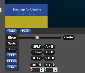

The drop-down button UI is quite innovative and acts to address ever shrinking UI real-estate. However, the mixing of TX audio related controls with spectral display related controls is quite jarring and very counterintuitive. It flies in the face of UI design principles.
Blobs, Info, Spot and Peak correctly belong on spectral display related (located) buttons. CFC, CFCeq, and Lev do not. Tdrive is yet another outlier.
While it is also counter to UI design principles to obfuscate controls behind right clicks or, worse, modifier keys, please consider that it would be better to re-arrange these buttons as follows:
1. Blob, Info, Spot, Peak on a button or buttons located on the status line of the spectral display.
2. CFC, CFCeq (more properly "PostEQ"), Lev could more properly and logically become part of the existing DEXP button.
3. Tdrive could become part of the existing TUN button.
Even better, would be to simply show these buttons outright. The smallest allowable size of a Thetis window is 1018x609 pixels. This makes the smallest screen resolution allowable to be XGA, or 1024x768. Perhaps it is time to require a minimum screen resolution of WXGA, or 1280x720. This would provide ample space for a row of 4 buttons alongside MIC-to-DEXP, as well as 4 separate buttons on the spectral display status line.
I'm sure there must be some person that feels compelled to run on a 10 year old laptop with an XGA display, but even micro-laptops come with WXGA displays these days. It might be time for those folks to upgrade!

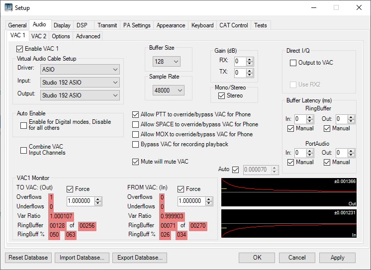

VAC audio A-OK here with RC5. Very few under/overflows with port/ring buffers set to zero and ASIO driver.oe3ide wrote:RC5 running fine here. No problems with VAC or network.

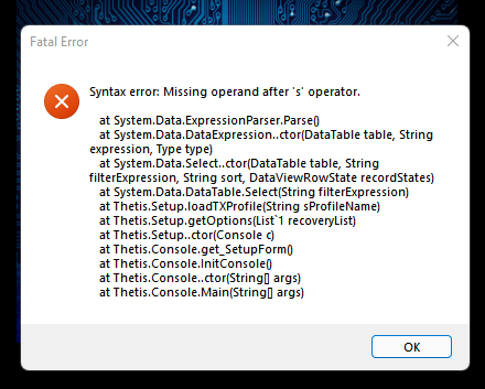

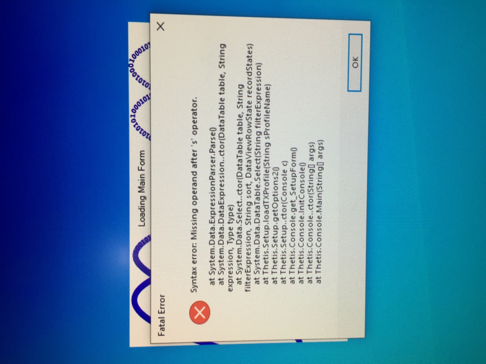

i have a new Anan 7000DLE MKII i7 CPU unit. 5 days old here. Been working ok till yesterday... issue is when I launch Thetis I get this "Fatal Error"...
Not sure what to do, can someone help. I am new to this forum.
Thanks Stan KE5EE
Thanks Stan KE5EE
any idea which version of thetis this is Stan? The official release from 2020?
also, did you name the txprofile something like Stan's Profile ? apostrophe s ? If so, you might have uncovered a bug that has been there for ages.
Seems like that is what has happened.
Please watch this video where I explain how to fix your database : https://youtu.be/OSCNdQeY92o

Hi Richie, it is version 2.8.11
hahaha... now that you mention it Richie, I believe I did rename the tx profile that way. I am not CPU literate hihi.
I will check out your video...

If you are unable to do it Stan, send me your database.xml file and I will repair itStanpix wrote:hahaha... now that you mention it Richie, I believe I did rename the tx profile that way. I am not CPU literate hihi.

Tool to remove apostrophes from database.xml TX profile name fields. It will also append _# on the end of the tx profile name if it it changes any. You can then use thetis to resave them (without an apostrophe) and delete the ones with _# on the end.
Download the zip, expand anywhere, and run the exe.
https://bit.ly/3JatlC7
md5: 94390D86614E92DA0B7FD1BC38C5390B
This issue has been resolved for rc6 which will arrive weekend 19th.
