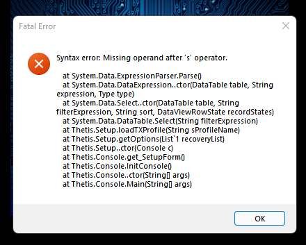

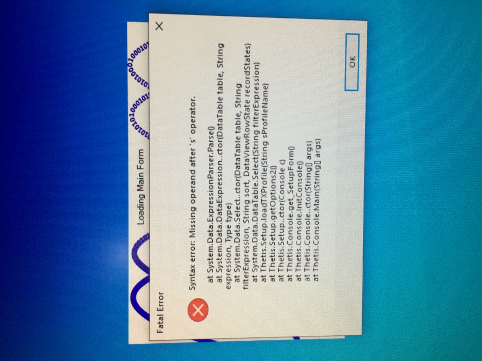

i have a new Anan 7000DLE MKII i7 CPU unit. 5 days old here. Been working ok till yesterday... issue is when I launch Thetis I get this "Fatal Error"...
Not sure what to do, can someone help. I am new to this forum.
Thanks Stan KE5EE
Posted: Sat Mar 12, 2022 11:55 pm
any idea which version of thetis this is Stan? The official release from 2020?
also, did you name the txprofile something like Stan's Profile ? apostrophe s ? If so, you might have uncovered a bug that has been there for ages.
Posted: Sun Mar 13, 2022 12:11 am
Seems like that is what has happened.
Please watch this video where I explain how to fix your database : https://youtu.be/OSCNdQeY92o

Hi Richie, it is version 2.8.11
Posted: Sun Mar 13, 2022 12:53 am
by Stanpix
hahaha... now that you mention it Richie, I believe I did rename the tx profile that way. I am not CPU literate hihi.
I will check out your video...

Posted: Sun Mar 13, 2022 1:00 am
Stanpix wrote:hahaha... now that you mention it Richie, I believe I did rename the tx profile that way. I am not CPU literate hihi.
If you are unable to do it Stan, send me your database.xml file and I will repair it
it is located either in
C:\Users\<you>\AppData\Roaming\OpenHPSDR\Thetis
or
C:\Users\<you>\AppData\Roaming\OpenHPSDR\Thetis-x64
depending if you are using the 32 or 64 bit version. My email is over on qrz if you need it.

Posted: Sun Mar 13, 2022 1:51 am
30 mins or so, and I will have a tool for you to use to repair it
Posted: Sun Mar 13, 2022 2:12 am
Tool to remove apostrophes from database.xml TX profile name fields. It will also append _# on the end of the tx profile name if it it changes any. You can then use thetis to resave them (without an apostrophe) and delete the ones with _# on the end.
Download the zip, expand anywhere, and run the exe.
https://bit.ly/3JatlC7
md5: 94390D86614E92DA0B7FD1BC38C5390B
This issue has been resolved for rc6 which will arrive weekend 19th.
